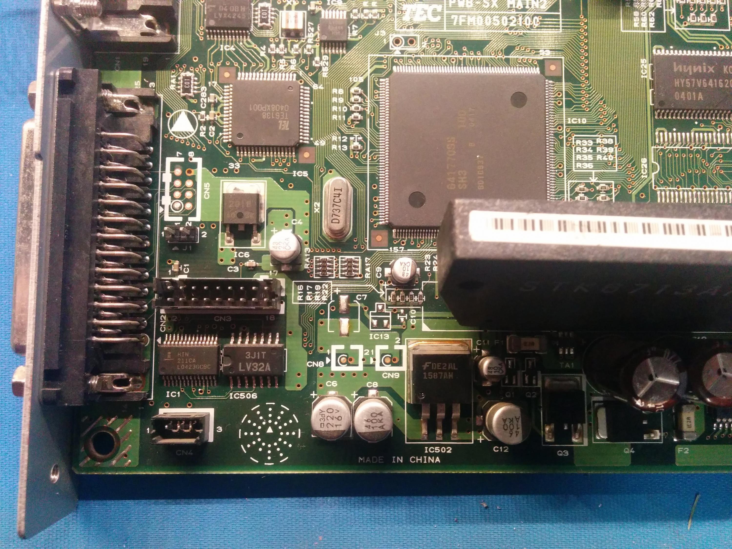

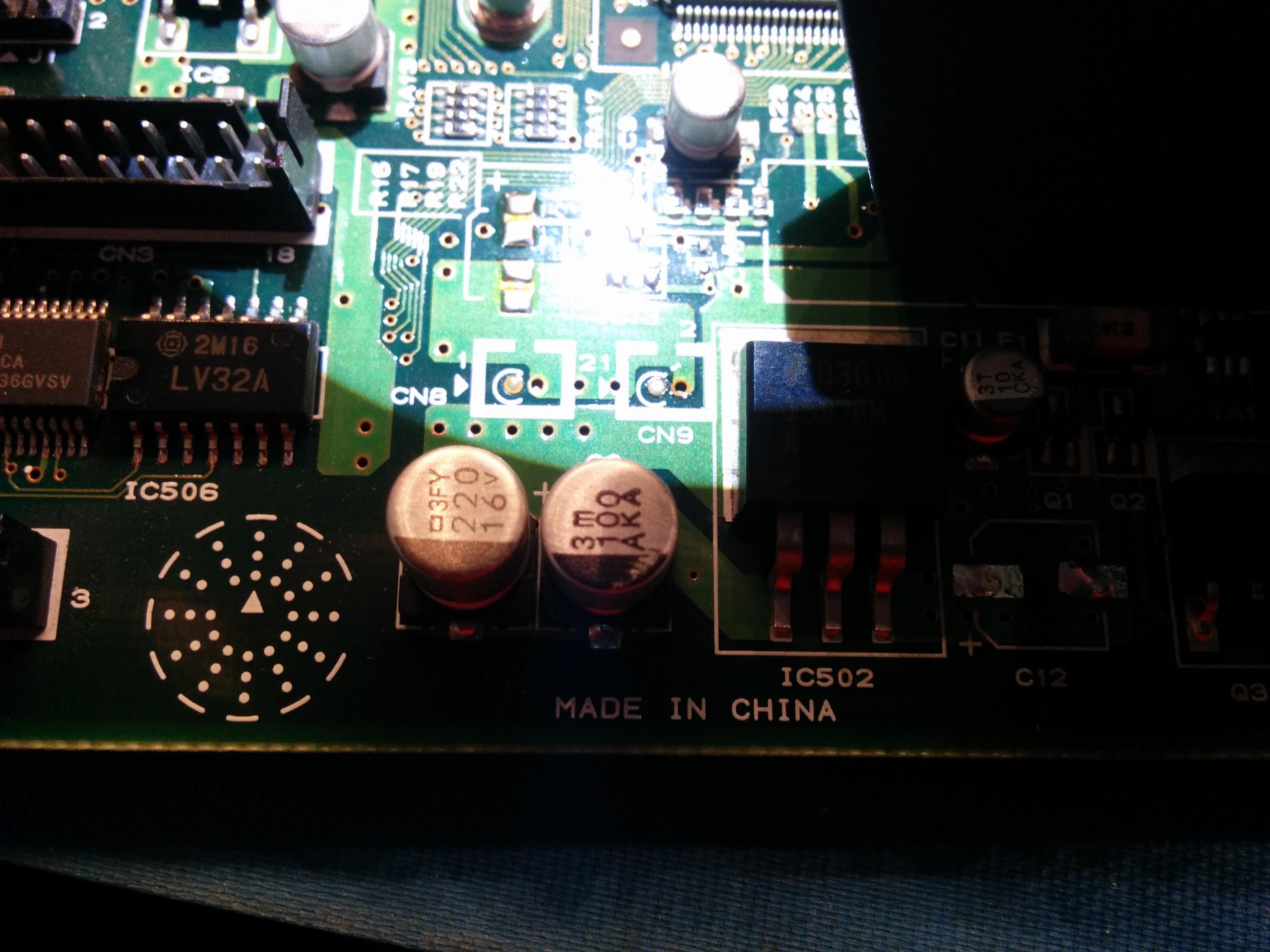

Capacitor value
  • instarep
    • Jul 2014
    • 28
    Capacitor value
    Hi guys, just wondering what is this capacitor value. Picture is not very good so here's what it says textually: ( it's the one on the right side)
    3m
    100
    AKA
  • fzabkar
    • Mar 2009
    • 772
    Re: Capacitor value
    Can you measure the voltage in-circuit?
    • instarep
      • Jul 2014
      • 28
      Re: Capacitor value
      No i Can't but what i can say is that I have an other board like this and on the same position there's different cap's with value:
      100
      46
      this would be 46uf, 100v ???
        Re: Capacitor value
        For that form factor of the SMD cap, the 100 = 10uF. 101 = 100uF, that is how most companies use for marking. The 3m (not the 3M US company) is more likely the company name/symbol.
        Do you have capacitance meter? ESR meter? Is the cap bad?
        Last edited by budm; 11-08-2015, 12:34 PM.
        • fzabkar
          • Mar 2009
          • 772
          Re: Capacitor value
          Can you determine whether the capacitor bypasses a particular supply rail? You could test for continuity with known interface pins or IC power pins.
          • instarep
            • Jul 2014
            • 28
            Re: Capacitor value
            Hi guys, sorry for the delay. I do have a MSR meter but could this help me figure the value of the capacitor? My MSR meter is pretty cheap and only gives me the inside resistor value... Here a picture of the other board, so C8 and C12 are the ones i need to replace on the other board. Would those be 10uf 46v ?
            The cap i need to replace has been accidentally damaged
              Re: Capacitor value
              IC502 is FAN1587 Linear regulator IC
              Those to caps are filter cap, one for the adj pin and one for the input pin.
              It recommend using 100uF electrolytics cap, so 16V~25V cap should be fine (you can measure the Voltage on the input pin, output pin.
              Learn more by looking at the spec sheet attached.
              You can tell what the output Voltage should be by looking at the values of resistor network for setting the output Voltage.
              I would leave the cap at the adj pin alone but I would change the input and the output caps.
              Last edited by budm; 11-14-2015, 05:09 PM.
              • instarep
                • Jul 2014
                • 28
                Re: Capacitor value
                Thank you very much budm, why manufacturer are making it that hard to read their cap value??
                This is a Toshiba barcode printer circuit board.
                Anyway, thank you every one for your replies.
                • MORETTIGIAN
                  Capacitor detached from PCB – RTX 2070 Super Founders Edition
                  by MORETTIGIAN
                  Title:
                  Capacitor detached from PCB – RTX 2070 Super Founders Edition
                  Description:
                  During maintenance on an RTX 2070 SUPER Founders Edition, I found a capacitor lying on my desk after reassembly.
                  I did not notice it detaching, so I am unsure of its original location on the PCB.
                  Procedure performed:
                  - Removed backplate
                  - Cleaned heatsink and PCB with isopropyl alcohol + soft ESD brush
                  - Reapplied thermal compound
                  - Reassembled card
                  Observed behavior after reassembly:
                  - GPU powers on and operates normally under...
                  09-18-2025, 12:14 PM
                • Prolog
                  RTX 3080 FE Identifying capacitor
                  by Prolog
                  Hi people, I hope this is the correct spot to post this, I'm new to the forum.
                  I have an RTX 3080 Founders Edition which has a burnt up capacitor (it was in parallel with another capacitor which appears damaged too), so I am hoping to be able to identify the capacitor values and order replacements.
                  I hope these photos make it clear which component I am referring to:
                  (yes, the soldering is a bit botched from removing the blown one, I know)
                  I have found the board schematic (attached), but there does not seem to be a boardview available. I have never...
                  12-01-2024, 08:27 PM
                • Agent24
                  Dick Smith Q-1760 linear power supply filter capacitor question
                  by Agent24
                  I have acquired a used Dick Smith Q-1760 power supply - although the OEM is Manson Industrial
                  It has at least one problem.
                  The voltage control potentiometer VR2, 50K is faulty - going high resistance / open circuit in the CCW end and leading to the output voltage jumping around.
                  I have already ordered a replacement potentiometer, so that's not an issue.
                  Now, I want to replace all three electrolytics on the PCB as they are CapXon and I don't trust them so much, I will replace them with something better while I've got the thing apart anyway.
                  All are CapXon...
                  10-21-2025, 05:39 PM
                • chth96
                  If I replace with inferior capacitor, Is it No harm to other IC components at all?
                  by chth96
                  I replaced some capacitor which is located on optical pickup pcb which is shown in the table below(PCB #2).Because it have been out of order.
                  Now,It works very well,But I just have found that all caps (6svpc100my and other part number as well) ,which is shown in the table below, has ultra-high ripple current spec.
                  It is not able to obtain any capacitor which can be a substitute for this ultra-high ripple current nichicon capacitor.
                  So I replaced it with samxon and rubycon's general capacitor(GP,YXA series).
                  I know that these capacitor will not last as long as nichicon capacitor...
                  12-22-2023, 04:34 AM
                • chth96
                  How can I test non-polarized capacitor?
                  by chth96
                  I desoldered samwha NF capacitor(50v 5.6uf) from PCB circuit of 29inch CRT TV which have symptoms of no display after I heard sound of inrush of current to TV whenever I switch on this television.
                  I measured ESR value of this non-polarized capacitor(samwha NF capacitor 50v 5.6uf) by means of MESR-100 ESR meter and It displayed 0.3 ohm
                  And When I measured its capacitance with digital multimeter and LCR-T4 Mega328 meter, It displayed 10uf from DMM and 8uf from LCR-T4 meter.
                  I found catalogue of samwha capacitor(samwha-catalogue_3.pdf file), which is attached to this thread,...
                  06-02-2024, 07:31 PM
