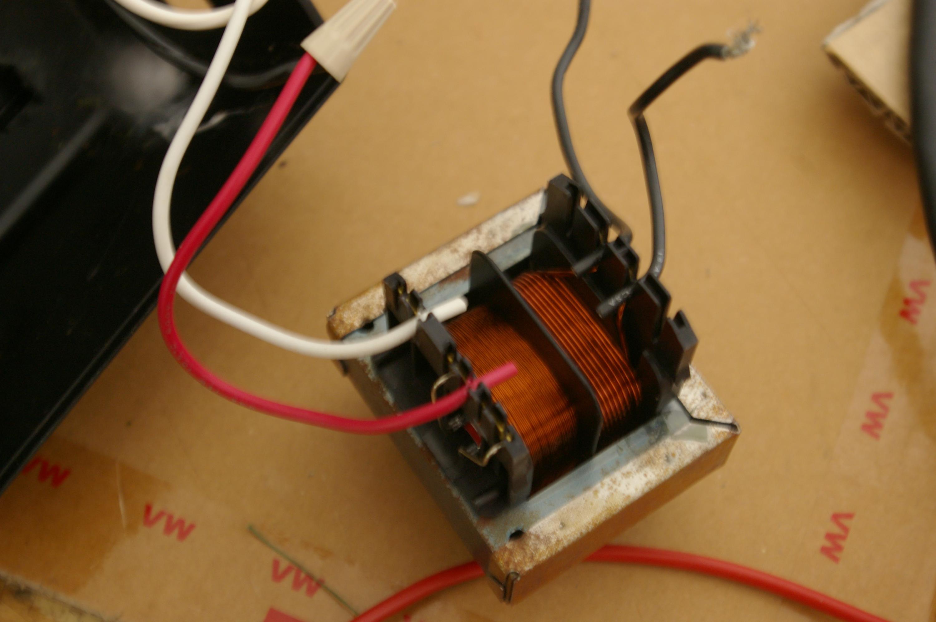

    Another learning venture for me, and admittedly I know little about transformers.
    This is a low voltage lighting transformer I bought off Ebay. Sadly , it failed in less than a few months. It was in a wet location, and the circuit manage to trip and possibly destroy my old GFCI outlet that was wired in with it.
    The transformer is wired with a dusk/dawn switch, but I believe I bypassed that on the bench, and still have zero voltage on the output side. This transformer was previously hooked up to just two LED outdoor lamps.
    Thanks for any help!
    • 31283
    Re: Low voltage lighting transformer? Can/should it be fixed?
    set your meter to resisance.
    then check the output wires,
    the input wires,
    and the thermal fuse.
    (that's the 2 solid wires you see with the red & white)
