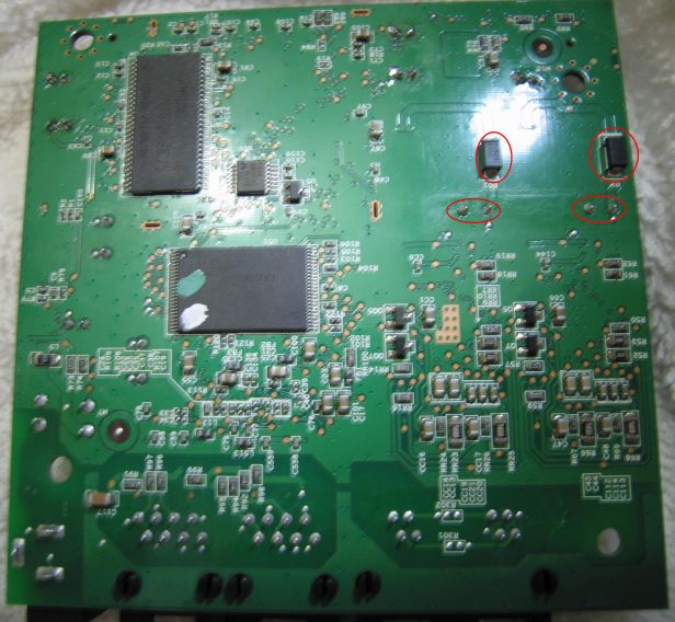

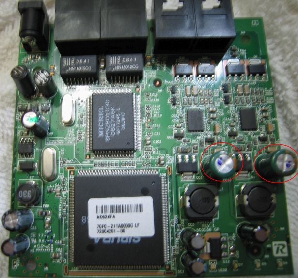

    I have a Linksys SPA2102 I'm re-capping:
    The gist of my question is can I replace the two 100V capacitors with 63V capacitors? I checked their voltages, it's 60V when the phone is on the hook and around 17V when it's off.
    Looking at the datasheet for the chip that is controlling the voltage, the SI3215, it states that it can 'dynamically' assign voltages. The question is, will the voltage go higher than 60V?
    I looked at the design suggestion charts in the datasheet as well, and they're recommending 60V diodes. Indeed the voltage on both diodes were 60V.
    The two capacitors I want to us specifically to replace them are Panasonic FC series, 63V 68uF.
    Oh yea, here are a list of the caps, if anyone is interested. This is for my hardware version with the Sipura chip. I've seen some of them with an ESS chip, the layout is different for those:

      63v capacitors running at 60v is pretty close to maximum rating... then take into account possible variations in line voltage or voltage spikes... They used 100v ones for a reason.

                since a phone ringer is 90v they generate that with the smps too.
                then chop it to 20hz ac.
                if anything go up in voltage.

                    Let me answer my own question:
                    kc8adu, you're right. The ring voltage is indeed 90V, and this probably would have blown those caps right up:
                    Additionally, this page has a good write up about ring voltages:
                    http://www.sandman.com/ringvoltbul.html
                    Modern phones should still be able to handle it if I lower the ringing voltage to around 60.

                      AC with DC offset? I don't know.. but like I said, they didn't use 100v capacitors just for fun. I'm sure they would have saved money and used 63v ones if they could have.

                        worth adding that when the phone-line is "ringing" it can push a lot of current because it was designed to drive a ringer based on a pair of counter-connected solenoids.

                          I intend to use 100V 33uF Nichicon PW, but they're 8x15 mm which should just just barely fit (And not block the top part of the case from being screwed in) if my measuring was correct

                            Is there enough room to lean them over a bit? I've done that many times. You could even bend the legs at 90 degrees and lie them against the board.
