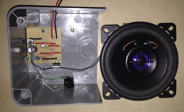

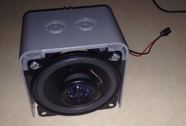

                    Here's a quick look at my handy work. I'm trying to use just a smaller package chip as it's only on a small piece of stripboard. There no max current specified on the stripboard, but I'm sure it's probably good for 2A. Here's how it's looking so far.... (edit: I havent done the mic part of the circuit yet).

                        You need a heatsink on the LM1875T in your pic's, and negative voltage transient protection on power coming in.
                        Cloth acoustic-damping material in the box would help a lot.
