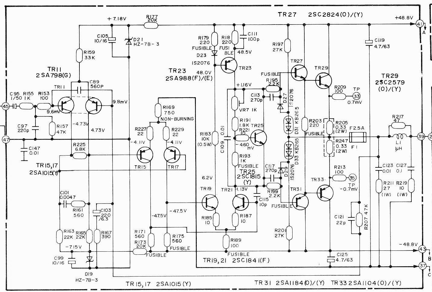

Dual CV-1260 amplifier Component replacement.
  • Benass
    • Oct 2020
    • 73
    • Uk
    I am currently working on the Dual CV-1260 amplifier. Unfortunately, one channel has stopped working. After conducting some troubleshooting, I discovered that D34 is exhibiting an incorrect voltage drop, as opposed to D31, D32, and D33, which have a 1.2V drop. D34, on the other hand, has a 0.6V drop. This leads me to believe that one diode may be open.
    F1 (the fuse) is showing 0.1V, and the channel is working fine. However, F2 (the fuse) is blown and reads -48V.
    In summary, Line 39 has nearly zero voltage and is working normally, while Line 40 has -48V with a blown fuse.
    Now, I'm in the process of searching for a replacement for the KB265 diode. I require assistance from individuals who understand schematics and can recommend alternative components for obsolete parts. Does anyone know if I can use two 1N4148 signal switching diodes in series to achieve a similar voltage drop, or perhaps suggest another alternative?
    https://pdfhost.io/v/66THv3cdo_Dual_CV_1260
    I have Reddit Conversation as alternative.
    https://www.reddit.com/r/AskElectron...eb2x&context=3

    try and match a pair of diodes that track vf the same as a good one . i just measure them whilst warming them in my fingers .
    f1 f2 are speaker fuses . one with high voltage has railed check everything starting with the output transistors .
    there are lots of fuse resistors that might be out of spec .

        "KB265A" or "KB-265" cross is 1N4148 or 1N914.
        "KB265" cross NTE601 Silicon Varistor Temperature Compensating Diode 0.59-0.64V at 1.5mA, and max. 1.1V 10mA, -2.0mV/C at 1.5mA.
        Strange the fact they are an oddball dual diode I think makes you need two in series.
        But in this amplifier, the diodes are for over-current protection of the output transistor and driver - they are not part of the bias or audio signal path.
        So you have a lot of slack with the replacement parts.
        Do not use 1N400x because they are too slow, long recovery time.

          Weirdly diode measured correct once removed, put it back in and it's measuring correctly to other same diode.
          Any ideas why I have -48v on F1 fuse? I can't find anything obvious and not smart enough to understand it.
          Any tips would be appreciated.

            Re: Dual CV-1260 amplifier Component replacement.
            check everything like i said .
            might just be an open or high resistance resistor . could be shorted transistors .

              You'll have to test each and every transistor to figure out what kind of damage there might be.
              I do a first pass in-circuit with a multimeter on diode-test to find the obvious shorts and opens. Or comparison readings with the other channel, if it works.
              The output stuck at -48V usually means the output transistors have failed, likely driver transistors as well. Some shorted, some open.
              A shorted transistor E-B junction would explain the D34 reading lower Vf when in circuit.
              There are many fusible resistors that might have fused and gone open circuit.

                If there is -48V where there is supposed to be 0V is bad. Could be any transistor from the output down to the pre driver or these disable resistors as mentioned above.
                If you can measure each transistor and note down the hfe (gain). Maybe there are some transistors working harder than others. I’ve got a stack of older amps here and the hfe is all over the place.

                  blown fuse suggests that channel was shorted or overdriven . either way its likely to have shorted out at least one transistor and caused resistors to go high ohms .
                  i would firstly remove the output transistors and test them . and leave them out for now even if good . then solder 1k resistors in place of them between where base and emitters go . also replace the fuse ..i just noticed it needs the fuse for feedback so it might just be a blown fuse ..do not connect anything to speaker terminals for now
                      I replaced the fuse. And now voltages gone back to nearly zero.
                      Tested with speakers(carefully) and this faulty channel playing but very quietly,
                      I ramped up volume half way to to hear it.
                      So tomorrow I will have to figure out why its so quiet.
                      Also, I have removed main transistors and used component testers to validate them.

                          I tested them when I was troubleshooting -48v issue.
                          I posted here when I found nothing wrong to begin with.
                          Now all is back as it should but Output is low in one channel. That me having a brain Fart. Used tuner input with AUX connector from my phone.
                          Swiched to DC/AUX channel and its back to normal. Ajusted to zero on test points and both channels playing nice and smoth.
                          So ultimately, no idea why fuse blown, and no idea why doubble diode was showing 0.6 and gone back to normal 1.2 after delordering.
                          Ultimate high in repairs.
                          thanks eveyone for tips and suggestions.

                            I missed that they included the fuse in the feedback loop. Douglas Self talks about "fuse distortion" on bass due to the element heating/cooling during low frequency.
                            You'd have to narrow down what section is low volume - pre-amp, power amp, tone controls etc. Or do you know it's the right ch pwr amp?
                            This amplifier's age, I would recap it, only 6 caps per channel on the power amps. It wouldn't cause them to go quiet though.

                                        So final update.
                                        Tested on reasonable system with good speakers, all is good and work.
                                        thanks again everyone.
