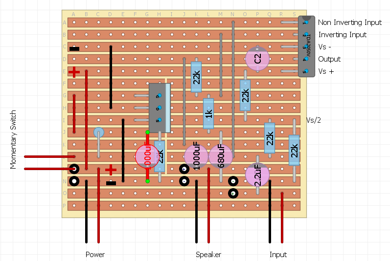

          This is the circuit that I am playing with at the moment. The left side of the circuit is for a RC circuit + momentary switch, so I can hit the button and the speaker stays on for a few minutes (while I'm in the shower) then switches itself off automatically. I'm building it on stripboard, cos I'm poor and dont have any proper PCB tools :-)
          The second after posting this I spotted a few mistakes, but I'll correct them later ...
            Also, cut traces so that none of the speaker or power traces are going near the input traces (as best as possible). That will help reduce any unintended noise/feedback.
            Like (L,A), (L,B), (N,K), (N,M), (N,N), (N,O) ... etc...
            Especially (L,B), this will decrease the coupling from the GND to the inverting input.
            Point format: (Column/X, Row/Y) The strips on the board are the rows. Just saying, 'cause I don't want any confusion :P
            Next, connect the input ground to the VS- of the amp chip, directly. The way you have it here, you have a ground loop! Basically, higher currents - compared to the current of the input signal - will cause voltage drops across the GND wire, which basically will feed back into the input signal.
            This can cause distortion and even oscillation (worst case). That might be the source of your poor sound quality. I'd be surprised if the TDA2050 worked well with it like that!
            Also, that 680uF capacitor on the feedback, shouldn't that be more like 10uF to 22uF?
            You might want to add a capacitor to the 2x 22K resistor divider, to keep it more stable. The LM1875 datasheet shows a 10uF. Of course you don't have to follow the datasheet, but it isn't a bad idea to at least try.
            I personally would use a comparator with some hysteresis for the timer, but that's my way of doing things :P
            That may be another reason for bad sound quality, if the FET doesn't turn off cleanly, then it will have a high voltage drop across it, and the voltage at the amp will be less, which could lead to distortion at higher signal levels.
            I'm surprised how it stays on for a few minutes using only the gate capacitance of the FET!
            Also, the reference board diagram in the LM1875 datasheet is really messed up. The components are out of alignment with the board. They didn't do quite as good of a job of eliminating ground loops as I would like ... weird.
            -Ben
                I see what you're saying about the ground loop. The chips only path to ground is through the FET, and there will be a slight voltage drop, so that the grounds of the chip and the grounds of the input/output will be at slightly different voltages. But because I'm switching on/off the ground side of the circuit I cant connect the battery ground to pin 3 of the amplifier chip as this will make the RC switch redundant. Maybe I should switch the positive side?
                Also with regard to the interference between outputs/inputs/power, I was trying to fit the circuit on a very small space, but this is clearly to the detriment of the operation.
                I personally would use a comparator with some hysteresis for the timer, but that's my way of doing things :P That may be another reason for bad sound quality, if the FET doesn't turn off cleanly, then it will have a high voltage drop across it, and the voltage at the amp will be less, which could lead to distortion at higher signal levels.
                The circuit does get noisy as the RC circuit (triggering the FET) voltage goes lower. It's not something that annoys me, but was an optimization I was gonna work on.
                I'm struggling a little with the software, but here's the circuit with a few corrections.

                  Re: Replacement for TDA2050v
                  How does VS- get to the circuit GND? I see it goes to the Center pin of the 3-pin connector. What is the 3-pin connector for?
                    Hi Bud, I want it so that when I push a button the amp stays on for only a short period of time, then auto shuts off. So I'm using the FET, with an RC timer at it's gate, to control the path to ground...
                    I got this idea from an Everyday Practical Electronics (magazine) timer which they used as an auto shut off for a cheap multimeter. But switching the ground might not work so well for an audio circuit.
                      #30
                      I see, so you use the Power MOSFET as the low side switch to sink the load.
