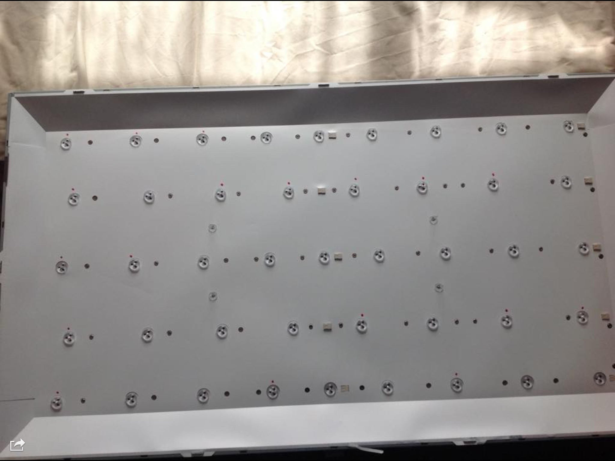

      I have a 40" toshiba in now 16months old and almost every led backlight has failed. It seems that these types of bulbs always crack in the middle when they fail, what a helpless pos
      Picture showing the backlight array, bulbs with red dots above have failed.
        Yeah, seeing a lot of those types fail. What was that about LED TV backlights being more reliable? LOL. Seems the CCFLs are, oddly, more reliable because being passive devices they rarely fail until wear-out.
        A lifespan of 40,000 hours (to 1/2 brightness) for a CCFL backlight, with maybe 0.1% early failure of bulbs.
        vs a lifespan of 100,000 hours (to 1/2 brightness) for an LED backlight, but at a 5% early failure rate.
        Hmm, which wins? Oddly, CCFL will probably last longer on average!

          the led's are almost certainly being overdriven.
          a friend has converted backlit tv's using the 12v strips on a 5m roll without them failing - ironic that diy is more reliable!!!
            Yeah, either that, or they have bad thermal engineering, or both.

              All my customers I advise to go with plasma or an older lcd that will be ccfl, seen too many failed leds absolute junk, and argos wont refund the customer when they fail
