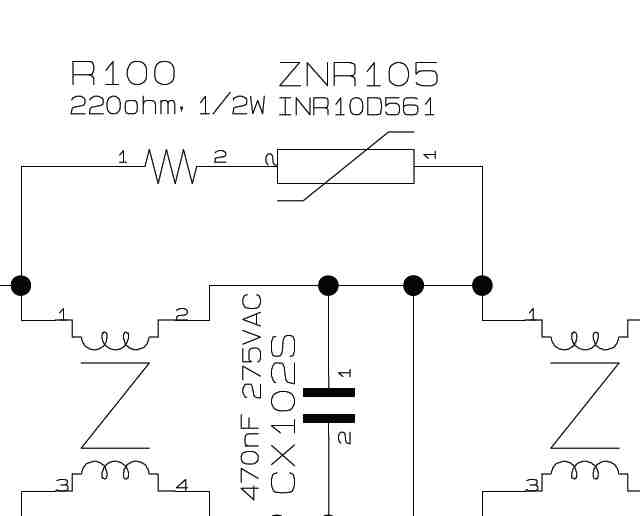

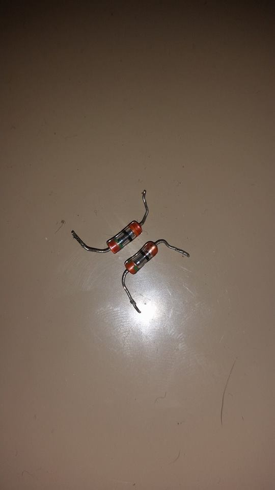

    Hi there can someone identify these two components please they are from a tv powerboard lj44-00092c ,on the schematic they are labelled as (ZNR-105)INR-10D651 .and the other is labelled as (ZNR-106) INR-10D651.
    i have tried to google this but came up with nothing.
    thank you.

    I think you have mixed up the parts. In the pictures attached you might have two zenner diodes, but the part no indicated on the boards (ZNR105/106) are for two varistors. Attached you can find the part code for INR10D561, wich is a varistor, 10 mm diameter, disk type, 560V .

      ZNR would mean to me it is a zener diode.This site tells you how to read zener diode codes http://www.noahtec.com/zener-diode-code.htm and you can email this guy if you have something different jestineyong@noahtec.com I do not know why these companies make it so difficult to tell what type of part it is. One would think they would want to sell them therefore they would make it easier to id.

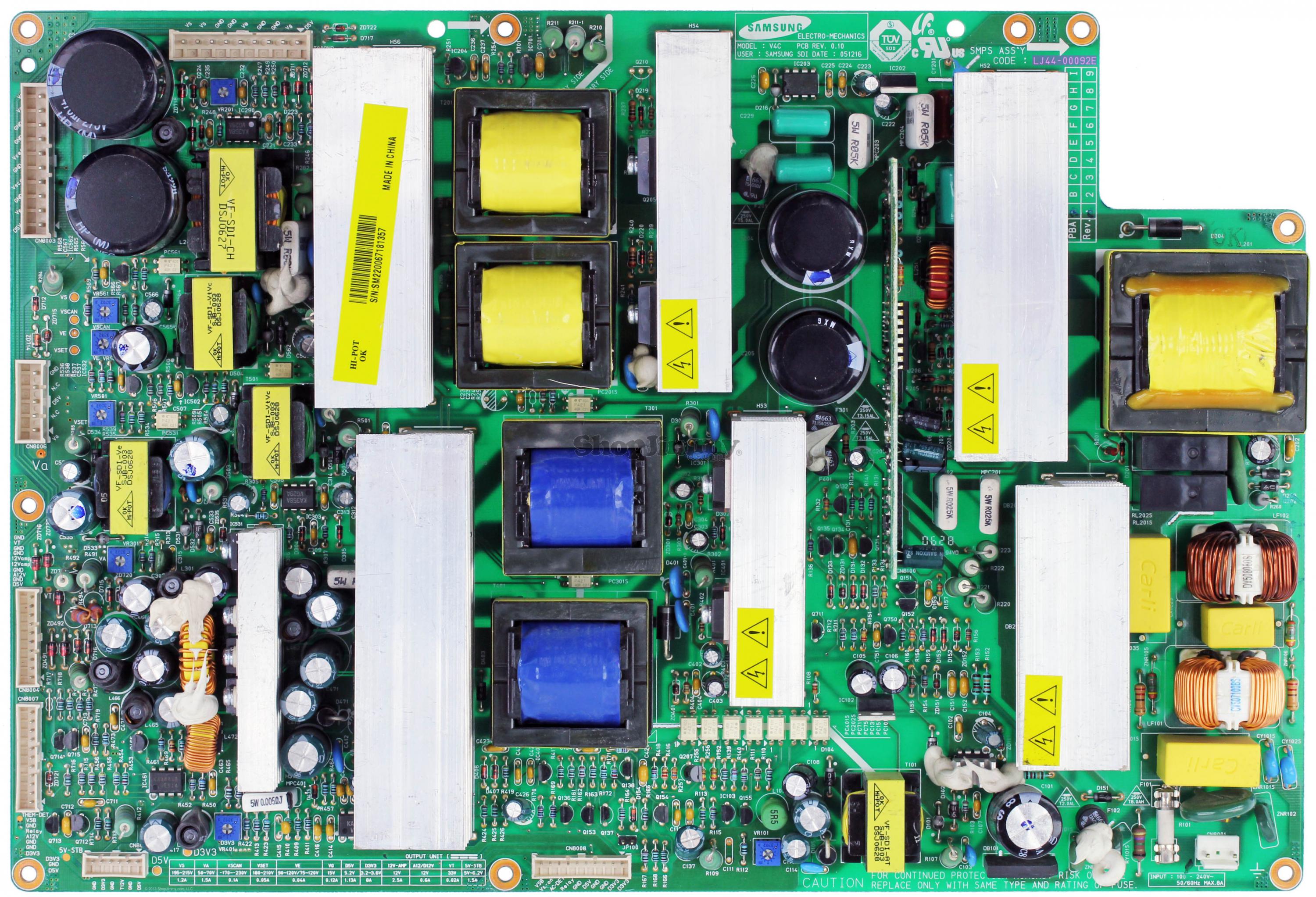

            A photo, these are from those locations stated, you can see in photo lower right side
            Interesting situation
              Re: identinfy this component please
              Gas discharge surge protector.
              What is the board not doing?
              The board does not need them to function.
                  thanks budm
                  i thought these were some sort of zener when i put meter across them it was showing open both ways so i pulled them from board.
                  the problem with the board was that it was completely dead,
                  i guess i will re-solder them back in the board ,do these have polarity or can they be soldered in either way.
                  thank you.

                    On photo from 1 post - surge absorbers http://huaan-china.en.alibaba.com/pr...Absorbers.html

                      Interesting I learned something. So, when you get an over voltage these ionize and conduct protecting the the circuit?
                      • SMD63
                        • Oct 2014
                        • France
                        Keeney123.
                        You can solder in either way.
