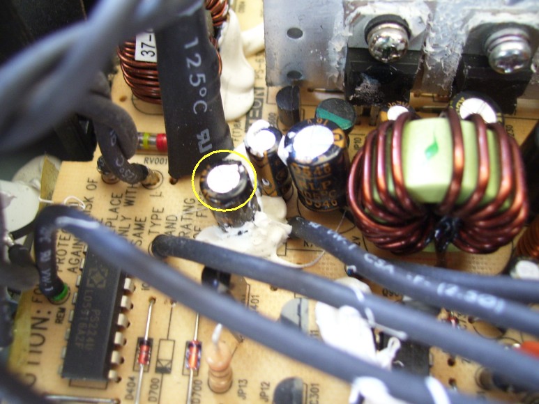

                  Re: Capacitor replacement - Lead spacings
                  i checked the wrong one
                  the aforementioned capacitor is circled in yellow, in the thumbnail below
                  and i'm not at the stage where i'm ready to remove the board, so hopefully someone will be able to make an educated guess, as to which capacitor i should order
                  i.e.,
                  if [PW 100uf 25v (0.025/0.50)Imp (290mA)Ripple] would be close enough
                  and if the [KZE 100uf 25v (0.013/0.41)Imp (405mA)Ripple] impedance would be too low
                    if it is not on one of the outputs, is it ok to use a cap with an impedance a bit higher than the original?
                    0.025/0.50 to replace 0.023/0.46?
                      I wouldn't, but that's just me. It's close enough that it should be OK, but I would trace out the board and check to be sure.
                      Lead holes are often not the exact spacing for capacitors, especially sub-8mm diameter ones.
                                      Wow!, looks like you are correct.
                                      I was looking the wrong cap again! (which you probably already knew)
                                      I traced it out
                                      One side goes to Earth,
                                      Using the convention: IC pins are numbered anti-clockwise around the IC starting near the notch or dot,
                                      The other side of the cap goes to pin 15 (of a 16 pin IC) with PS224U L05916A2F written on it. (Which lines up with the pin description of Vcc power supply)
                                      This is the function of the chip: "Over voltage protection, over current protection, under voltage protection, and power good signal generating"
                                      The datasheet says Vcc can be up to 16V so i can see why the cap is rated 25V
                                      Typical voltage is 5v, and typical current is 4.5mA - so the typical power supply is 0.1W
                                      What now?
                                      Will this Nichicon PW, with a slightly higher ESR, be acceptable to power this chip?
                                      It's low power, so it seems as if overheating won't be a problem.
                                        "What now?
                                        It's low power, so it seems as if overheating won't be a problem." That is correct so the PW will be just fine.
