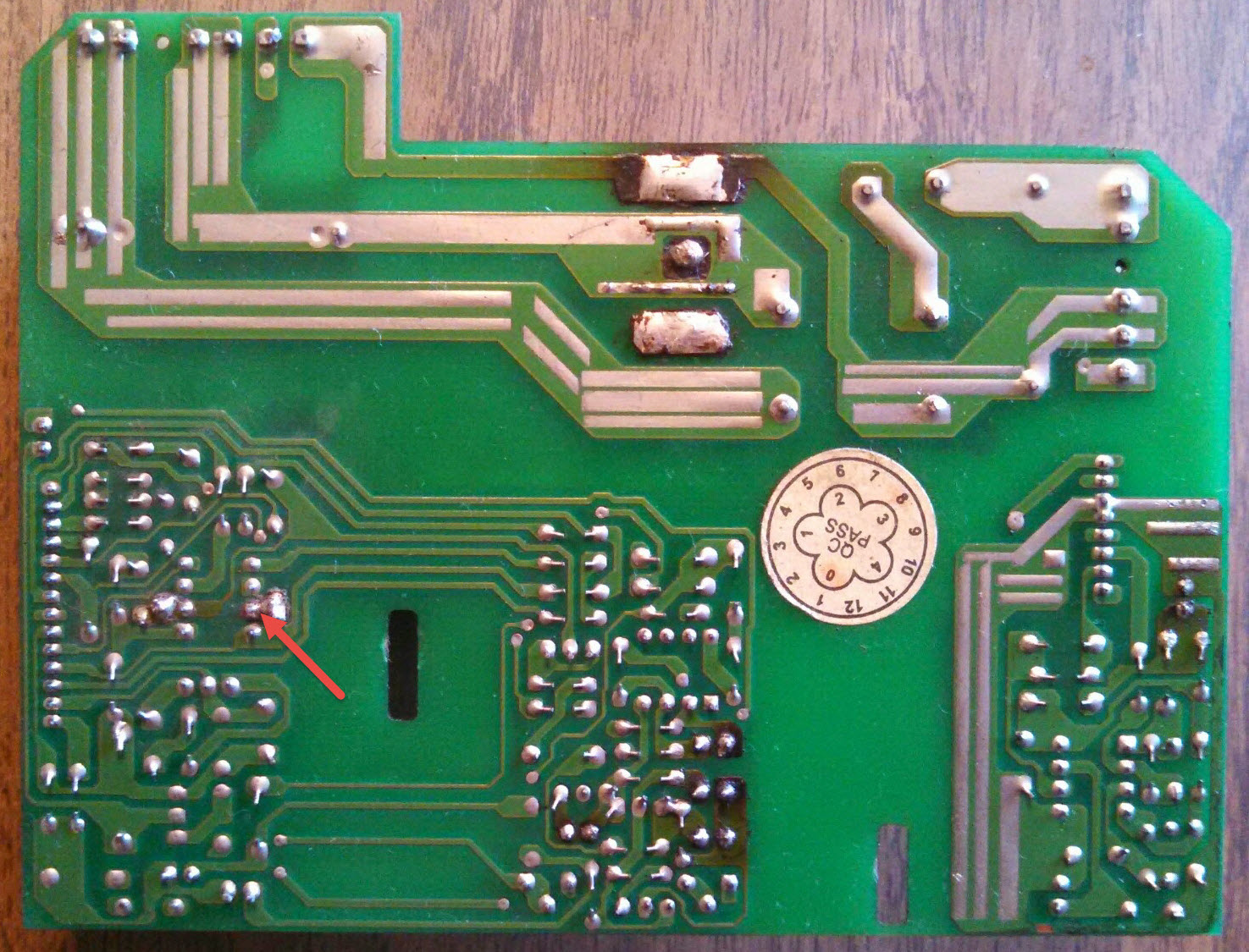

    Solder Pad lifted
    I have a question, I was desoldering a capacitor and the entire copper piece which is the only thing in that solder mask lifted off the board, how do I fix this? I don't have a current picture but basically the copper piece came off the board, can one just glue it back with super glue like when I googled the subject or does it need to be conductive on the other side as well. It seems like this one is not part of the copper trace except it's a isolated piece that is the same size as the solder pad.

    undoubtedly a double sided pcb so the connection that counts is the top. That's what you need to make sure the solder flows to . I've done this, does not take much heat to lift those. I have used 5 min epoxy just to get the pad back which helps to secure the cap when it's soldered there, probably protect the top pad being torn if one was to apply pressure to the cap by mistake, otherwise won't matter

            There is usually a metal sleeve or ferrule lining the hole connecting the top run to the bottom copper run. This allows for capillary action to spread the solder throughout the hole top and bottom. The rule for soldering is 5 seconds of heat. If it doesn't solder properly in 5 seconds you haven't prepped it good enough and need to regroup and try another way.
            Leaving the pencil on too long melts the glue holding the copper run and then any physical movement pulls it up from the board. To fix it make sure the metal ferrule is still in the hole and is still good where it connects to the run under the cap. Some boards have runs between two layers of board. They actually have three ways for copper to run. You have to ensure conductivity with that run as well when your done on those.
            Cut the lifted run back to where it's still solid with the board. Scrape it clean of any coating. Put your cap in the hole and put some flux on it, liquid is best, and heat it, apply solder. If it's sucked in the hole, you know it's making it to the upper contact pad.
            After that, wrap a cut off lead from the other side of the cap around the lead in question. Run it over to the run you cut and solder at both ends, cut the remaining lead and you should be ready to go.

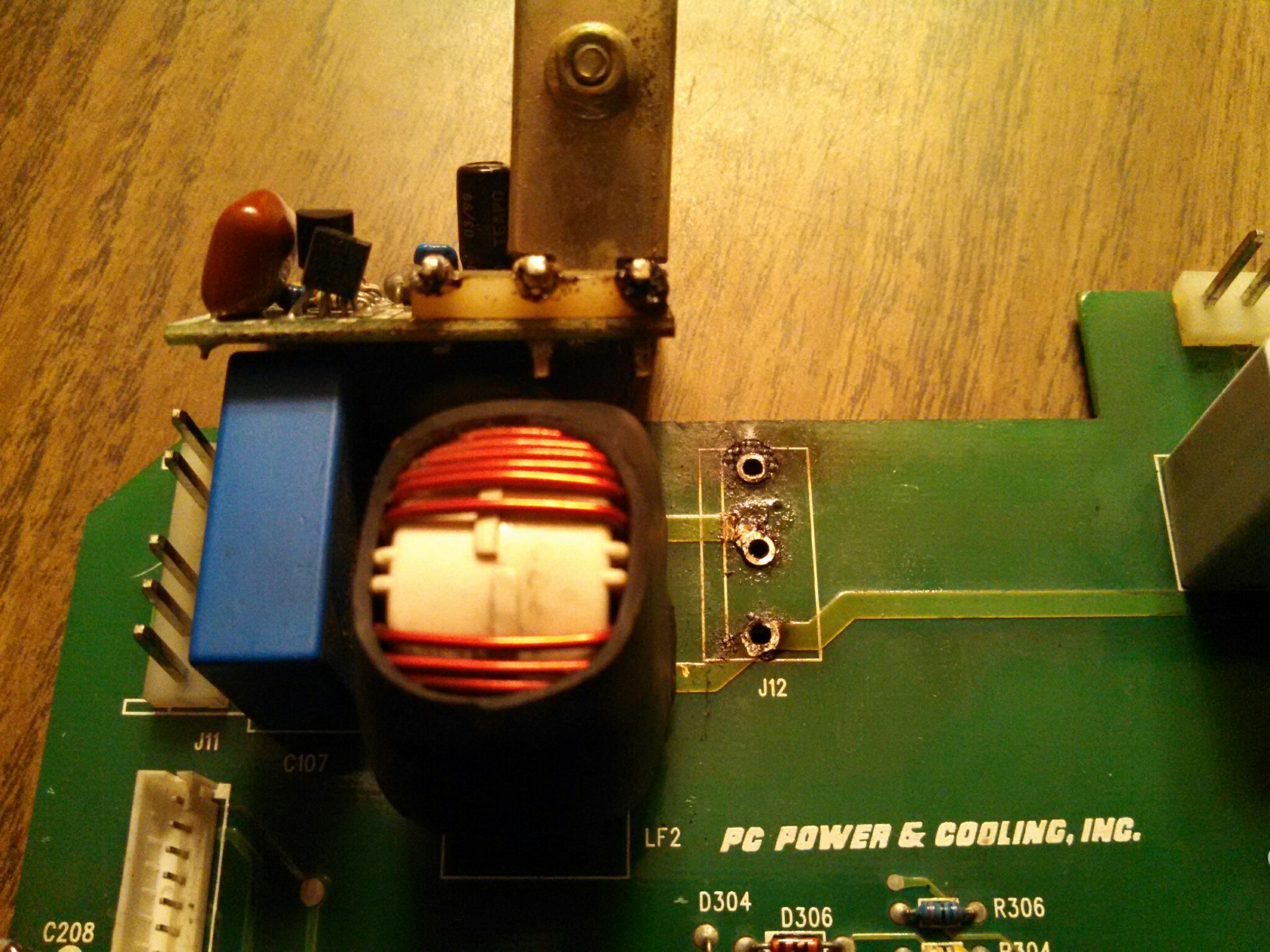

                    That's a tricky one. Because it's plated through-hole, a one-shot desoldering pump or wick won't clear the hole easily (if at all)
                    You really need a vacuum desoldering tool, but the pins look large so finding a tip that fits could be a challenge.
                    Another way would be to find a way to heat all the pins at once, either with a hot air rework tool and appropriately shaped nozzle or selective reflow soldering machine (Lots of $$$) - the cheapest solution may be just a really big iron so you can heat all the pins at once and then pull. Clean up with wick or one-shot tool.
                    I personally would probably have tried to make room to work on the board by removing the coil and capacitor behind the board instead, as they would likely be easier to deal with (Round leads typically desolder easier than square, too, especially if they are quite tight in the hole)

                      Honestly, wick would probably be best for that job. I just removed three boards like that from the main board of a cassette deck from 1985. I sucked up as much as I could on the bottom of the board , let it cool, sucked up as much as I could get from the top. Wiggle, pull, wiggle. Try to suck up a bit more and eventually it comes out. Then you clean it up with more wick. I use liberal amounts of flux it helps spread the heat. The wick also acts as a heat sink so it gives you a touch more time before damage is done.
                      From your pictures Your board is only connected electrically to one side of the board anyway. The top one is connected to the bottom of the board only. The other two are only electrically connected to the component side of the board. The missing pads are only for assuring the physical connection of the two boards.
                      I'd say just solder what you can and let it go. Those lifted pads aren't really necessary anyway. They take the place of glue on large capacitors.
                      Yeah, that burnt up square pad was electrically not connected so not really important. Just solder what's left and make sure it's physically secure and let it go. I mean make sure it's not very wobbly.

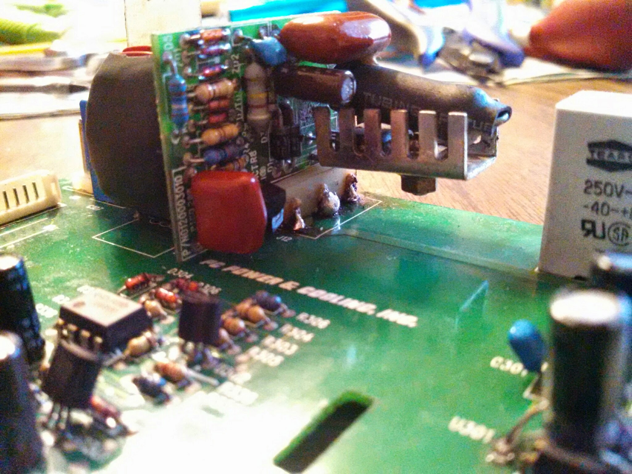

                        @Agent24,
                        I wonder what kind of material did they use for the middle plate because it seems like that material melts pretty easily compared to the other pads. It wasn't hard clearing the hole since it was a large size, it's the smaller holes for capacitors that seems harder to clear as those, the only way to get the solder inside the hole to melt is to actually have the tip inside the hole.
                        How do you heat all the pins at once with a big iron since the tip will only be able to touch one pin at a time as you can't lay the iron flat without doing major damage to the board. I know that a hot air rework tool would work but I can only work with the equipment I already have since I only solder once in a blue moon and getting a hot air rework tool just for this fix of my own PSU is not going to be cost effective. The way I even successfully desoldered the thing was using a wide chisel tip.
                        I was thinking about removing the coil except it seems that one has 4 legs which are all far apart from each other, not to mention there is also the yellow glue holding it down and getting to the glue seems to be even more work than taking out 3 pins. The metal sleeves slide off the square pins on it's own when I heat the pins above the metal sleeves, same thing with soldering the mini-board back, it seems like the metal sleeves would slide off onto the pins from the board until I had the sleeves on the bottom and heated the pins above the metal sleeves. I was using lots of rosin flux but it didn't really help, maybe because the solder is old or something.

                        As for the way the three pins are connected, it goes like this after I looked at it carefully to do the continuance test using the Digital Multi-Meter:
                        Top pin is connected to a trace on the back of the board that goes to the 1st pin of the J7 connector and then on the other side of the trace, it goes to the coil, the blue rectangle capacitor and also the last 3 pins of J11.
                        Middle Pin is connected to the coil on one end, then the other end of the trace goes to the white rectangle capacitor at C102 before going to pins 3 and 4 of connector J7.
                        The last Pin is not connected at all on the back side and the trace is on the other side with one end going under the coil and under blue rectangle capacitor C107 and connects to pins 4 and 5 of connector J11 while the other end goes under the white rectangle capacitor C102 before ending up at pin 2 on connector J7.

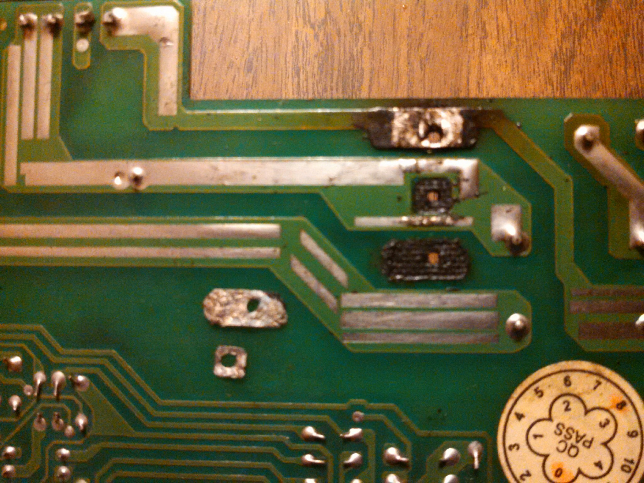

                        As for the burnt up square pad, are those supposed to be made out of copper since I thought it wouldn't have melt that easily but I basically did another fix by melting some 60/40 solder at 218C so that it is larger than the hole just to make the pin physically secure and made sure it passed continuity.

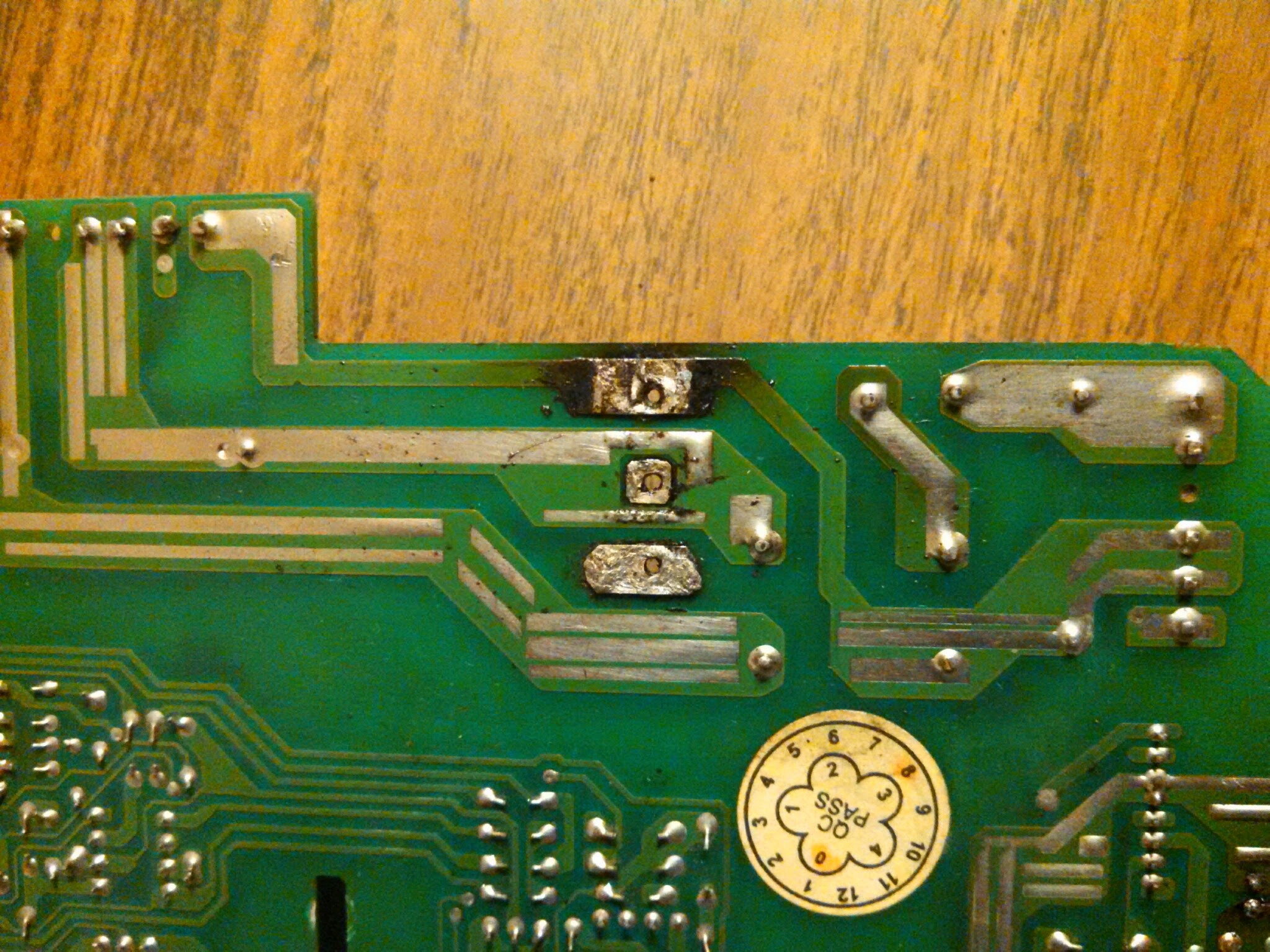

                            That middle one is smaller than the bottom one, it's not connected to anything so will heat faster. It's made of the same material as the others.
                            Are you using a soldering pencil or a gun. You should be using a 30 to 35 watt pencil with a small tip. If your careful, you could get a small tip in there and not damage the plastic. I've had to work in tighter spaces before. It takes practice.
                            From what I'm seeing that spot the arrow is pointing at looks okay. Not very elegant but functional.
                            To clean the old flux, I use acetone. Use it only in a well ventilated area, don't get it on your skin unnecessarily. A little won't hurt, just don't wash your hands in it. Women use it to remove their finger nail polish so it's not instantly lethal.

                              Agent24, I guess when you meant big, you meant both physically big and high in wattage big too. LOL.
                              rhomanski:
                              This is what I am using:
                              http://www.gotronik.pl/stacja-lutown...cmc-p-549.html
                              For the back side where the joints are, I used the 3.0mm wide tip as the 0.3mm tip didn't work at all. For the other side, I used the 0.3mm tip. You're right it takes practice and being extremely careful.
                              As for acetone, wouldn't that melt the PCB as well? I've used 100% acetone fingernail polish remover before to clean the top of the CPU for new thermal interface material so its pretty safe except I know it can strip off paint and melt plastic even a little.
                              The pencil with the bar welded at the tip sounds like it would work which is similar to hot those hot air stations work except I do wonder with the hot air stations, wouldn't it cause a bad joint in the components you're not repairing?
                              As for the PSU, it's a PC Power & Cooling Turbo-Cool 450ATX from 2000/2001 and after replacing all the caps, it is working fine. Not sure if it's the -5VDC or not, but somehow at the same 100% load which is probably due to the caps on the motherboard, the PCP&C PSU seems to allow the mouse to move while with the replacement Corsair CX750m I was using for the past month, that one was like really lagging as the mouse was non-responsive, maybe the PCP&C just delivered better current to the motherboard or something. The motherboard is being recapped now.

                                I meant physically big mostly, that iron I linked to would surely destroy boards if used as-is. Why I suggested running something like that through a dimmer or such to keep the temperature in check to the standard 350 degrees C or thereabouts.
