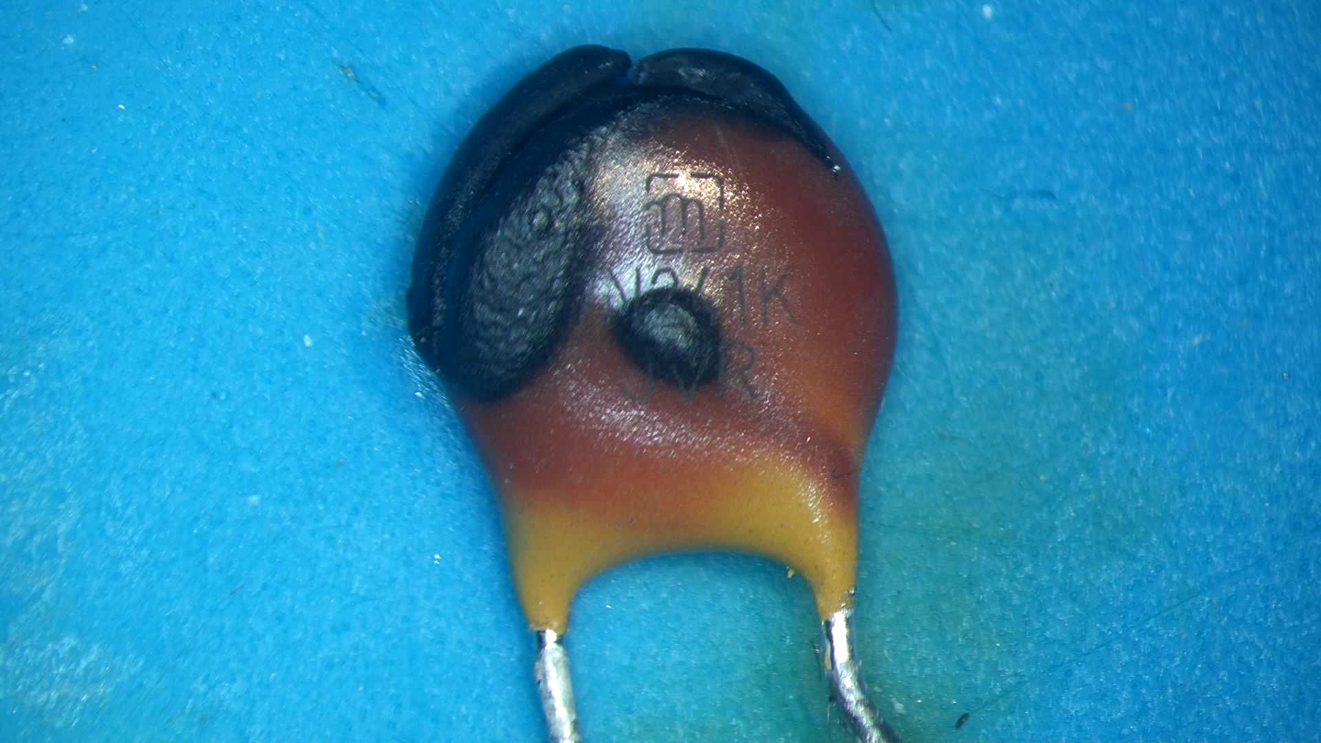

Need help verifying this MOV
    Just need some help to confirm what this mov is. So far all I can make out is N241K & JVR. I'm not familiar with these but hoping someone is.

    There would be a number (diameter) prior to the N241K IE: 10N241K (10mm)
    The N series are High temperature series, D series are Standard series 10D241k which should work and are easier to find
    Page 13 of the 10N-series pdf explains the difference between the series letters

      Thank you for that info. Can you tell me how critical the frequency is? I found a few but the listed frequency doesn't match the chart.

        That depends on in what circuit / device you replacing the MOV.
