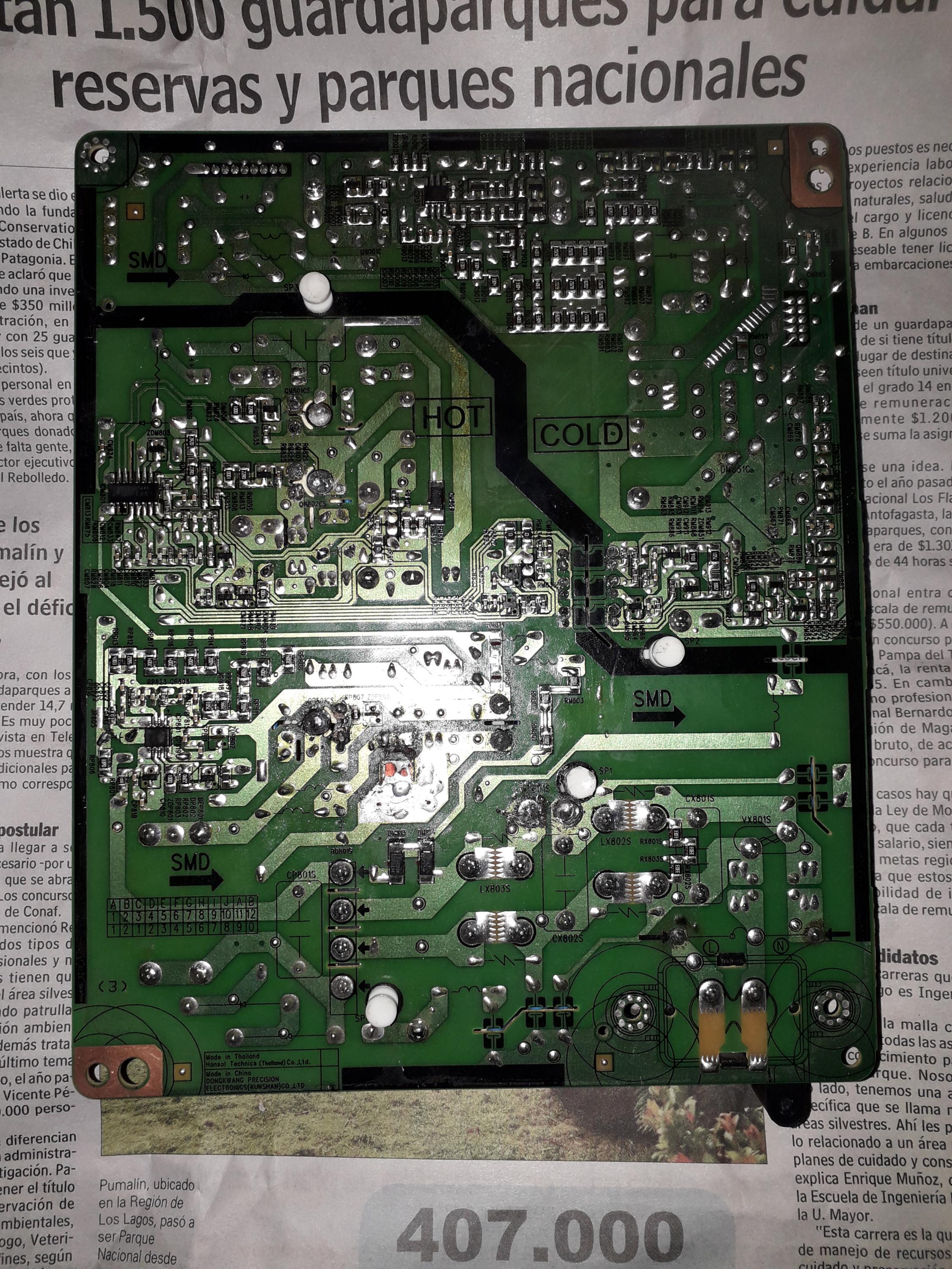

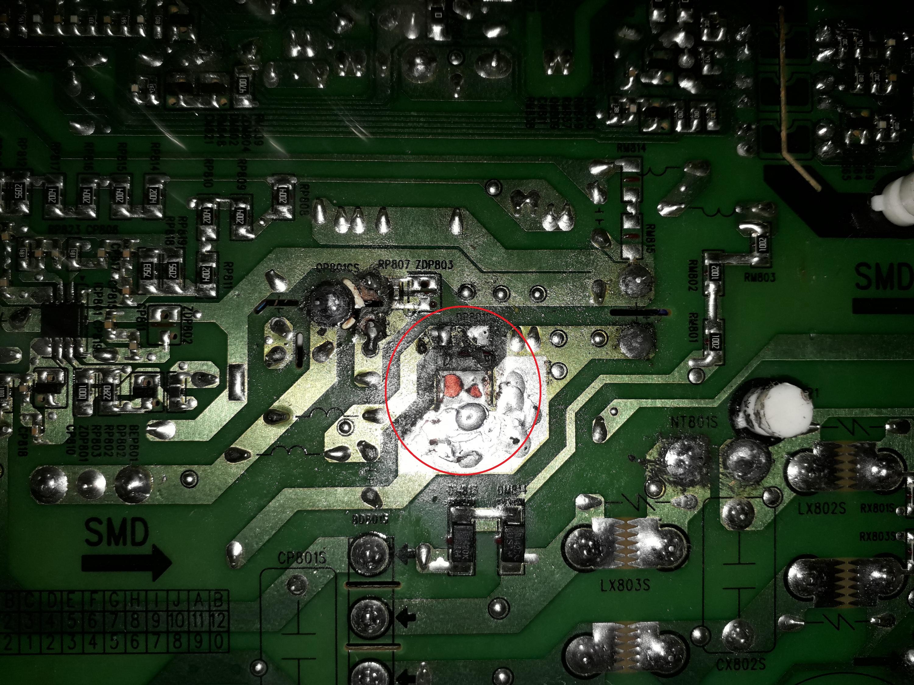

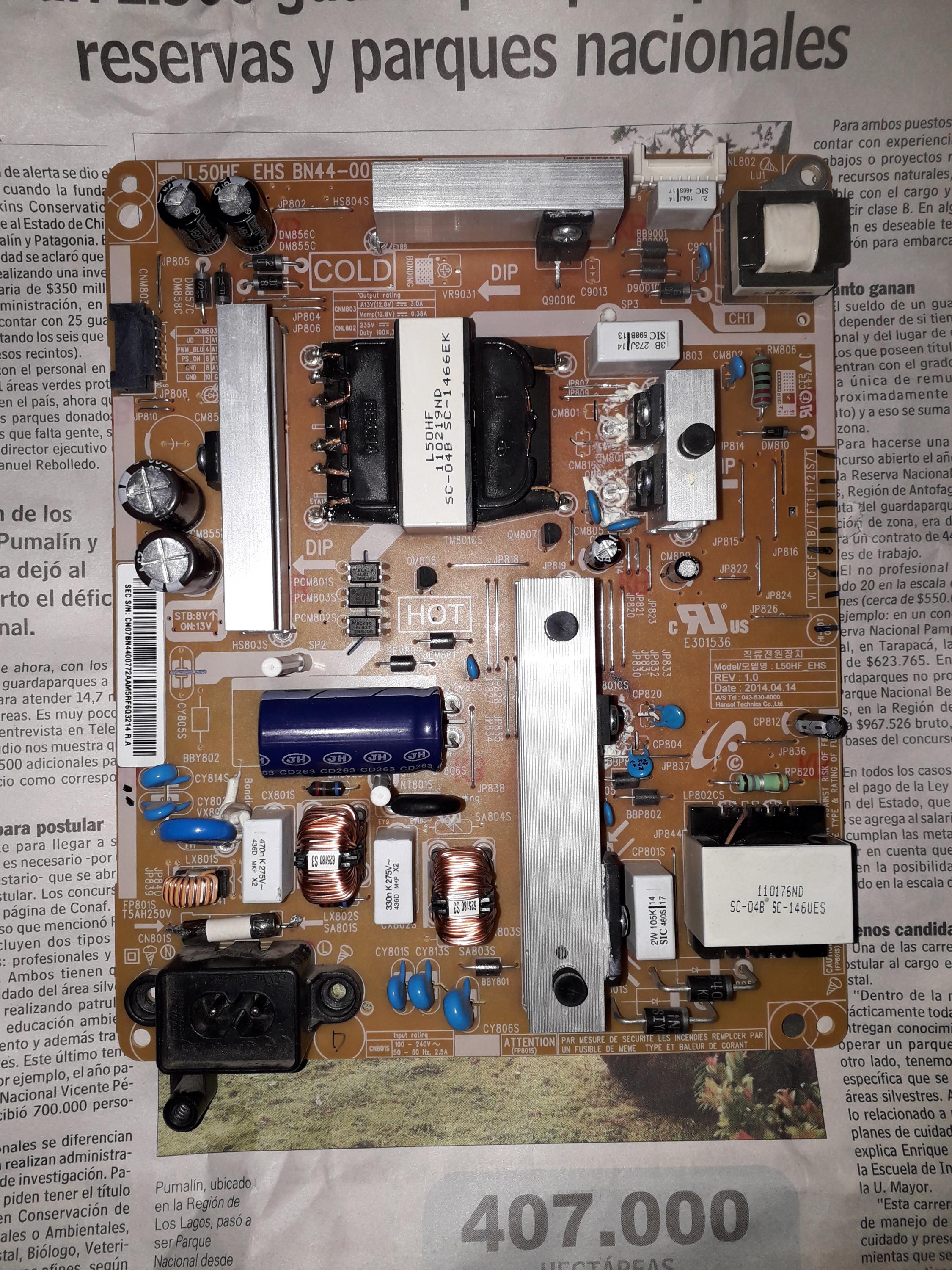

            Guys, i write from Chile. Gimme a hand here, please.
            I have a Samsung PSU BN44-00772A and a "technician" (i guess) tried previously to repair it.
            The PSU has a diode removed from it, that is located on position DP801CS. The fuse and MOSFET blown too, but that's on place.
            I just have the PSU on my hands, so i can't upload photo of the unit or the other boards.
            If someone has this PSU, i'll really appreciate if can write me here what part is that diode.
            Sorry for my bad english folks, hehe.
            Greetings from Chile.

              Re: component identification
              I can not find the original number for DP801CS, but the BN44-00707A uses a U5A6CD Ultra-Fast recovery Diode, Case: DPAK
              Most are rated at between 6~15 amps and minimum 600 Volts
                Thanks, matey.
                That reference is useful.
                If someone else have some clues about this, i'll very grateful.
                  I update this thread to inform in reference at post #25 that DP801CS was an ultra-fast diode U5A6CD just like R_J said.
