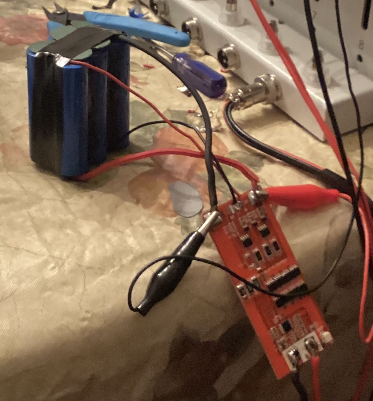

    I have bought this Zener Diode for this project what size and wattage resistor value do I need to use to get near 50 watt output
    I bought this from an eBay seller but unfortunately they only had one
    I bought three from Vetco Electronics these are Sylvania ECG5185A 9.1@10w A to Stud what size and watt resistor do I need to use to get near 10 watt output
    I bought three of from them to also make battery packs with this output power limit in mind
    I want to use this battery pack and turn it into a 9.1 output battery pack output to eliminate using 9 volt battery cells that do not have much running time and do not want to use a switching power supply for this purpose which is powered on all time even when not being used
    The BMS board that is on there right now might not be the one I use for the 10 watt version but going to use on the 50 watt version instead but I going to build a much bigger battery pack for this project for this purpose
    The battery pack that was used for testing purposes is going to used on the 10 watt power supply output for small current devices for this size battery pack
    I will be using a switch to turn off the power supply to the Zener Diode circuit board for longer running time because it is not necessary to leaving powered on when not in use
    The reason for this particular post is because I not very good figuring out Ohm law so that is the reason for posting this question
    It also been many years ago that I played around with Zener diode so this is the other reason for this post as well

    normally these high wattage zeners are not for regulation, rather they are for OV protection...

      Yep. What eccerr0r said. These are not to regulate as such.

        if you're insisting on using the zener diode to regulate, resistor depends on how much current your device uses. Without knowing the device, it's impossible to tell what resistor is needed.
        If using as a OVP device, you don't need a resistor, making usage easier.

            OVP, just shunt the output with the diode... Heatsink not required.
            As a regulator, take the highest amount of current your circuit can possibly draw and select R with V=IR where V=(lowest expected source voltage - zener diode voltage). If you get a negative resistance, the circuit is impossible. Then you have to make sure that the wattage of the resistor is at least (highest expected source voltage-zener diode voltage)^2/R and the zener diode wattage is higher than ((highest expected voltage - zener voltage)/R)*(zener voltage) which should be less than 10 since you have 10 watt zeners. Heatsink is required most likely depending on the R that you find you need.
            You probably will find this resistor to be quite silly (usually less than 10 ohms) and it along with the zener will tend to get quite hot, hence this is why this circuit isn't used as a regulator directly without an amplifier. It of course is a linear shunt regulator, and worst case would just be an OVP.
