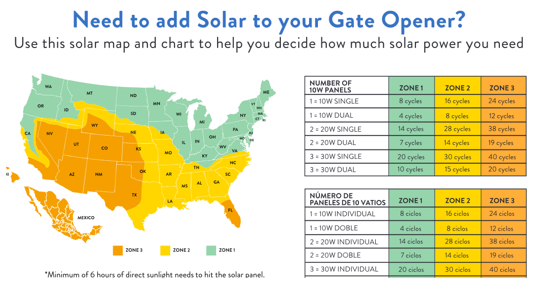

                  Ghost Controls for solar it's a 10W or 30W panel need 6hrs of sun, and two 12V 7Ah batteries. And even then you don't get many gate cycles.
                  The AC power transformer is a big wall wart at 20VA so overall they seem to charge at 1-2A max. There is an optional ABBL battery box, for up to Group 27 car battery! Those are 100Ah so I don't get why they don't offer more charging power.
                  If motor draw is 10A for say 60 seconds cycle (30 open, 30 close) that's roughly 0.17Ah used each cycle. So a 7Ah battery is much less at high drain, so I guess 20 cycles max. and of course none of this is 100% efficient or brand new.
                  The charger would have to put in 1A for 15-20 minutes to recover one cycle.
                  My math seems a bit off. They say the motor is 5A and it's got polyfuses there, so the gate opener should do much better?

                    • 31301

                      That sun chart for the state of Florida is bs because you would be lucky to maybe 10 cycles before it would start beeping to let you know that your battery is low unless is was very clear day no clouds in the sky you might get higher than that

                        #31
                        That chart looks stupid - if you add dual solar panels you get fewer (half) the gate opening cycles? Seems wrong. You had one job.

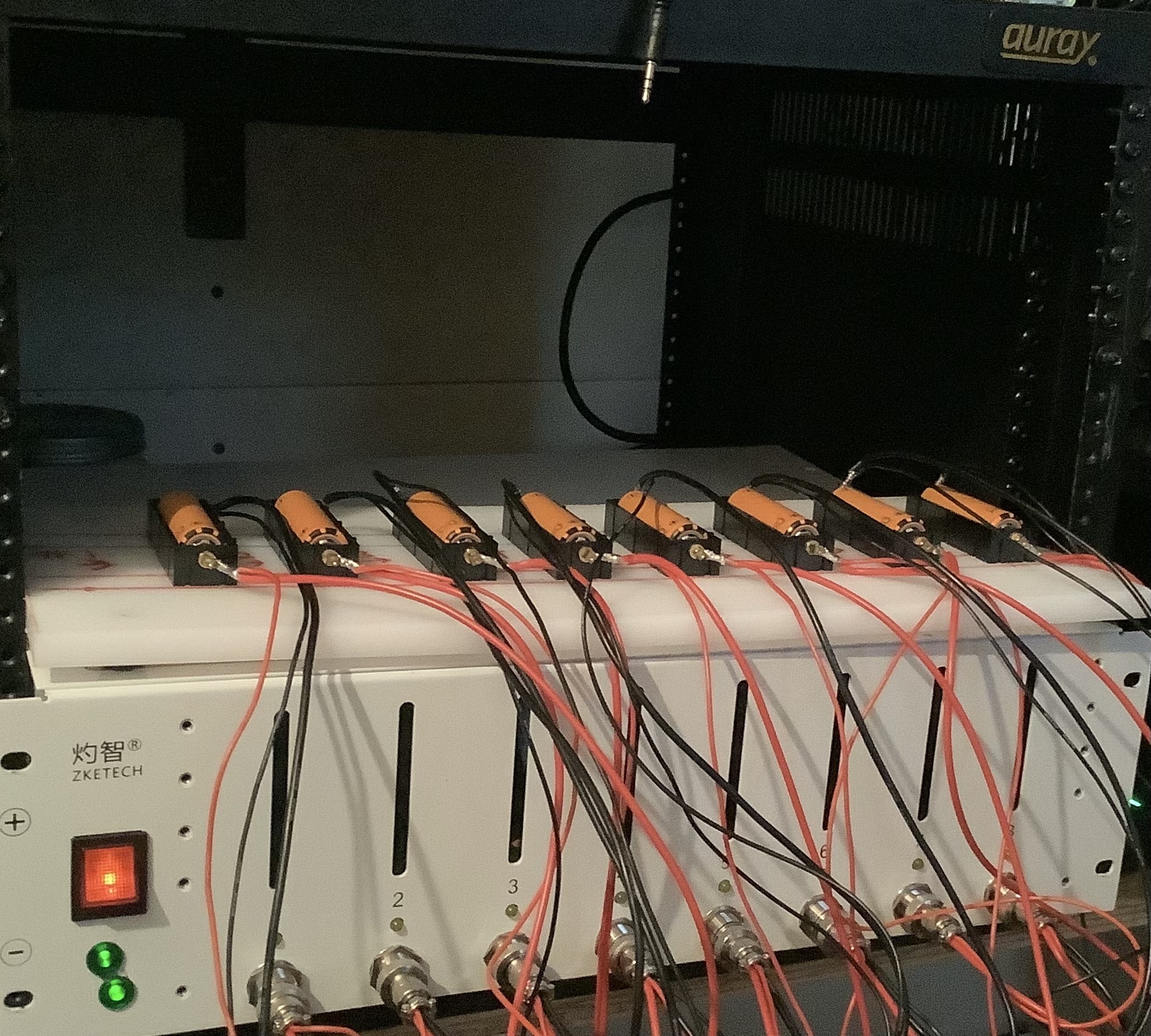

                          The lifepo4 battery cells that I was going to use are 1 amp hour @ 30 load capacity @ 3.2 volts these have orange heat shrink sleeve but do not have the A123 on them but according to Battery Hookup they are testing like the A123 systems battery cells I did a write up about in one of my previous posts a while back I bought 200 of them they were a very good price they were sold in lots of 100 in a box of 200 for a case of them they were $0.72 each
                          I was going to make a 10 amp hour battery pack with some of them but it will take two 12 volt 7 amp battery pack enclosures to accomplish this with the 3 BMS wire from each battery enclosure to an BMS protection balancing board and see if this battery pack will last longer than the lead gel battery that I have been using
                          Here is the website link for them
                          https://batteryhookup.com/products/c...42956739707042

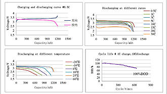

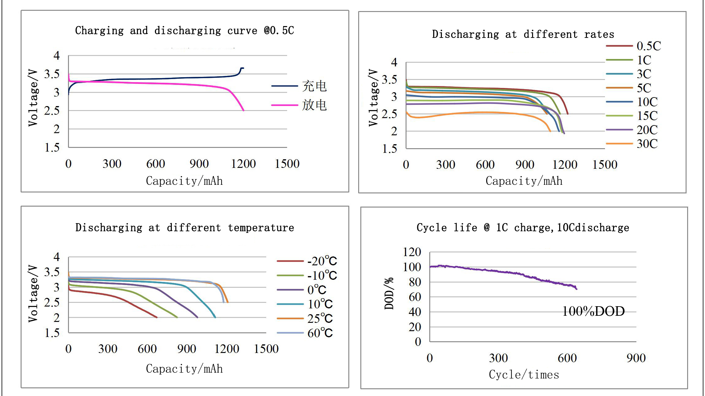

                            #33
                            Those batteries look like a good deal, I haven't switched over yet.
                            I looked at datasheets for (different brand) LiFePO4 18650 1,100mAh the discharge curve shows it does not make a big difference in capacity with high-rate discharges, unlike lead-acid. But you can't freeze them, if your gate opener gets cold like here.
                            It should work much better, even a 5,500mAh pack should be better than the original SLA I think.
