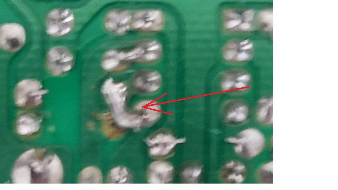

    72v to 12v 10A output is high 19.6v
    hello, this is from electric moto scooter... something happened and blown an onboard fuse in the converter box..replaced it and also replaced a bulged cap 100v 100uf ... now works but get 19v in the output instead of 12V...
    what else to check please!! this is the board:

            Post a clear picture of the back of the board so we can trace the circuit.

              battery is 84v ... pictures:

                What is that solder blob on pin 5 of the ic?
                There is an optocoupler off the output as well as a glass diode, the diode may be a zener diode? There are a couple components under the output wires I can see. It may be that the opto is not providing feedback so the power supply can't see the output voltage and is running full output
                The three 1k resistors seem to be in parallel across the output.

                          You need to use pin 5 (ground) of the ic for reference when checking the ic voltages. what is with that solder blob I asked about in post #7

                              sorry, the blob is ok, just me replacing a zener but was not shorted and the other blob on + is a wire + used with my power supply to test also ok.
                              i will recheck and report back Volts, because ic gnd was not my reference, used wire conecror gnd, my fault.thks

                                    Thanks a lot T J!! it was a 320 ohm resistor close to the opto, whose value was wrong and turned out to be burned in the hidden bottom side. tks now output is 12.8V the end
