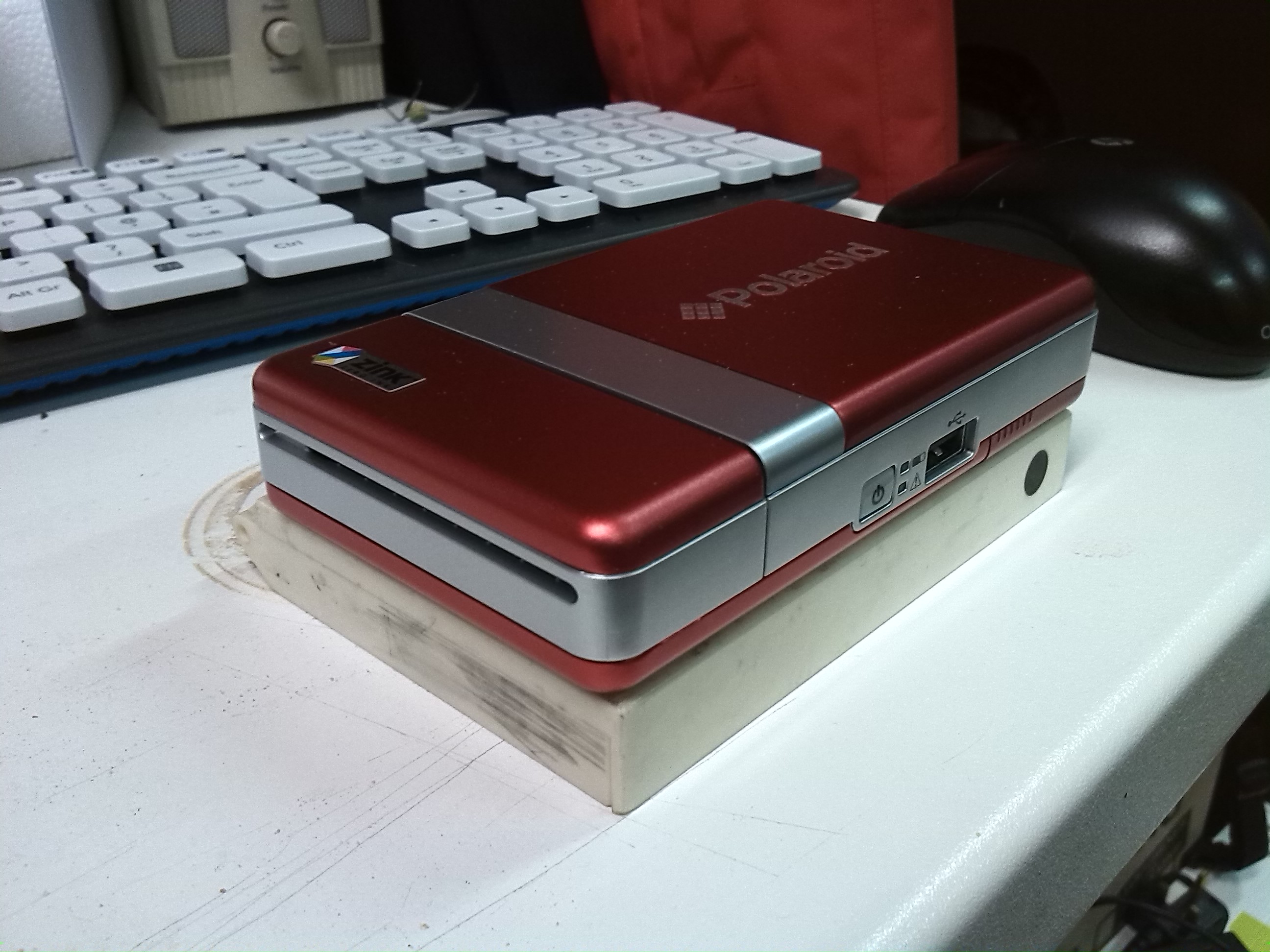

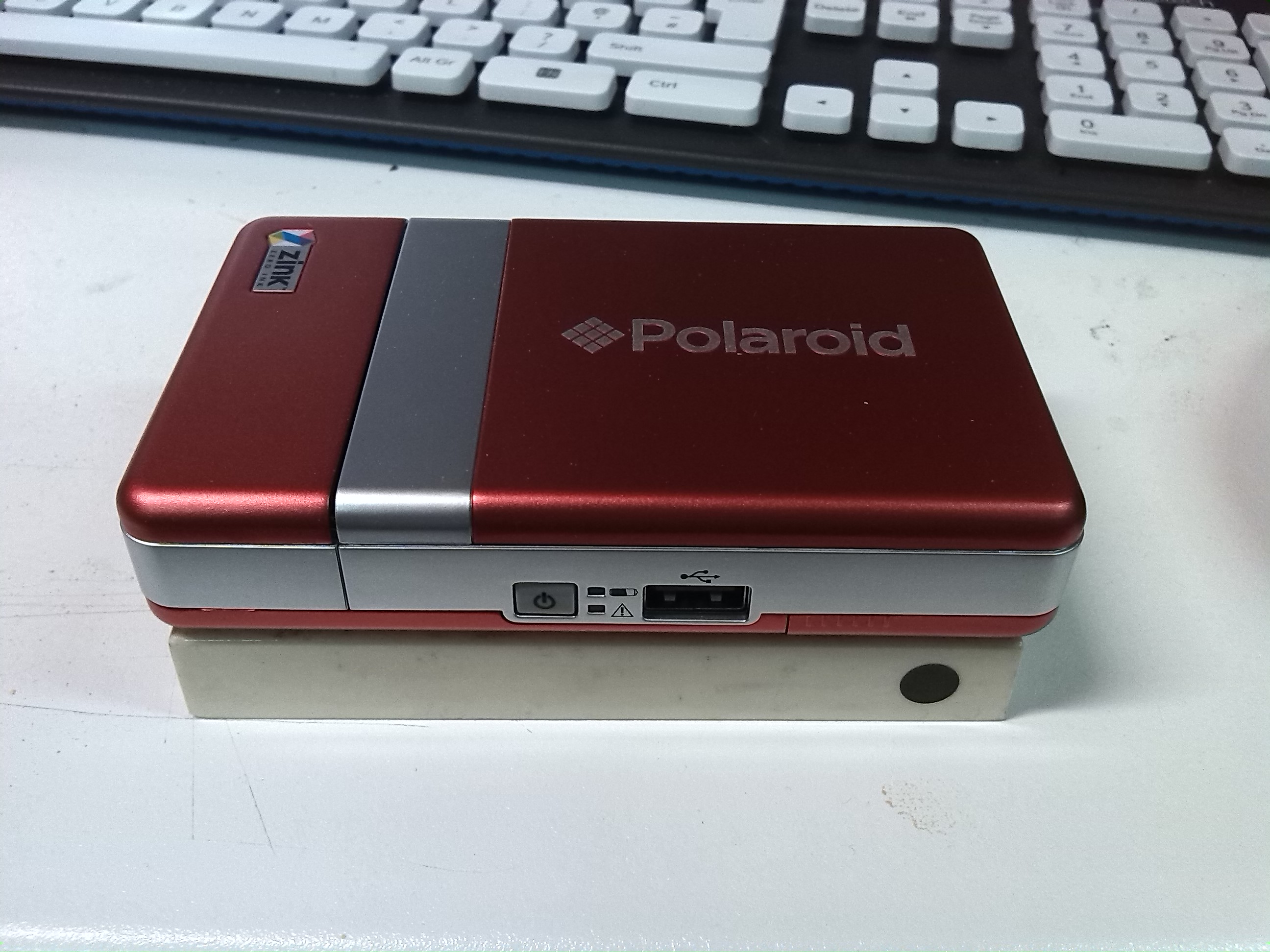

What I'd like to do is build an external battery for the pogo printer using the old battery shell and contacts to run the leads through to an external battery. Do you know what I mean? Or maybe it would be safer to build an external battery from scratch, and cut an access port to go from the external battery to the printers power contacts. I've got an idea to build the battery to have the same footprint as the printer so the printer can lay on top of the battery. The battery could be attached to the bottom of the printer either by sticky hook and loop pads or thin magnets. The external li-po battery will be charged using the printers built in charger, hopefully..... maybe :-).

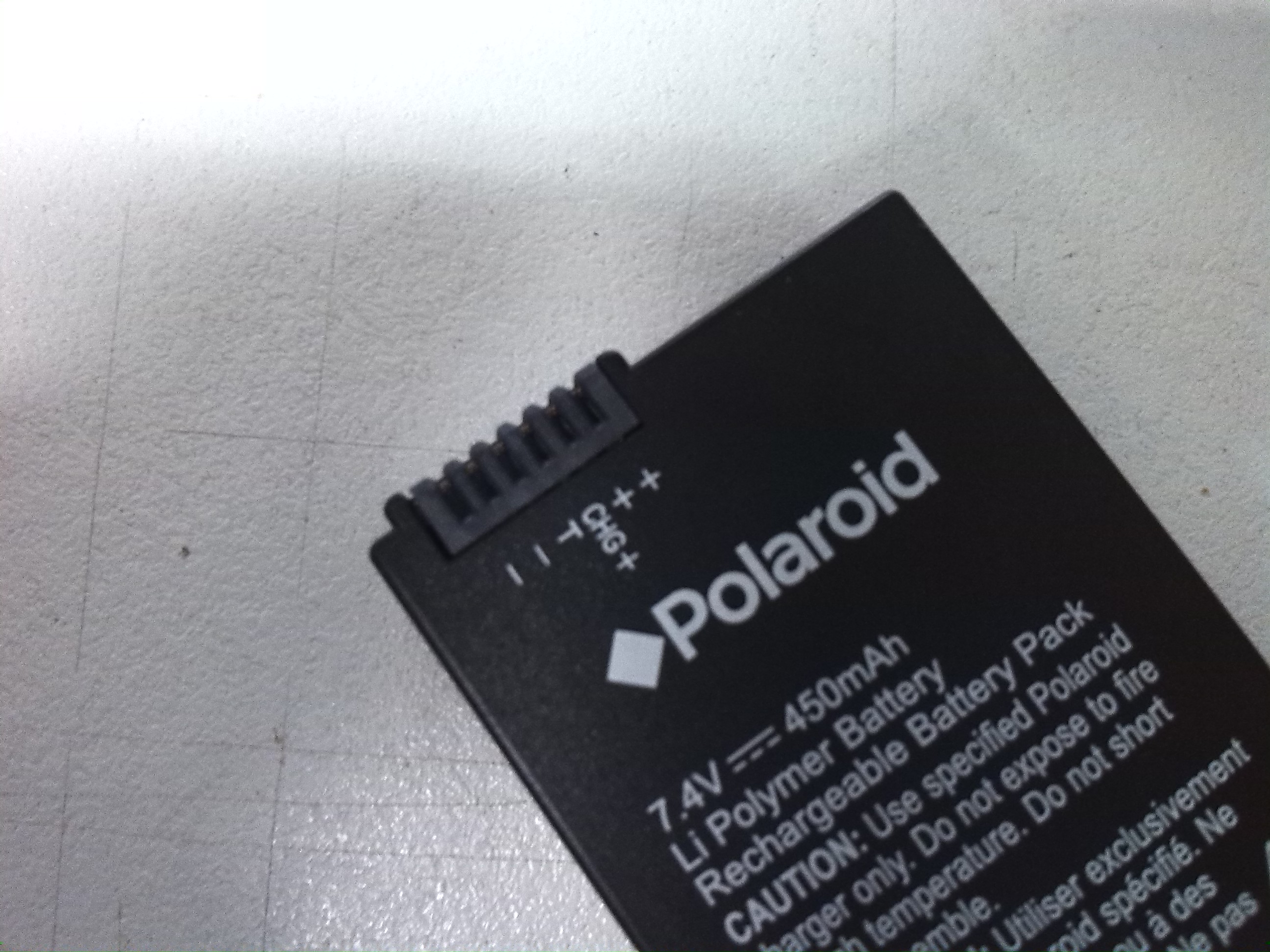

I'm looking for a spec/data sheet so I can bring more information about the battery but I can't find anything more than the model numbers.
So if I've done my homework and worked it out right then I "think" the li-po battery supplied with the printer is most likely a 2 cell 3.7v 450mAh with a 1C discharge rate ( 7.4v 450mAh). It takes 2.5 hours to fully charge the battery according to the manual.

Just added mock-up pictures so you get an idea of what I'm going on about.
