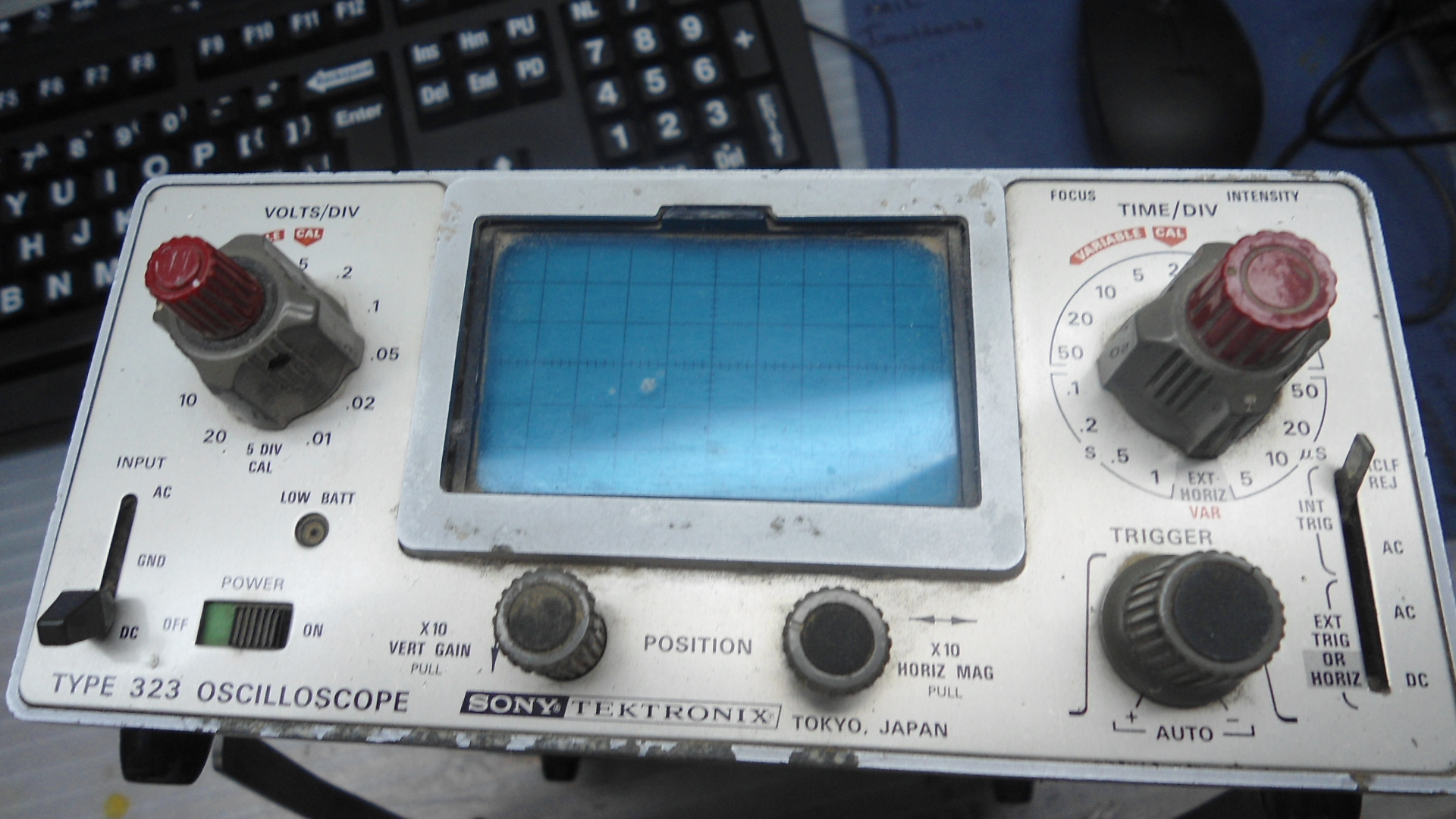

    i picked up this portable oscope at a fles market long,long ago.(model type 323)
    the question is the scope only goes up to 5microsec on the time knob.
    to find the bandwith is it 1/max freq,in this case 1/5 micros?
    and,is this good enough for monitor work?

    4MHz.
    info: http://w140.com/tekwiki/wiki/323

      thank you twbranch,
      do you think is good enough for monitor work?
      what do you guys recomend? for that?
