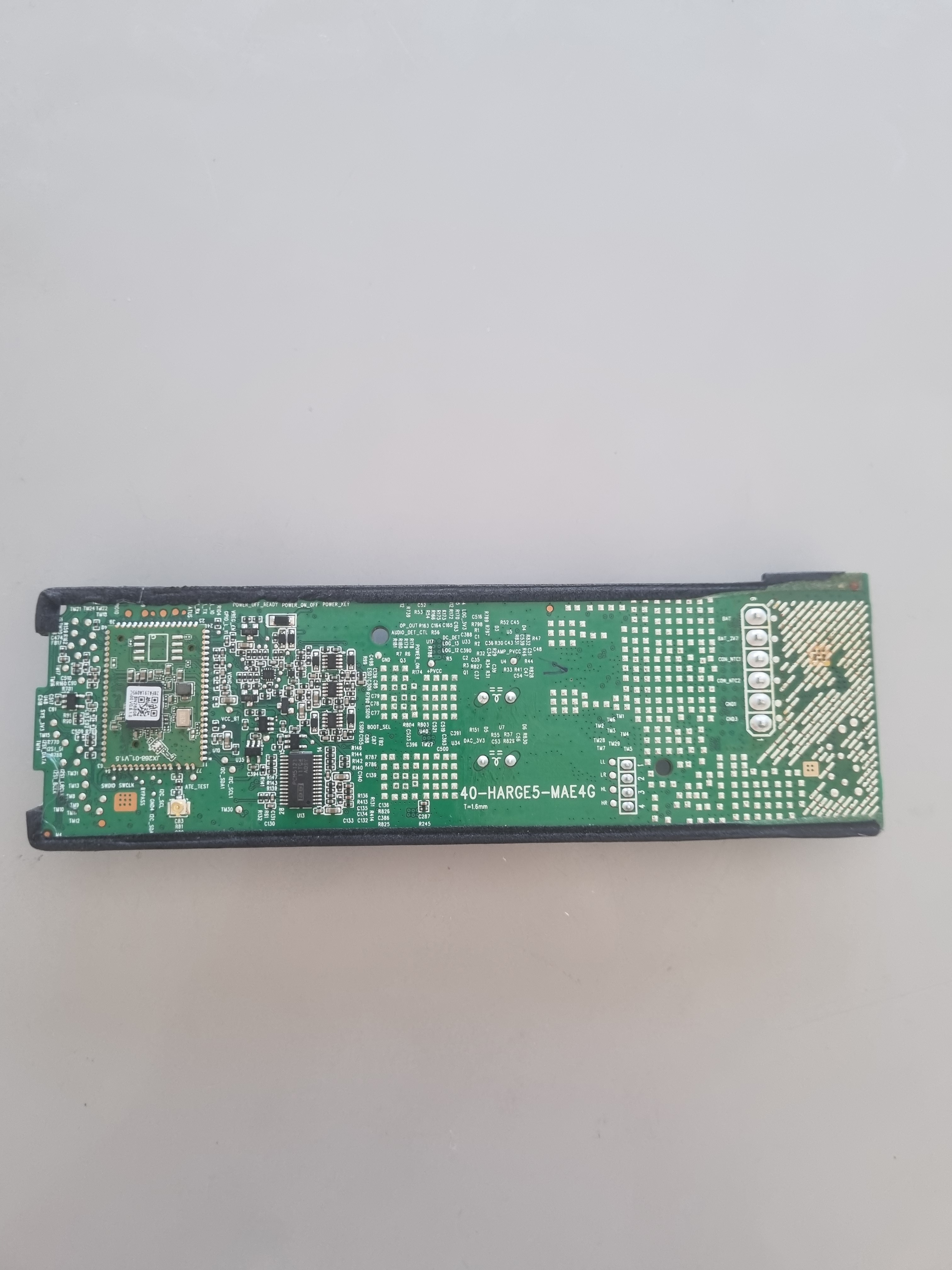

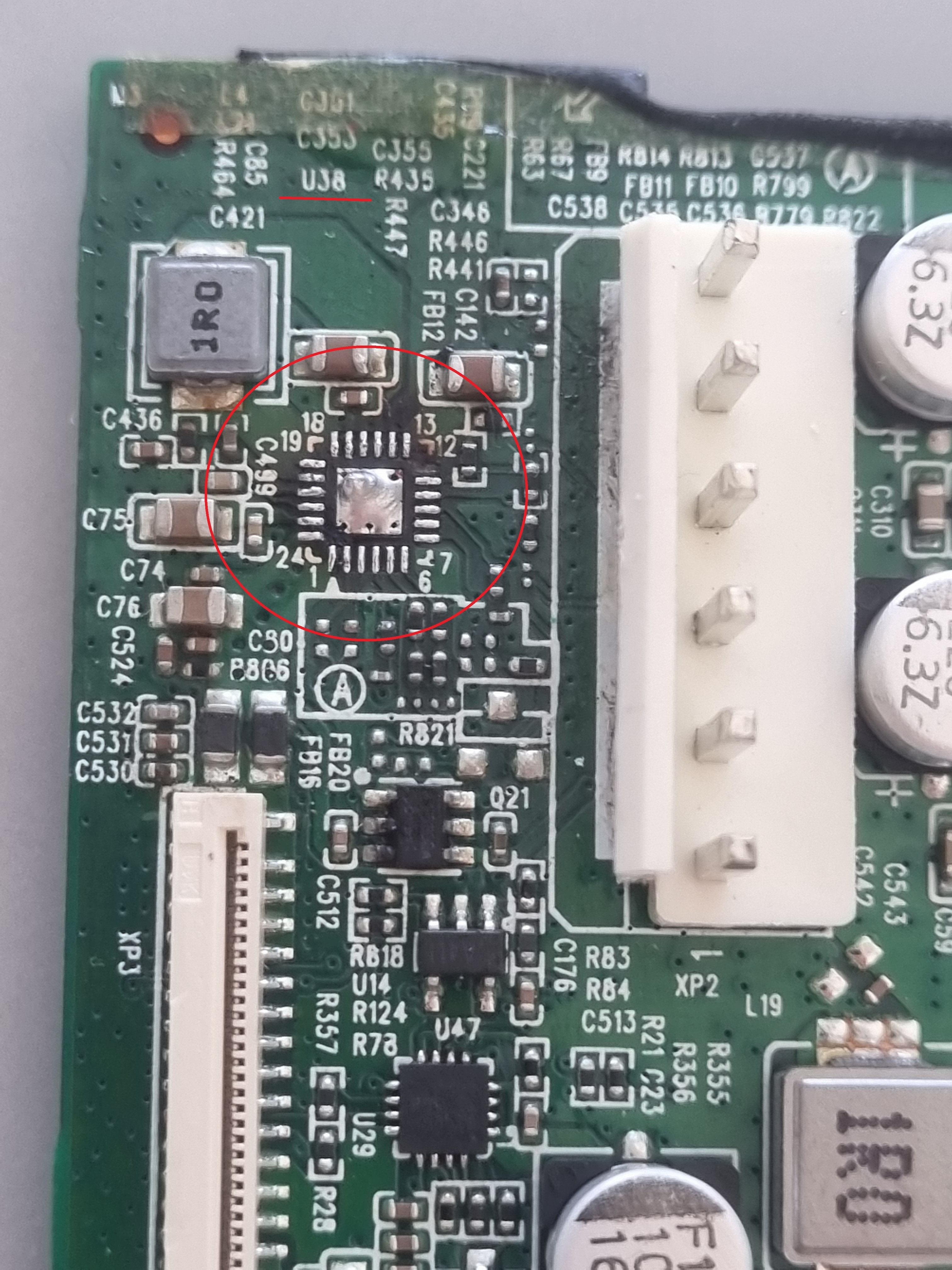

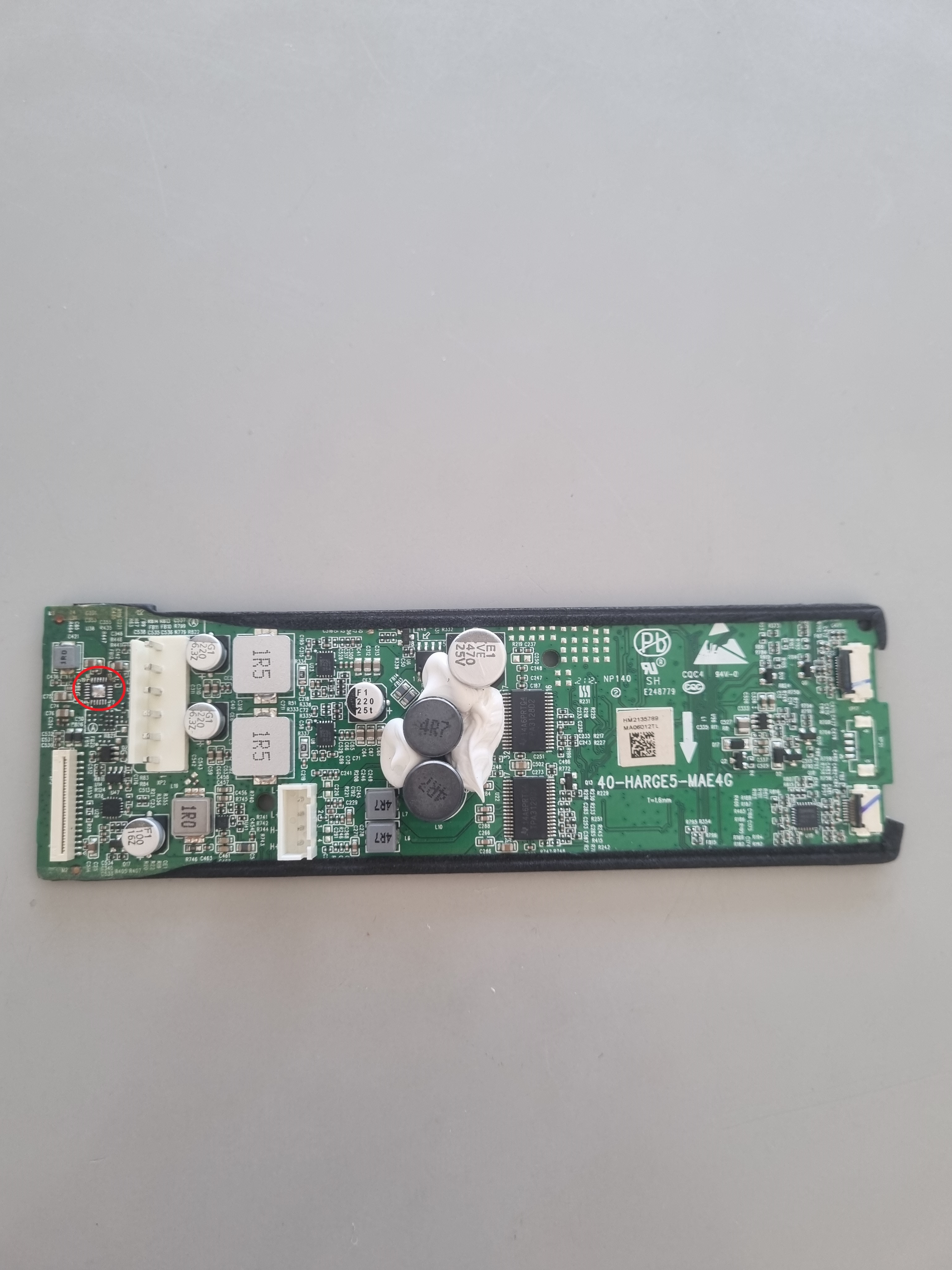

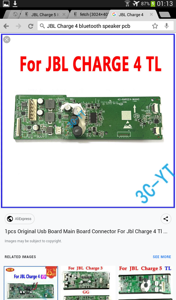

    Hi everyone
    I have a JBL Charge 5 speaker that I need to repair
    I would like to know if anyone knows the identification of this charging IC, it is a BQ chip , I am attaching photographs for your recognition, it goes in the place where the red circle is...... I think it is marked as U38 on the pcb
    Thank you very much for your help
  • harp
    • Jun 2022
    • 643
    • Planet Earth
    I search for pcb photos, but cant find sharp one, maybe in some video with microscope... at least, it is qfn-24 package bq chip with four lines printed on it, visable is only edge outline shape... or maybe you can ask seller to picture pcb?

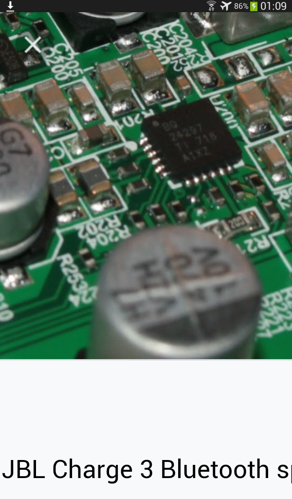

    On jbl charge 3 is bq24297, and for jbl charge 4 it may use the same chip like yours, judging of component arrangement...
    You can do reverse engeneering and trace each pad to hopefuly determinate what bq is used...
