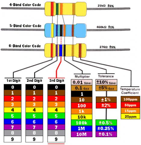

    my multimeter is damage and i found an open resistor 10ohms .25% 1/2 watt 5 band resistor is it okey to replaced with 4band 10 ohms resistor resistor..

    What colour bands from left to right are you seeing???

      its brown, black, black,gold,and blue

        the only difference is the tolerance, therefore the 4 band is a better quality resistor that you will be replacing

          Is that right? he is replacing the 5band 0.25% with a 5% 4 band.

              They may have use tight tolerance due to it is used for current sensing circuit such as the resistor connected to the Source pin of the MOSFET. So you need to find out how this resistor is being used, since it went open, that means the MOSFET or what ever it is connected to is shorted out.

                  Did you understand what Budm said?
                  In simple terms
                  Depending on where the resistor is being used it might be important to use one that has .25% tolerance
                  Testing with your multimeter makes no difference you cant measure tolerance

                      not sure if I am missing something here, (apologies if I am), but this is how I see it
                      resistor 10 ohms 25% tolerance = could measure anywhere between 7.5 ohms to 12.5 ohms resistor
                      resistor 10 ohms 5% tolerance = could measure anywhere between 9.5 ohms to 10.5 ohms resistor
                      making the 5% tolerance the more accurate resistor
                      therefore I would replace with a 5% tolerance in place of a 25% tolerance
                      but would not put a 25% tolerance where a 5% tolerance was
                      put me out of my misery if I am seeing this wrong
                      and please tell me where I am going wrong with my view of this

                        Yes you are missing something - a decimal point or 2
                        Tolerance is nought point two five not twentyfive

                            OK, it is used in the meter (I missed that in post 1), that is why it is high precision. Even if you put in new resistor, the meter will have to be re-calibrated or check the calibration to see if the meter is still within tolerance.

                                  It is always important if it's .25% they don't spend $$ if it isn't needed. That being said, another consideration can be thermal coefficient. While you can make your own precision resistor you wouldn't be able to duplicate the thermal coef.
