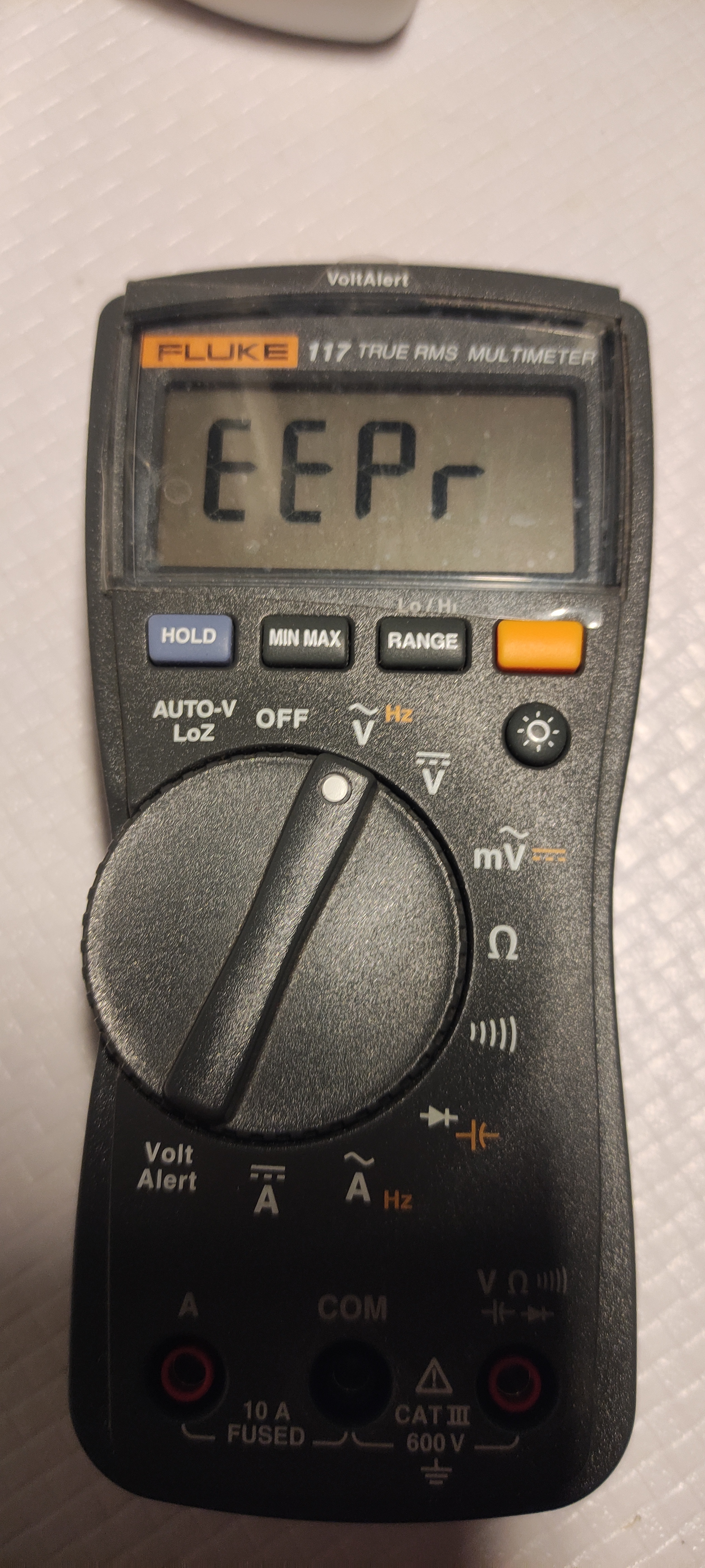

    I own a Fluke 117 multimeter, and suddenly it started displaying "Err EEPr" when turned on. What puzzles me is that the error is not permanent; sometimes it works fine.
    Do you know what could be wrong with the multimeter? Any tips on how to try to fix it?

    EEPROM error​

      Take the EEPROM out make various reads and verify the content. Buy a new EEPROM and copy the data to it, solder it it and pray she comes back to life. Clean the DMM inside while your at it.
