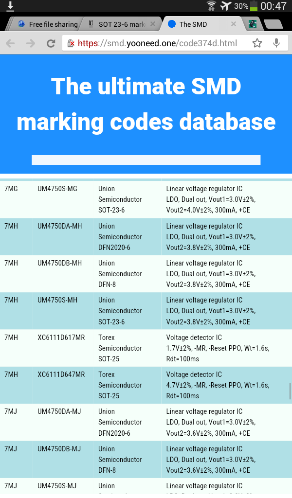

    I am trying to repair a modeling railroad decoder because rear light remains glowing.
    It's connected to a really tiny SOT23-6 chip that is marked as 7MH. Any idea what it could be? (it's a LaisDCC decoder).

    A photo of the PCB might help to identify the IC.

      UM4750S-MH?

        I finally have been able to identify it............it's a MUN5235DW1T1. (Dual Bias ResistorTransistors)

          MUN5235DW1
          https://www.mouser.com/datasheet/2/3...D-D-346531.pdf
          http://markingcodes.com/search/c/7m
