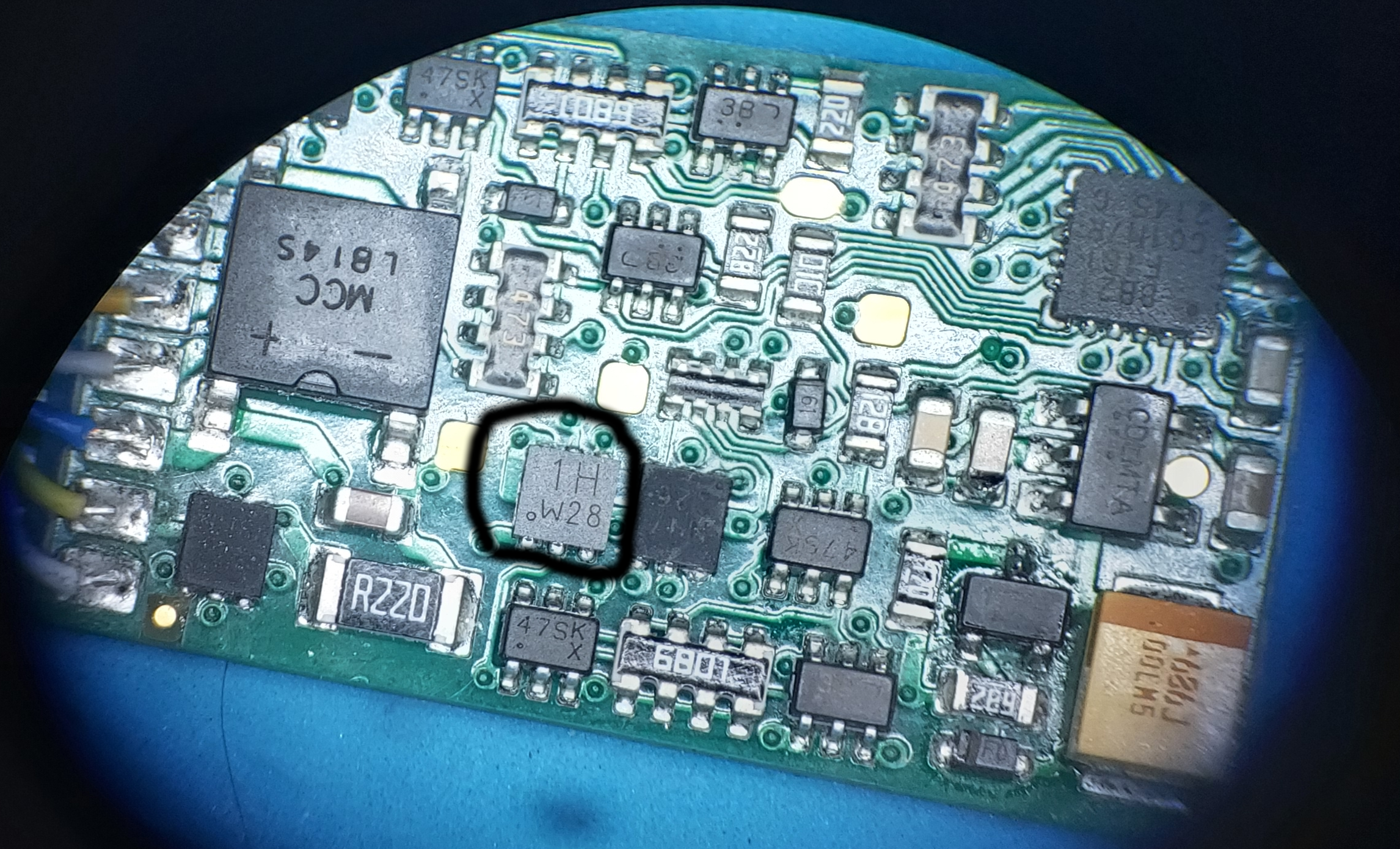

    Hi:
    I am almost certain that this is a Mosfet, but I am not able to find it. Could you please guide me? This is a really tinny one.
    Thanks in advance,
    Francesc.

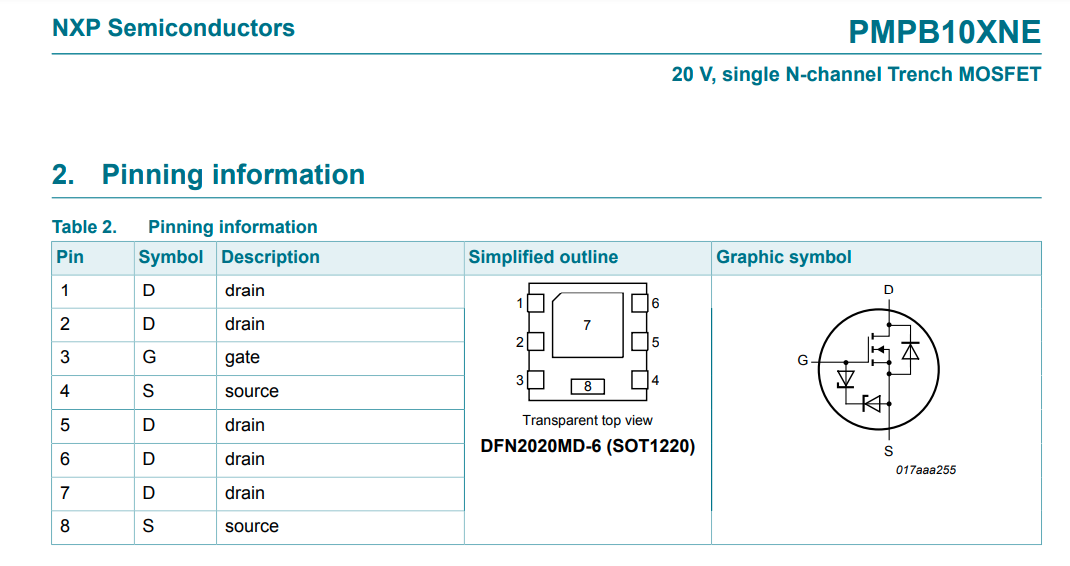

    PMPB10XNE
    https://aliexpress.com/item/1005005771139919.html

        I just desoldered and it has the following pinout/layout:
Name:	Captura de pantalla de 2024-01-24 21-18-21.png
        This does not match with the suggested one, right?

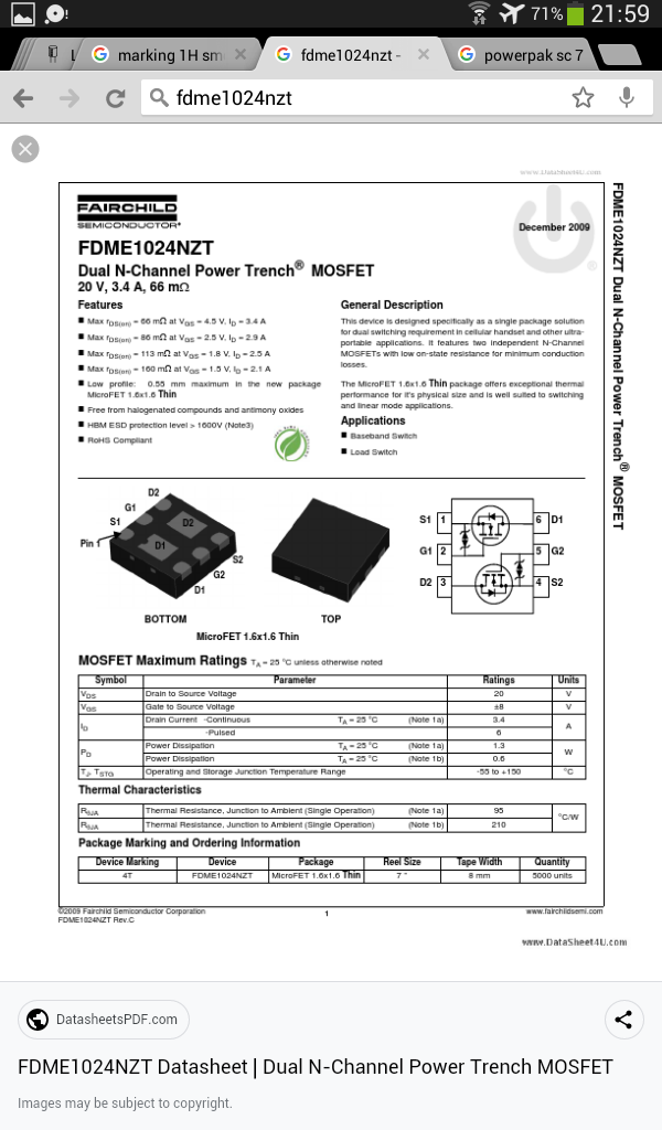

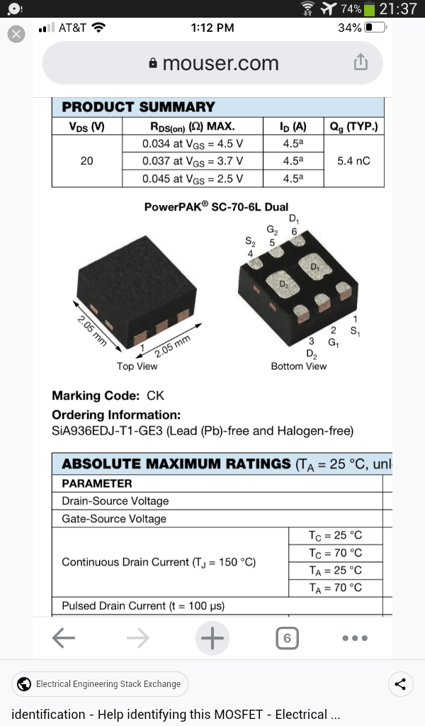

            I dont know about marking, but package is powerpak sc 70 6L dual
            Apears in various pin configuration, be careful when ordering.

              PMDPB70XP
              https://www.mouser.com/datasheet/2/9...XP-2938778.pdf

                  Thankyou everyone for your valuable feedback. I would bet for the PMDPB70XP
