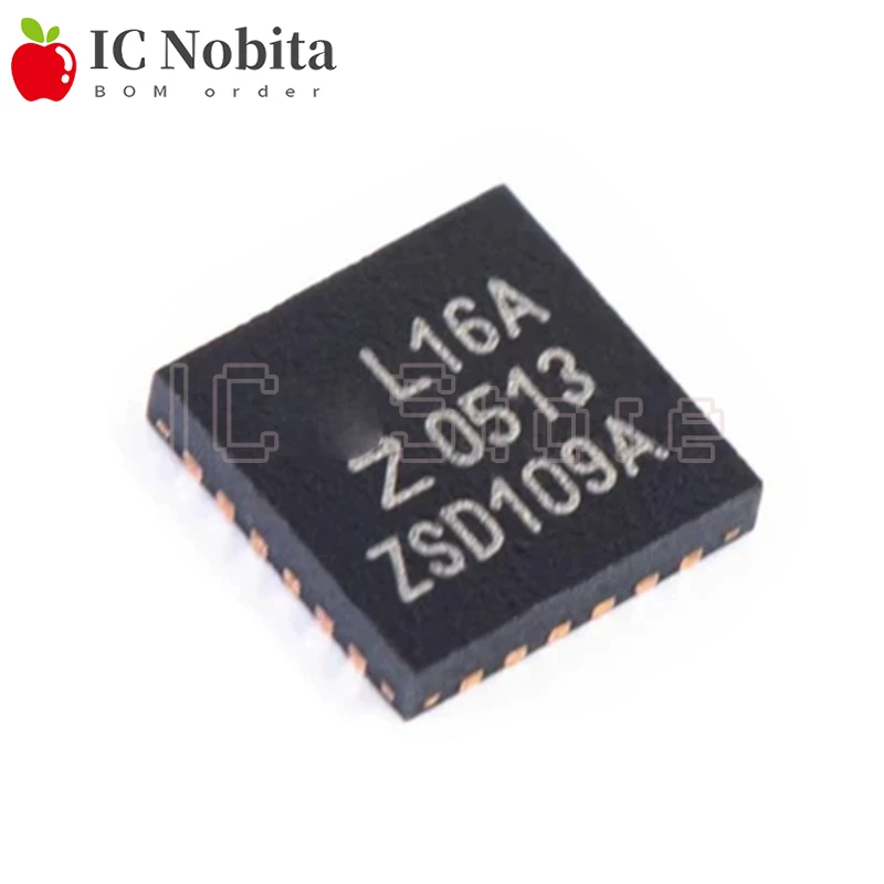

    I am trying to work out what this IC is, not seen this one before.
    I don't have a schematic available so having to do the old skool following traces etc.
    I am trouble shooting an Xbox One controller that is not powering up via USB-C or Battery (2x AA)

      https://ae01.alicdn.com/kf/Sb2e3cf9e...r-Chip-New.jpg
      https://www.aliexpress.com/item/1005006032152107.html
      PCAL6416AHF - Low-voltage translating 16-bit I2C-bus/SMBus I/O expander with interrupt output, reset, and configuration registers
      https://www.nxp.com/docs/en/data-sheet/PCAL6416A.pdf

        truclacicr
        thank you so much, that is exactly what I was looking for
