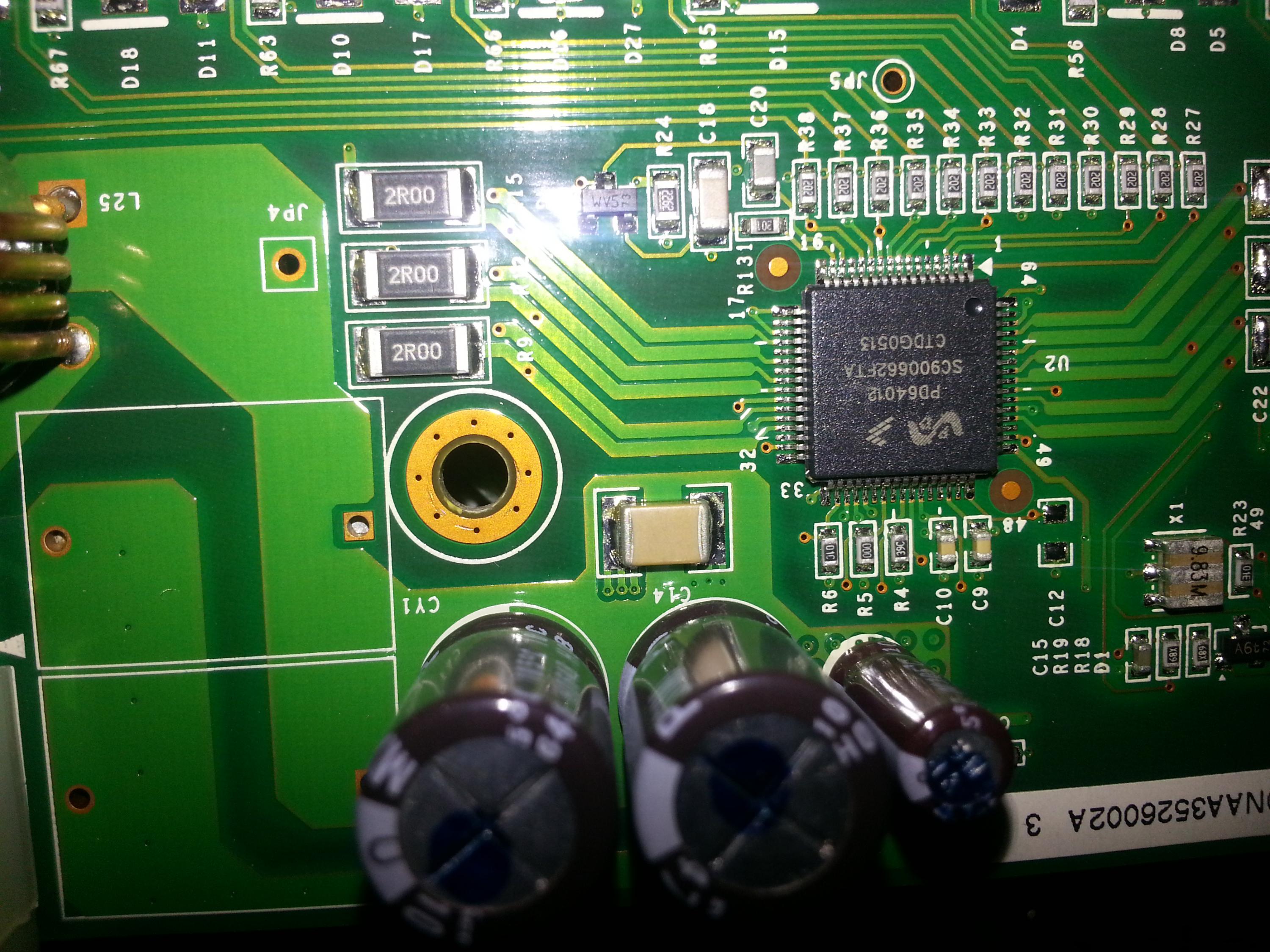

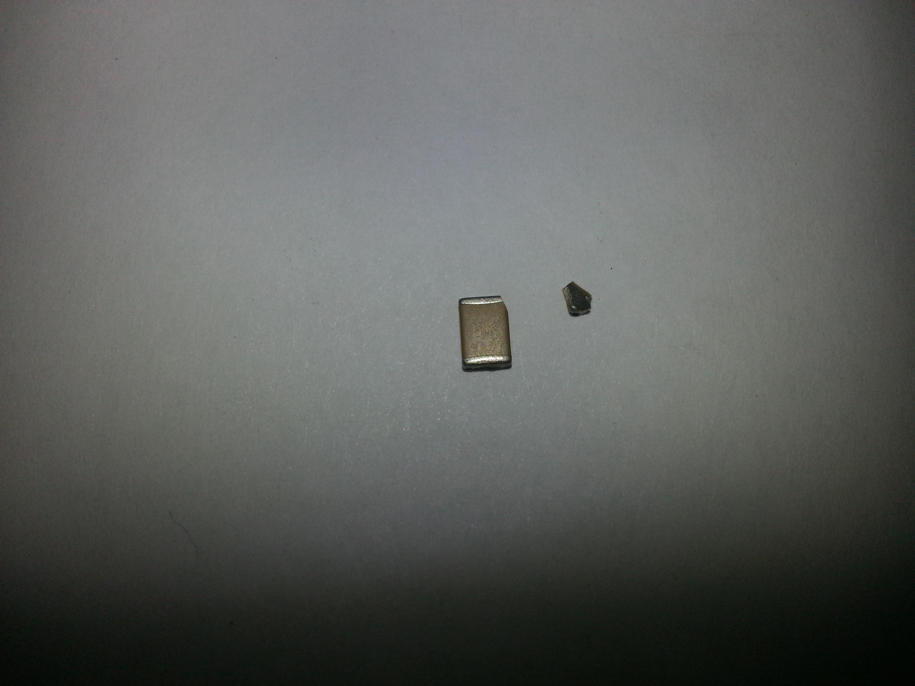

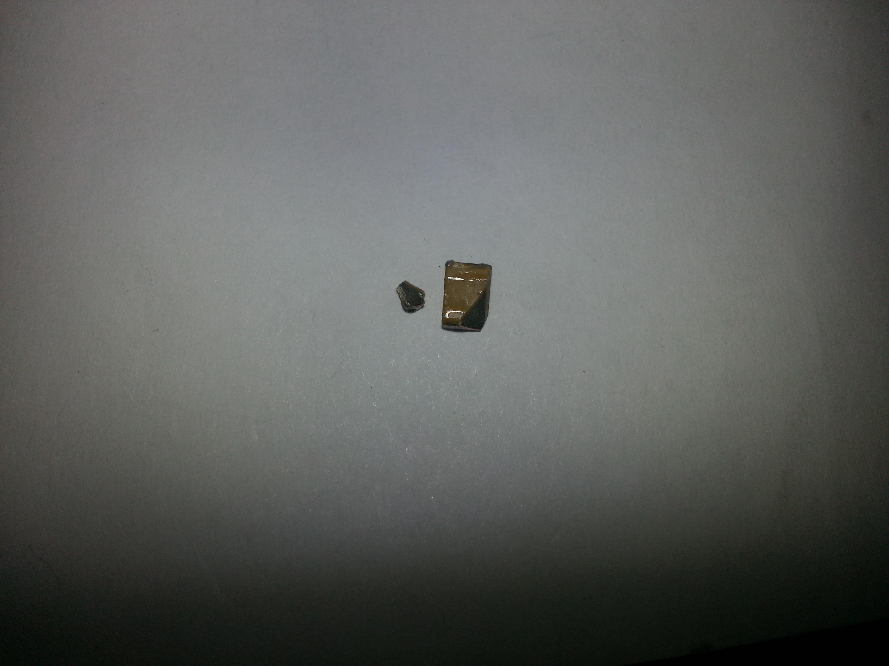

    crunched an smt cap
    So, in haste, I crunched a smt cap on my network switch. Thankfully it came off without damaging the board.
    I figure I have a few options.
    1. Epoxy the exposed parts, flip it and resolder. Cross fingers and hope for the best.
    2. Identify cap and replace. My cheap capacitance meter reads 370nf. Its on the back of the POE board, which means, to be safe, I should get a value over 50v. I don't see any markings, so I think it doesn't have polarity.
    What do the gurus think?
    Suggestions on value or type of cap?
    Here's some pics.

        Re: crunched an smt cap
        Is this cap connected in parallel with a electrolytic cap? If it is, it is then will be something like 0.1~0.47uF MLCC type.
        370nf = 0.37uF, so I would say it is 0.33uF or 0.47uF.

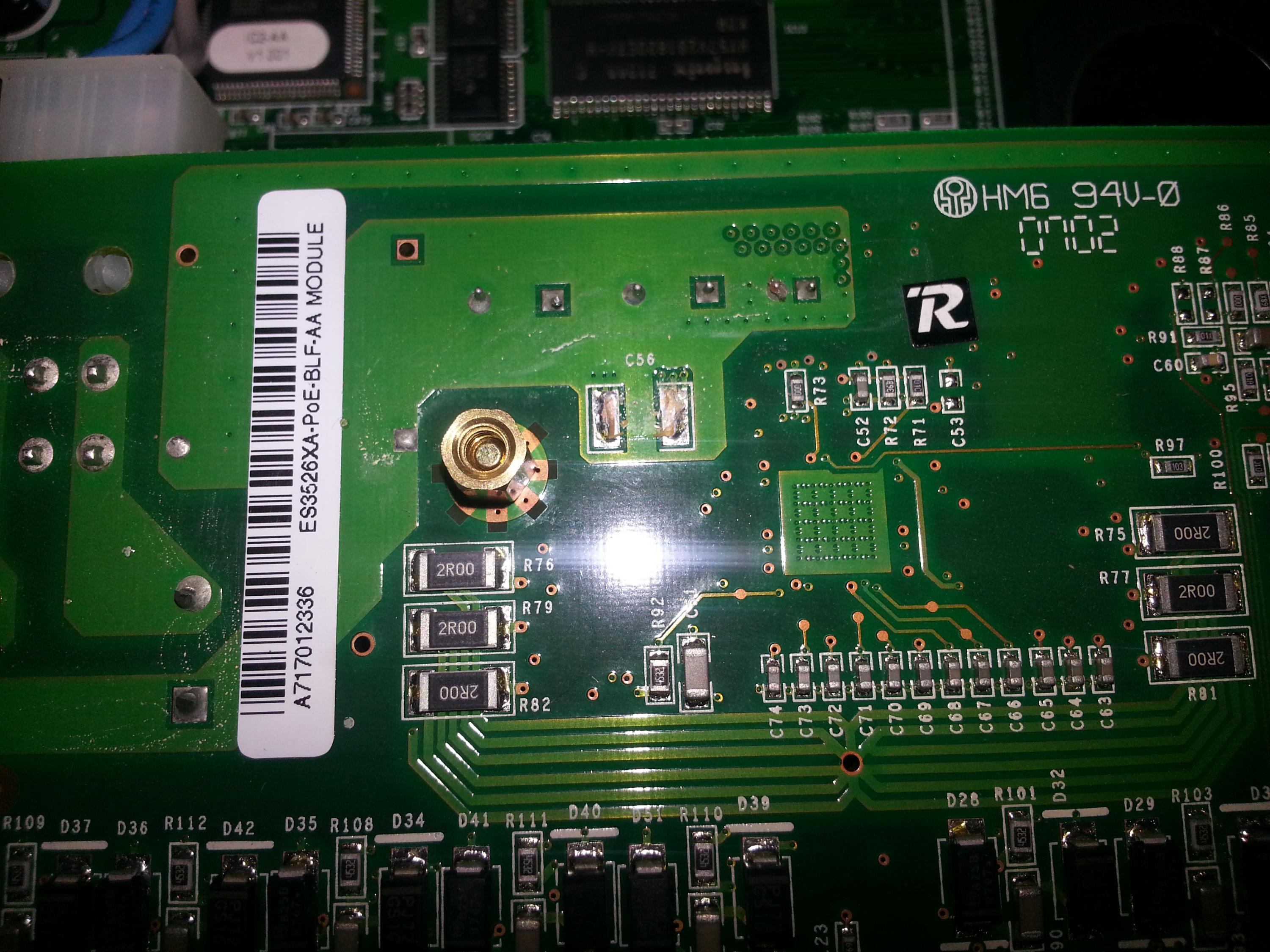

          Funny you should mention that. It is connected in parallel with some electrolytics. One wrinkle though, it looks like 2 smts (identical?) are hooked end to end with each other, then hooked parallel to the electrolytics.
          Calipers are out of battery.
          Now, since one leg is not connected because of the other cap being missing, I think I can measure it in circuit.
          The other side of the board:
            It is just typical bypass caps setup.
            Is the unit still function?
              Interesting. The paper mentions that different values and packages are used *in parallel* to remove different frequencies. I haven't been able to find any information on the design considerations on hooking up capacitors in series to perform a bypass function.
              Do you think the two caps are similar, or different?
              Thanks!
              I haven't hooked it up, didn't think I wanted to risk plugging in a known bad system. It might work, it has been functioning at a surprising level given two obviously blown capacitors.
              • lti
                • May 2011
                • 2547
                It looks like those are in parallel, not series.
                  You are right, I had the pictures flipped around. Thanks! That makes more sense.
                    Finally, the calipers, a battery, and the cap all in one room.
                    It looks to be an 1812 case. I ordered 2 in .33uf and .47uf. Definitely a cheap mistake.
                    Looking at the electrolytics, they are rated for 100v, so twice 48v (poe voltage) was correct.
                    Thanks guys!
