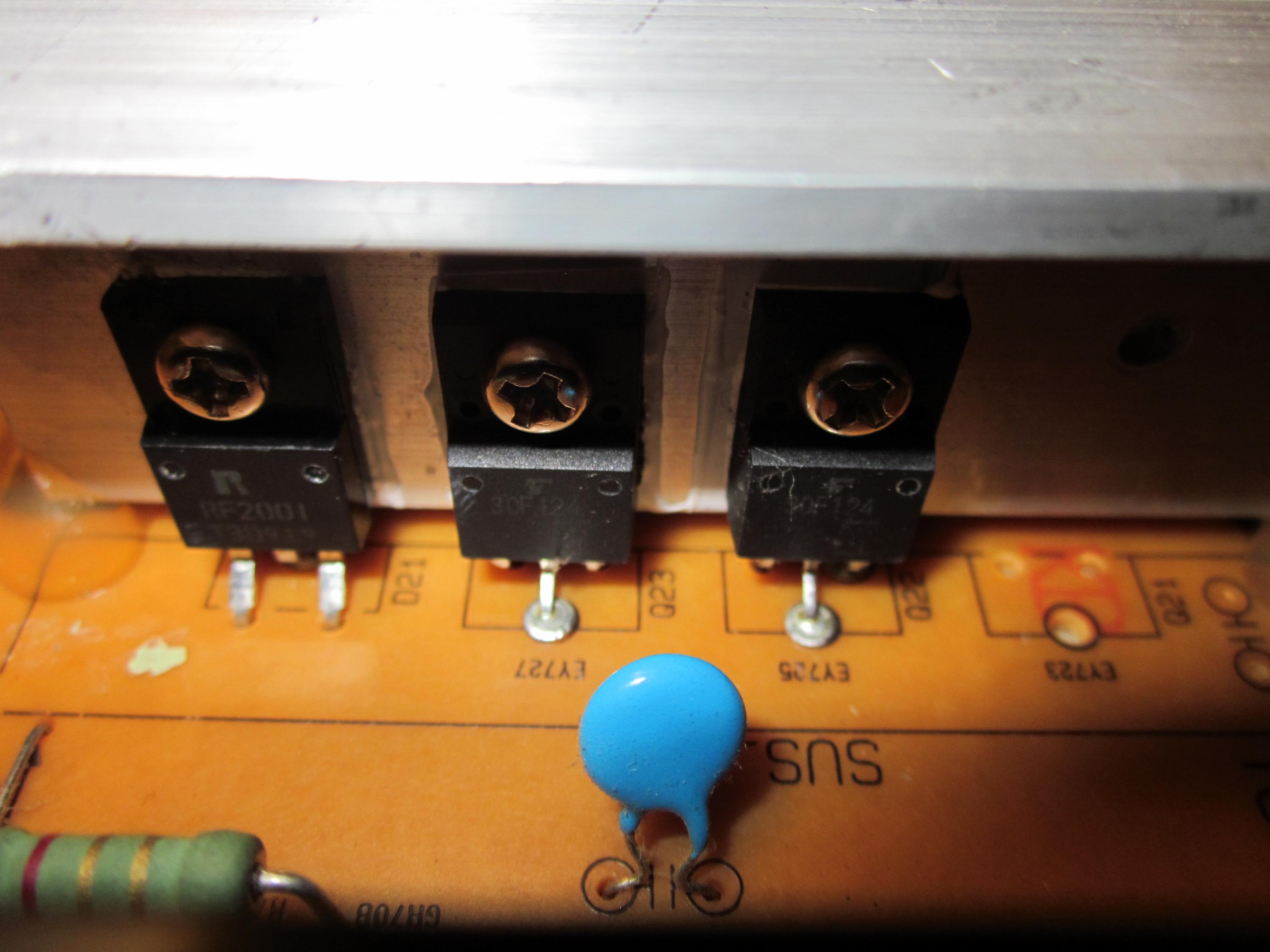

      Sorry I am a crap typer and have mild dyslexia. What I am trying to ask is I swapped out a shorted fet with one from another board. It matched what was listed in schem, but is a different brand/type (it came off of a Visio psu) I'm just hoping it wont blow anything, but at this point I'm willing to risk it. I'll let you know how it goes.

          That attitude is what gets me in trouble sometimes, but luckily nothing happened. It was a transistor off of a Vizio power supply and I put it on the ysus of the LG I've been trying to get working.
          Here is one with numbers: The chip/fet is 30f124 and I'm get drastically different readings. I know is 1 of the five is bad for sure because I get OL in the spot I get a reading on the other 4. But one pair gives me a reading almost double what the other do. And the two giving me the high reading don't don't have a pin that touches ground

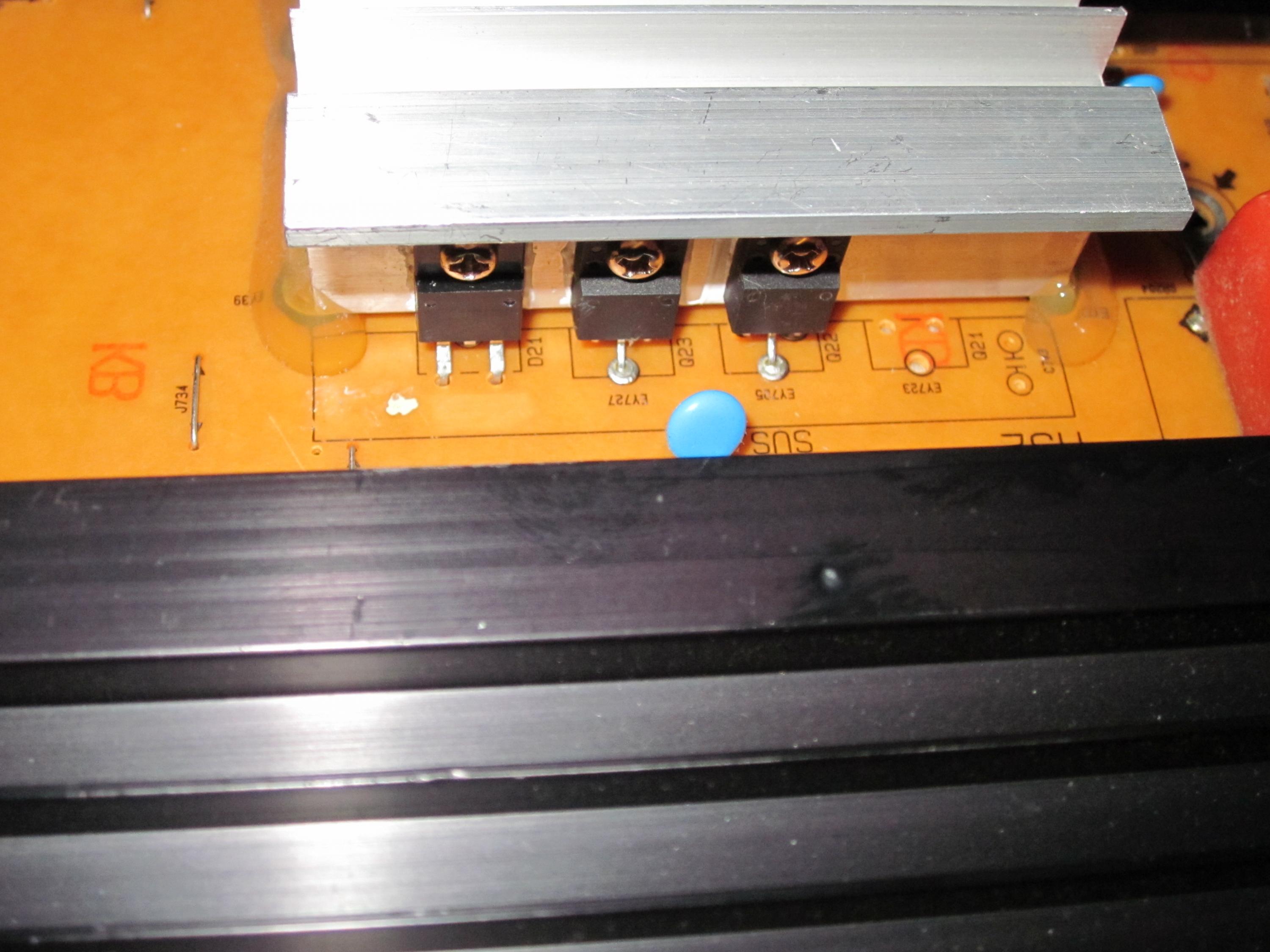

            On a ysus board out of a 50pq30 the fet's at the same spot on the same board (the boards are interchangeable) are 45f122. Does that mean that the 30f124 on my board should have the same output as what's listed for the 45f122?

              Voltage they're close but current rating no.

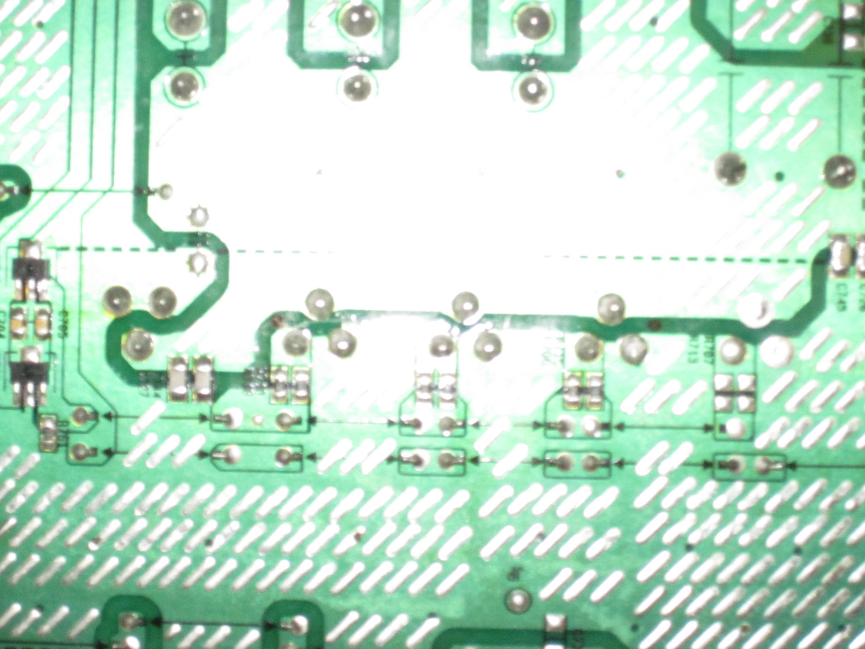

              maybe post some clears shots so we can see what exactly we're talking about. 2 pin sounds like a diode unless it's a surface mounted FET?

                Man you guys are awesome! Now if only I can figure out what that all says. Here's the pics. It's in a difficult spot to take a picture and that's why I hadn't included one before

                  Looks all original, Ok so I understand a little clearer. The PQ30 has the 45Amp and your original has the 30amp?
                  Same voltage, maybe a production upgrade to improve reliabilty. I don't see any 2 pin but 3 pin RF2001T3D which is a double diode. RF2001 means 20amp the suffix is important too 3 means 300V, D means double diode.
                  So T4S means single 400V,T4D 400v double etc, T2 200v etc

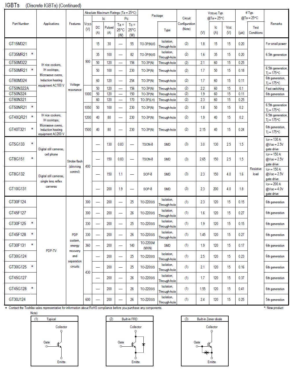

                    Here's what I believe to be the same PDF, but in English
                    http://www.semicon.toshiba.co.jp/dow...10_catalog.pdf
                    But I'm having problems deciphering what the correct outputs should be. Do they increase when they have a common contact point?

                      I don't understand, usually they have them working in parallel, if there's nothing shorted I'd move on or remove from the board and test them individually.

                                If I'm reading the "part numbering scheme" section correctly, I should be able to sub the 45f122, 45f127, 45f128 or 30f125 for the 30f124, correct?

                                  They should be 3 pin, that's my point. I own a panasonic which has those boards and I've spent a lot of time trying to rebuild the SC boards with some success.
                                  The only thing I'm not 100% on is the how important Vce sat is? Otherwise as far as ratings goes they'd all do.
                                  IGBTs can be pricey, but that Fairchild is not a bad price and should work.

                                      I check voltage, current, peak pulsed current rating , case construction, pinout configuration and Vce sat which I'm thinking you would want equal to or less than what was in there but I can't quote from experience.
                                      If it was me chasing those specs and I could not get exact replacement I'd give those fairchild ones a go. Does not mean I'm right but you should be ok.
