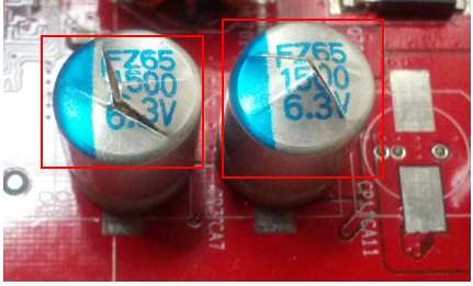

    Hi everyone,
    Im new to this website and I get to know it is a great forum. Recently my vga capacitor failed and I was finding the right capacitor for replacement but I dont understand the values stated on the capacitors. Can anyone help me?
    Values stated on the capacitor:
    FZ65
    1500
    6.3V
    What is 1500 means? 1500uF?
    Thanks..

    Re: Need Help to Identify this Capacitor..
    Yes those are 1500uf 6.3 volts
      Hi Selldoor,
      Thanks for the reply...it is possible if I change to this type of capacitor?
      http://malaysia.rs-online.com/web/p/...itors/0571098/
      Is there any different between the two types of capacitor?
      Thanks.

        I am not certain better wait for other comments. I cant really see from your picture if the ones you have are surface mount or through a hole. Do they have a plastic base?
        Will the ones you suggest physically fit - height and width
          The capacitor is soldered through hole and it did not consist of plastic based. I believe it is not SMT capacitor rite? If so, it is possible I replace the capacitor on the link i provided above?
            That is a 1500uF 6.3v rated electrolytic capacitor.
            It's low ESR, so you have to use low ESR capacitors. Panasonic FK is reasonable but a bit too "weak" for that usage. It is cheap but not really suitable.
            I would suggest using one of these instead (from best specs to lower but still better than FK):
            http://malaysia.rs-online.com/web/p/...itors/5261137/
            http://malaysia.rs-online.com/web/p/...itors/7037260/
            http://malaysia.rs-online.com/web/p/...itors/7083651/
            http://malaysia.rs-online.com/web/p/...itors/5261294/
            http://malaysia.rs-online.com/web/p/...itors/5260976/
            http://malaysia.rs-online.com/web/p/...itors/6270968/
            You'll notice some are rated for 10v or 16v, that's fine. You can use capacitors rated for higher voltage but never the other way around.

              Thanks alot~!! much appreciated and I learn something new today...
