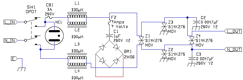

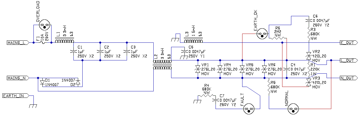

    In two power conditioners I have handled, I believe the following as per attached circuits are the sinewave tracking filter section:
    L1/L2, C1 and BR1 (BR1 is wired like two diodes back to back) in the Precision Power model.
    L1, C1-C3 and D1/D2 in the Total Power systems model.
    Is this correct?

    That is just another fancy name on the same function as shown in my 1950 GE Solid state handbook.
    Using bridge rectifier to feed the cap.
    Google "surge voltage clamping using capacitor and bridge rectifier"
    http://www.google.com/patents/US4580205
    https://cdn.badcaps-static.com/pdfs/...17721cbed4.pdf
    https://cdn.badcaps-static.com/pdfs/...b98ccdd556.pdf
