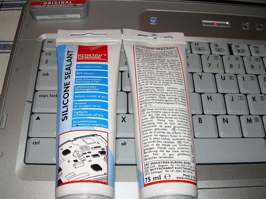

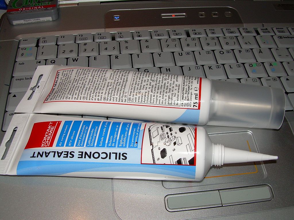

        Re: The Glue or Mastic question
        Just got these, tack free after 60 minutes and a cure time of 10 hours, made by crc.
        Operating temperature active product -50 to +230
        Dielectric strenght active product 17 kV
        Crc 32045-001
