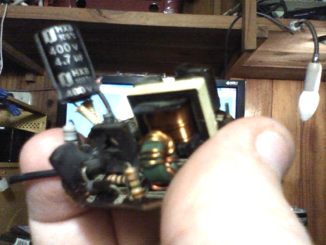

    ... just opened it up, and found what you can see in the image below (sorry about quality, can't ask much more of a feature phone). Ymin? 400v? I think I understand why this costs 4 bucks...

    I don't understand, what's the problem?
    It's not fake, it is 400v rated, it has to be because the cfl bulb may be sold in countries where there's 230-240v and then the voltage is rectified so the capacitor sees 240 x sqrt(2) = 240 x 1.41 = ~ 340v
    The green capacitors you can see in front in the picture are the most often cause of failure, they see high voltage pulses until the lamp actually lights up.

      Besides having a 2-month life, no, no problem, but it looks cheap all right. Maybe I have too many chinese PSUs around me poisoning my mind...

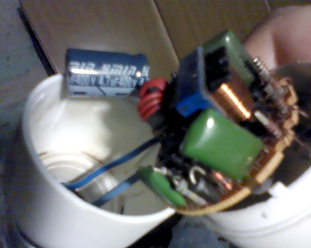

                Here is another one, failed this morning (they do go down in pairs). Difference is, this one is almost a year old and was barely turned off, so, I guess it's exactly what mariushm says.

                  Been looking at failed CFL's, I end up seeing a lot of burnt transistors. I think a lot of CFLs weren't built with actual bulb failures, and when the bulb loses its seal or a wire breaks, the transistors self-immolate, taking everything down with them...
