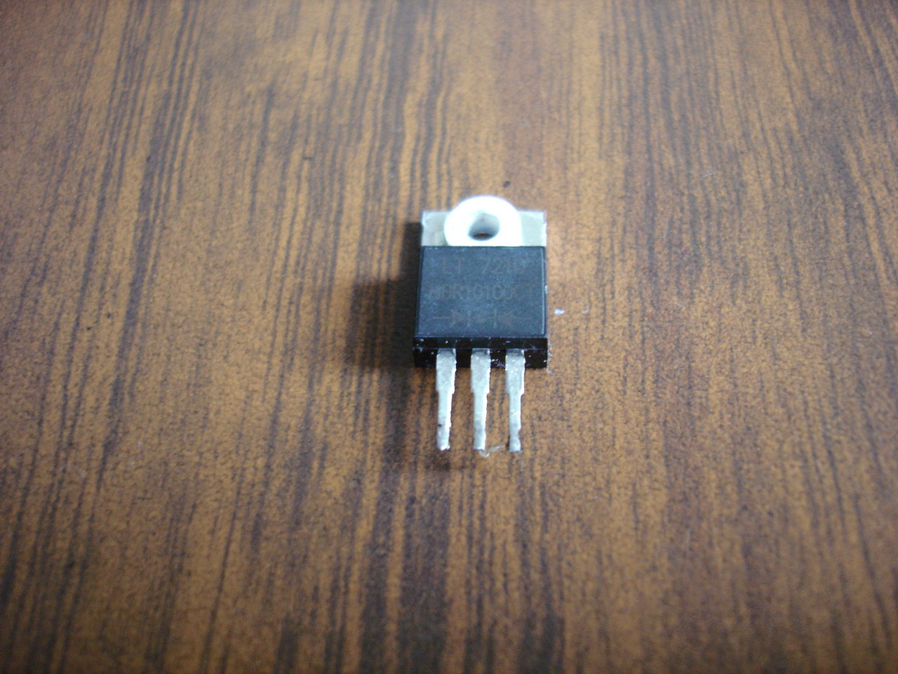

    I can't find any spec. of this transistor, someone help me please.
    LT 7210
    MBR10100CT
    I need a replacement to fix the inverter/power board of a Hyundai LCD
    Re: Help with transistor equivalent
    Not a transistor, dual diode:
    http://www.digikey.com/product-searc...014?k=MBR10100
    http://www.digikey.com/product-detai...PMS-ND/2213574
    10A, 100V breakdown, Schottky-metal barrier type.
      Thank you Tom!
        10A HIGH VOLTAGE SCHOTTKY BARRIER RECTIFIER
        You can find lots of them on eBay : http://www.ebay.com/sch/i.html?_trks...at=0&_from=R40
        The important parts are :
        Peak Repetitive Reverse Voltage
        Working Peak Reverse Voltage
        DC Blocking Voltage
        100 V
        RMS Reverse Voltage VR(RMS) 70 V
        Average Rectified Output Current 10 A
        Typical Junction Capacitance (Note 2) Cj 300 pF
        so filter by those (but you should be able to find exactly this mbr10100ct)
        If you want them from digikey :
        http://www.digikey.com/product-detai...0GOS-ND/918577
        http://www.digikey.com/product-detai...F4W-ND/2153159
