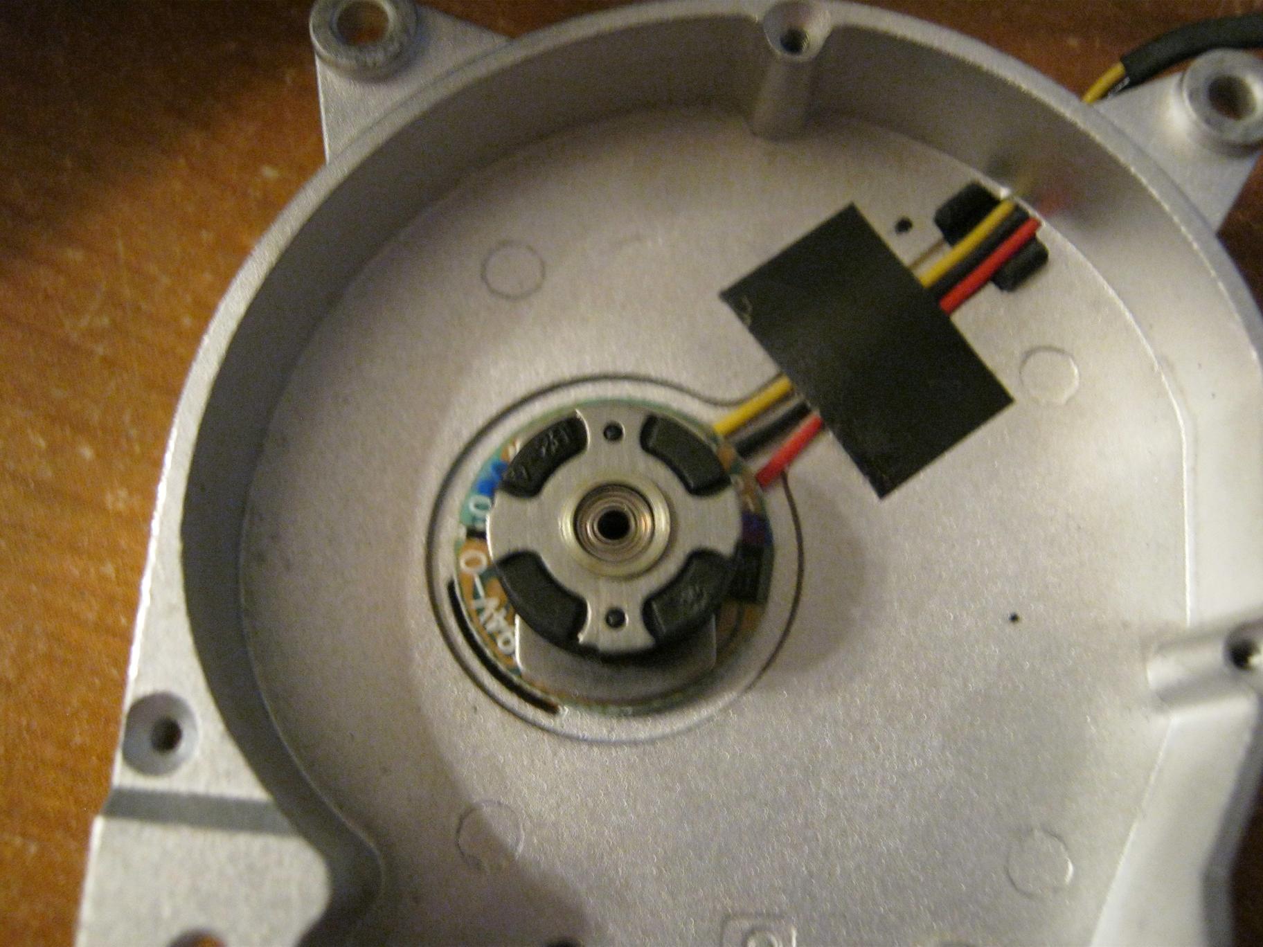

    I want to take apart a laptop cooling fan to find out why it stopped working. Is this possible? It looks like the fan blade assembly and shaft can be removed if I remove the plastic ring that is pressed onto the end of the shaft, but I can't figure out how to remove that ring.
  • lti
    • May 2011
    • 2555
    Re: Fan disassembly

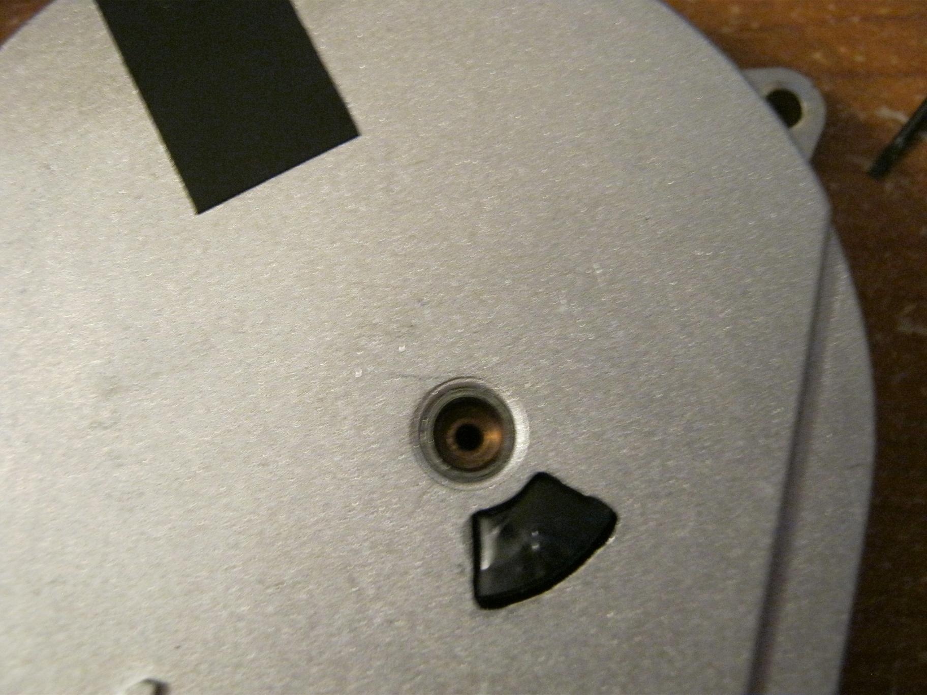

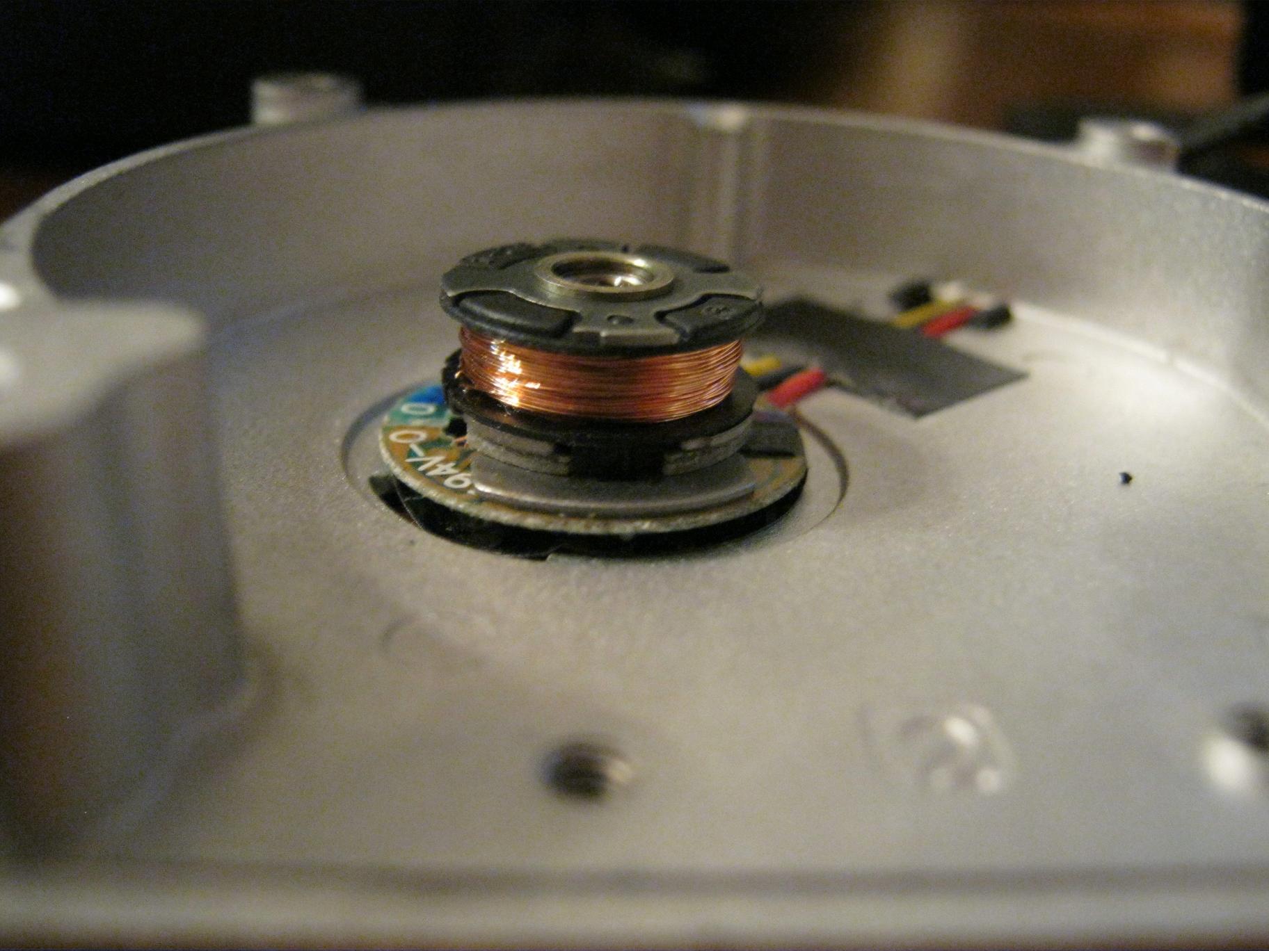

    I finally got it apart.
    This is a Sunon GB0555AFB1-8, which is supposed to be a dual ball bearing fan, but it actually has one ball bearing and a sleeve bearing without any lubricant. They did the same thing (or worse - only a sleeve bearing) to the "dual ball bearing" KD1205PHB1 fan in my parts collection. I removed its label and saw a sleeve bearing with no lubricant. That is even worse because that fan spins at 5800 RPM. I can hear that its bearings are dry.
    I want to get the circuit board out of this fan without destroying it. It looks like the board and coil are pressed into the housing.
    • lti
      • May 2011
      • 2555
      Re: Fan disassembly
      I think that the control circuit in this fan is dead. The coil is not receiving a signal of any kind. It is connected to a 6-pin chip marked N024, located under the black insulation next to the bearing in picture 2 above.
      How does this motor work with only one coil?
