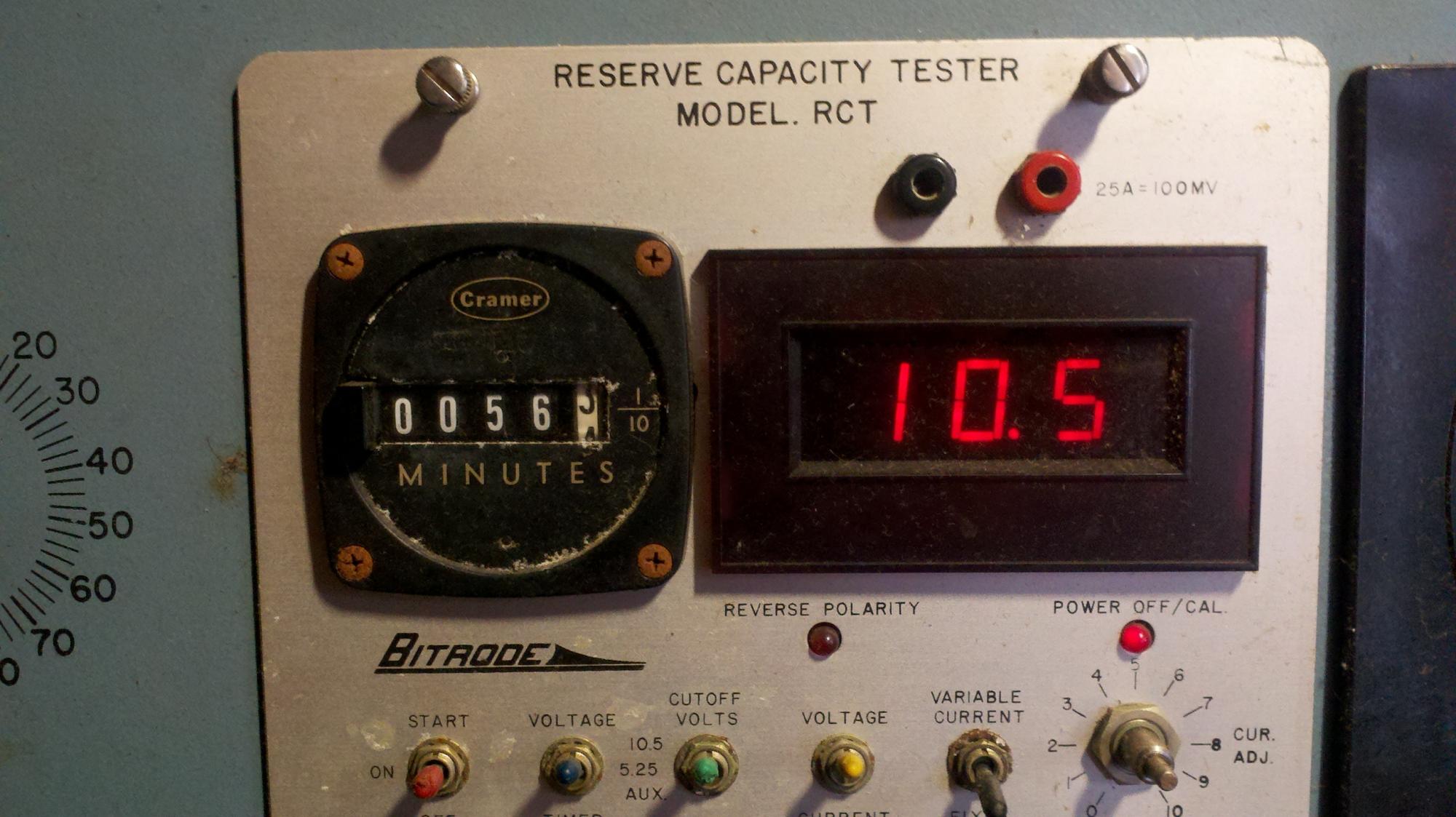

    if you have a newer gel or agm battery with no capacity try this.
    a neighbor has a small cheap handicap scooter that i suspect he has been using a dumb charger on.the onboard charger had gone bad and i repaired it.
    he bought a new battery because the less than a year old mk agm would not get him around the block.i decided to try adding a bit of distilled water thinking he gassed it away with his dumb car battery charger.
    he went to batteries plus and got robbed before asking me though.
    he once worked for exide and should have known better anyway.
    so the test surprised both of us.this is a 32ah battery and the test is a standard minutes at 25a reserve test.

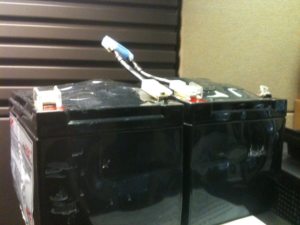

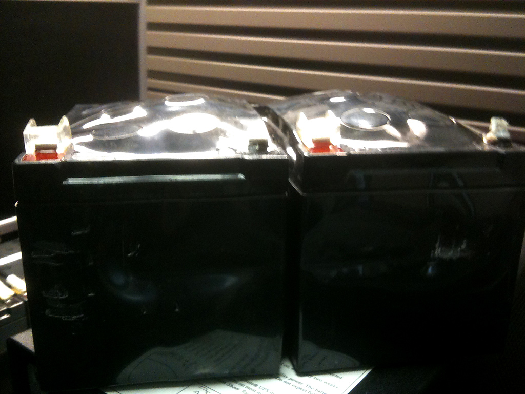

                    • smason
                      • 1652
                      Re: if you have a newer gel or agm battery with no capacity try this.
                      Hmm I'm sure I posted this about 3 hours ago. I'll try again.
                      Maybe I should try some distilled water in these.
                      Had a server and router disappear on the weekend. Sent someone out to look and they found the UPS chirping with all lights flashing and not powering anything.
                      Got it in today, and pried (literally needed 2 screwdrivers) these out:
                      36 Monitors, 3 TVs, 4 Laptops, 1 motherboard, 1 Printer, 1 iMac, 2 hard drive docks and one IP Phone repaired so far....
                        those hit thermal runaway.those are toast.pardon the pun!
