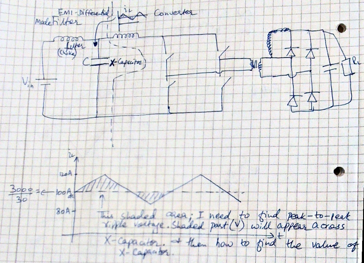

    Dear All,
    I have a question regarding the selection of value of X-Capacitors that are used in Differential Mode Filters (EMI Filters).
    I have an Isolated Full Bridge DC DC Boost Converter of 3KW for which I have do design a input Differential Mode Filter. The inductor just after the dc source has a dc current of 100A over which a 40A (peak-to-peak) inductor ac current is superimposed which means that triangular current waveform of 40A (pk-to-pk). Vi=30 V.
    I have determined the corner frequency of LC Low pass filter as 90KHz.
    My first question is how can I calculate the Peak to Peak ripple voltage(out of the above defined current waveform of inductor) which a X-Capacitor must withstand?
    Second question is what value of X-capacitor shall I choose that can withstand the amount of ripple voltage that has been calculated in the first question I asked above?
    Your suggestions and help will be highly appreciated. I have also attached a picture for your convenience.
    Thanks.

    iamakda, your question is definitely well over my head. I'm thinking that the capacitor ripple current capability might be critical as well.

      Re: Differential Mode Filter Design
      ok if we think in terms of capacitor's ripple current, then what would be the ripple current which will pass through this x-capacitor? how i can calculate this ripple current and then what value of x-capacitor should I use?

        Dear PeteS,
        Please advice how can I calculate the value of X-Capacitor from scratch in order to design a Differential Mode Filter? Just to remind you I have found the cutoff freq. of filter is as 90KHz.
        Kindly help me out as I do not have any idea about it. Guide me please.
