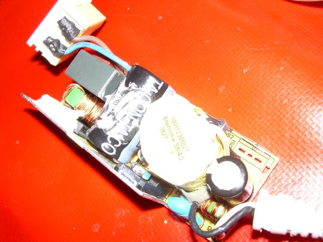

    Need datasheet for NF836
    Well, sometimes when I search for datasheets my brain shortcircuits and I give up.
    Got this NF836 B20H100G AKA made by ON Semiconductor I can't find a datasheet for - It's for a Asus 12V 3A psu.
    Anyone who can find this datasheet ?

    Re: Need datasheet for NF836
    I believe the NF836 is the manufacturer's date code. The second line is the part number. Try MBRB20H100CT. It's rated at 100V/20A
      Id agree - had the sheet but router dropped out!!!
        http://www.alldatasheet.com is pretty good at making suggestions when the exact part number can't be found.
        findchips.com is a good quick way to see who has it supply.
        If findchips.com yields no stock, then go to ebay.com.
          This one may be an updated version of the pdf:
          https://cdn.badcaps-static.com/pdfs/...bcb166c86f.pdf
            Ahh, I always thought the first line was the part number - Thanks
            I'm rather careful not to open pdf's at all datasheet pages that comes up in google - I guess some of these pages are unsafe - Will have a look at those links.
            Thanks for the datasheets guys.
