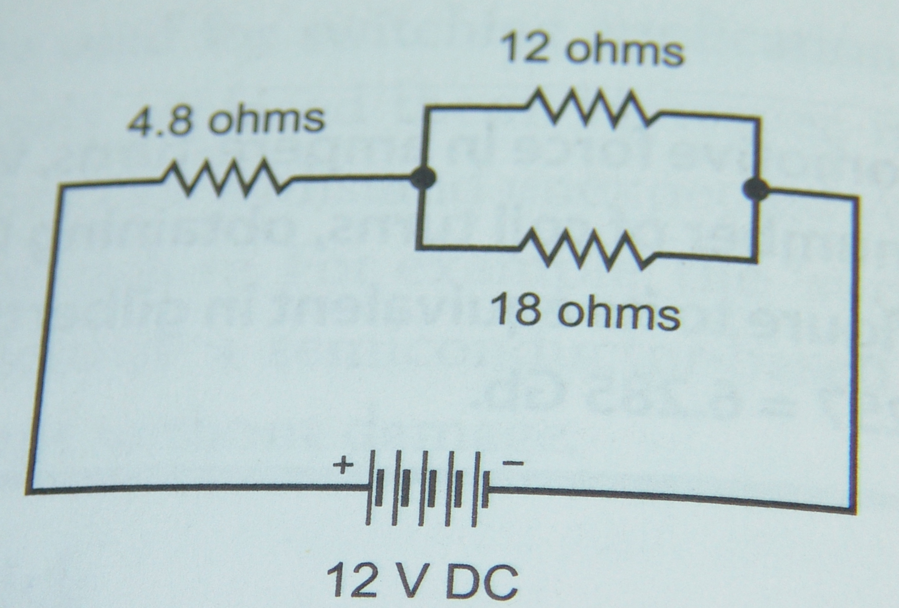

    So, I know this might seem very basic, but for some reason I'm not getting the right answer on this and I don't know what I'm doing wrong.Now I know what the right answer is, however I can't seem to come up with it. Now, I'm not going to just tell you the answer (Muuu-hahaha). I want to see what you guys come up with, and I bet you come up with the same thing I've been coming up with.
    Here is the question:
    In the picture there are 3 resistors connected to a 12v battery. Assume that all component values are mathematically exact. How much current flows threw the 4.8-ohm resistor?
    Thanks guys!!!!!

    1 amp.
    parallel resistance of the 2 others is 7.2ohms, so total resistance is 12ohms.
    [U=R*I] gives you: ----> 1 amp <----.

      Ok, how did you get 7.2?

        Nevermind.... I got it.... 12x18/(12+18)= 7.2 Ohms.

          the formula is 1/R(total) = 1/R1 + 1/R2 + ...etc
