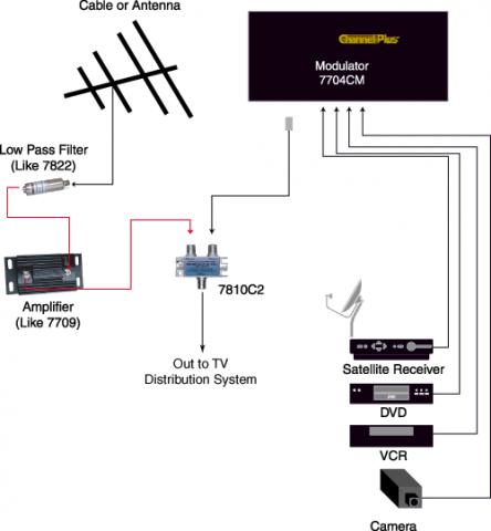

              Sounds like you need a UHF modulator (or several) to modulate each source onto its own channel (no running downstairs to push buttons). Then you split the output of the modulator to all your TVs and they can tune each source independently as its own channel. I have this setup at my house and love it. I combine the OTA antenna (DTV channels) with the output of the modulator and pipe that to each tv (currently 4 DTVs and 4 analog TVs) The digital TVs get all the OTA channels plus the 3 in-house channels (65: security camera dvr, 67: TiVo, 69: XBMC). The analog TVs only get the in-house channels. Here is a generic diagram:
                I apreciate your info but need something more like
                https://www.badcaps.net/forum/showthread.php?t=18544
                the RF coaxial switch shown above wish it had 1 or 2 more outputs because all
                the inputs are coaxial RF outputs coming from deference receivers and have to be separated otherwise they will have interferences from mostly the sat signal same Chan

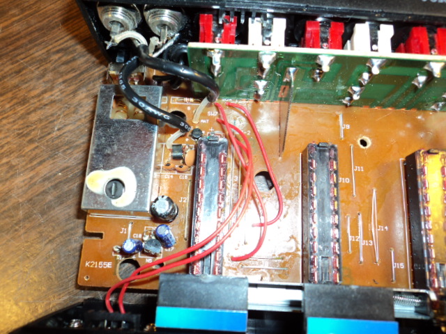

                        I thought of that i have a RCA push button video Switch with 5 outputs 1 input maybe if i modify the RCA to coaxial connectors it'll work?
                          Re: RF Switch!
                          No need to "mod" anything. Try some of these:
                          http://www.allelectronics.com/make-a...CA-MALE/1.html
                          Keep in mind that a baseband switch may not shield or isolate enough at RF. The carriers are 61.25/67.25 MHz for CH 3/4.
                          If it's something like this (metal), give those adapters a try:
                          http://www.mcmelectronics.com/product/50-6180
                          I'd personally make something out of a Hammond aluminum box, some F connectors, and a decent switch. A proper RF switch, with good characteristics (insertion loss, isolation, return loss) is more expen$ive for a reason.

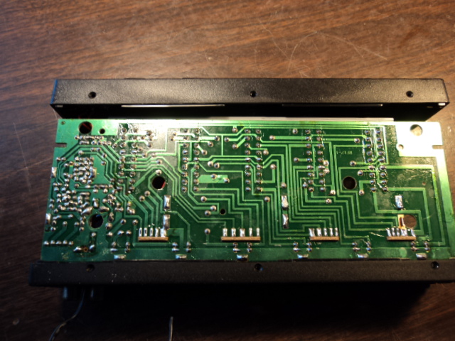

                                Re: RF Switch!
                                That's what I said in another later post.
                                You'll only need some of the video wires.
                                You could just make you own from scratch too.
                                If you get noise/static just put a filter on the output jack.
                                Mann-Made Global Warming.
                                - Dr Seuss
                                  Re: RF Switch!
                                  I hoked it up and and connected 2 inputs and i had i lousy pic with crossover and weak signal, i have a clean pic just by inputting cable by cable individual so i will keep doing it unless there is a better way,
                                  the Modulator and the schematic shown in the in the other prier post sound good if i can get a clean pic on all Chan output,remember my TVs in all the rooms that i want to feed are all analog i have 8 of them.

                                      Re: RF Switch!
                                      today i dicovered that this video switch also does Rf conversion,i though it did not work i was using a rf converter connected to it.
                                        Re: RF Switch!
