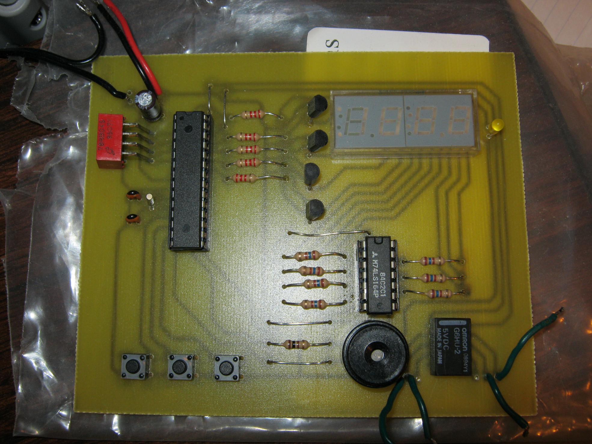

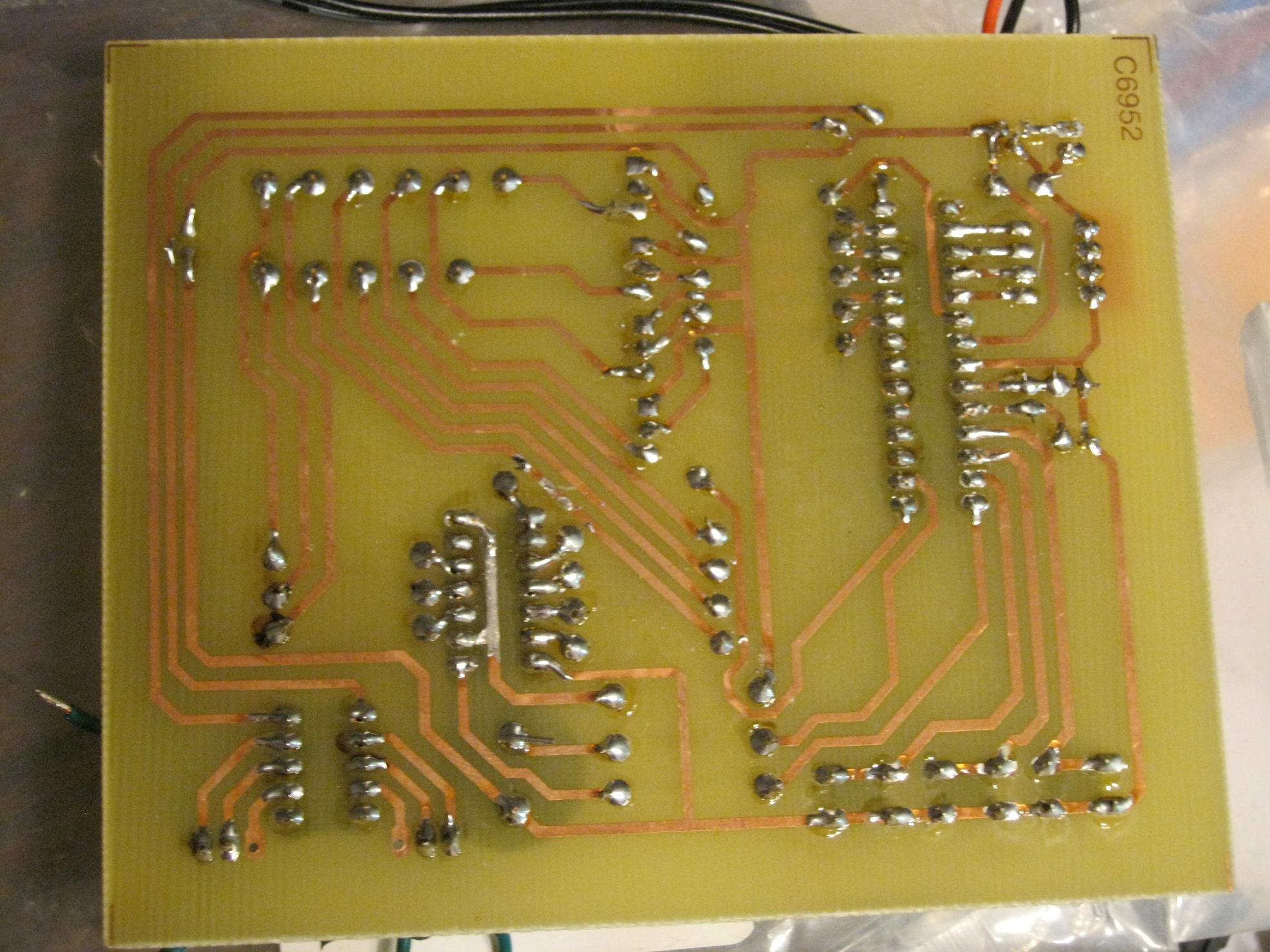

    Relay on alarm clock board does not close
    I have a Chaney Electronics/Electronic Goldmine C6952 alarm clock/timer, which has an Omron G6HU-2 relay that can be used to switch power on or off to another device when the alarm goes off. The microcontroller does not energize the coil long enough to latch the relay contacts closed. Is there any way to keep the coil energized for a longer period of time? I can make the relay latch and reset using a battery pack. The board uses an ATMEGA48-20PU microcontroller.

      I just saw your reply.
      This is actually a clock kit. It does use a latching relay and the microcontroller sends a pulse to the relay, but the pulse is not long enough to make the relay latch on. Both of the pins connected to the coil are connected to the microcontroller.

          Re: Relay on alarm clock board does not close
          Like I said above, the IC is a preprogrammed ATMEGA48-20PU. Since it uses a latching relay, a pulse is sent across the coil to make the relay contacts close and a pulse is sent in the opposite polarity to make the contacts open.
                      The markings match what the kit showed in the parts list. The microcontroller is able to unlatch the relay, and the relay can be latched using three dead AAA batteries. The entire board is powered by a 7805 that produces 4.90V. The kit came with a 78L05, but I didn't like how hot it ran. The regulator is soldered to the red and black wires on the corner of the board.
