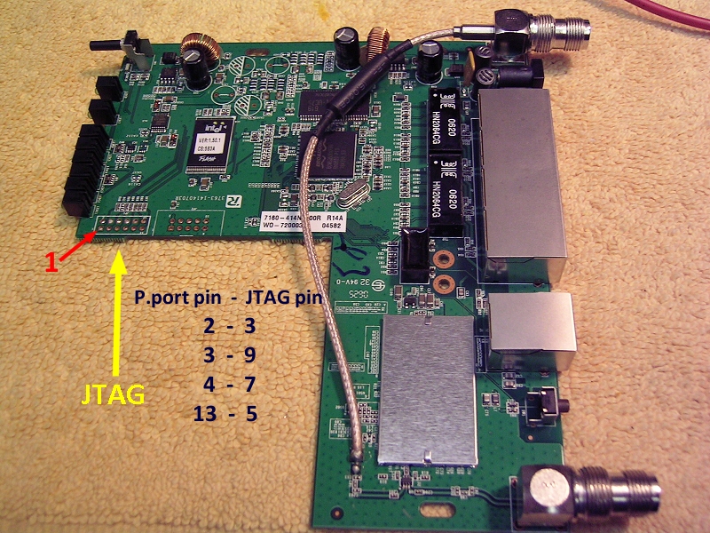

            • kc8adu
              • Nov 2003
              • 8832
              • U.S.A!
              Re: Linksys WRT54GS v.6 - Wholeflash needed
              where are the jtag points on a v6?
              got a bricked one at the shop to do when things slow down.

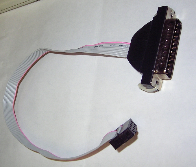

              • Toasty
                • Jul 2007
                • 4171
                JTAG header is right behind the "Internet" LED at the front. I pulled the pins off a dead mobo somewhere. Only had 10 pins, but that's all I needed when I made the franken-adapter from an old mobo serial ribbon cable to DB25 connector. Cable must be short to avoid noise. Whole contraption is 8" long.
                See attached pic.
                EDIT: Additional Info
                Serial: CGN91F85....
                Chip is: Broadcom BCM5352EKFBG
                Flash is:
                (a) White Label - VER:1.50.1 / CS5B3A
                (b) Chip markings - JS28F160 / C3BD70 / A6177448
