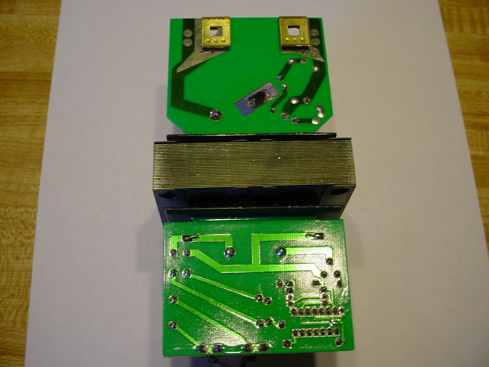

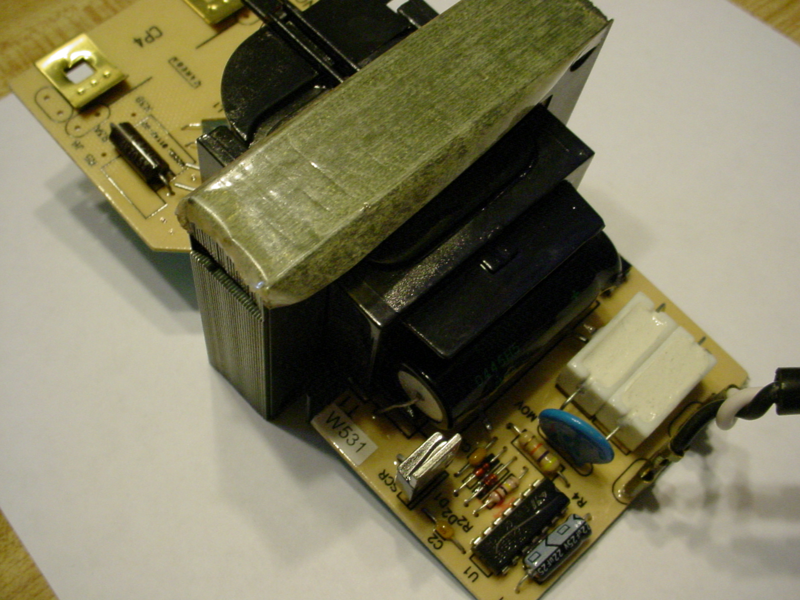

    After a verrrry hard lighting strike, my fence charger was the only thing not working. It's a Zareba, model A20ML. The lighting killed the neutral side of the 120v outlet and took out the 750ohm 5w resistor that is inline with the 120v power supply circuit. (the little white bricks in the photo). Replaced both resistors (and the outlet) and it's back working good as ever, keeping my horses safely tucked in the field.

    I would replace the MOV (blue disc) also. That probably fired and popped the resistor. Every time that MOV "works" it looses some of its ability to protect.

      That MOV has not one marking on it. What part does it play in the circuit?

        But again, with no markings, how would I get a replacement part? Anyway to check the ability of this MOV for voltage protection?

          The markings are there, just may be -very- light and require a microscope (lol) to see. I've reverted to a jeweler's loupe and magnifying glasses for these.
          Its part in the circuit is to do exactly what it did, clamps down the voltage spike and in this case opened the circuit. It -is- right across those resistors.
          Do you have the original resistors? I thought that they would be the fusible type instead of just regular ceramics.

            I've got the original ones. They are marked, RCD PW54WW 750R J V9-381.
            I looked on the MOV with a magnifying glass, no mark, no impressions, nothing. I never could find a schematic on this board.

                I appreciate all the help. It only takes a few minutes to get to this board. It's worth taking out that MOV and checking it.

                      You were right again. I took it apart again and with a very bright light and an extra strong magnifying glass, found SAS 241 KD14 MOV. Of course, could't find local, but one is on the way. They dunked this PCB in varinish about 10 times I guess, it makes seeing and checking components difficult.

                        The "varnish" is a conformal coating because these are typically outdoors where moisture and electricity don't mix well. See post #9 above.....
