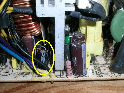

    Jonny Guru + Caps
    Well what happened here?
    http://www.jonnyguru.com/modules.php...ory4&ndar_id=8

    my first guess would be too low ESR (or too high? well probably not.. but certainly not the same as those fuhjyyus and capxons)

      Re: Jonny Guru + Caps
      I know this was discussed either here or on Jonnyguru's forums before.
      I have not looked up the specs of the capacitors used but it would be my guess that they ventured too far from the originals specifications.
      The capacitors and inductors in a PSU form a filter, so called "Pi Filter".
      Thus the capacitors and the inductors (which is what the Pi Filter is) must be matched.
      So ESR, Ripple and Capacitance is choosen according to the size of the inductors...

        I was always of the opinion that something else had changed when JG did that. My reason was, the waveforms are really whacked compared to the originals.
        I could understand/agree with the change in ESR causing the screwy waveforms, -if- the waveforms looked like the originals, only "bigger". These look like something is inducing interference into the signal. Like a bad scope probe or frayed (or too long) ground braid...?
        He does say that the testing was done "in two phases several weeks apart"...?
        I've used all FM's to recap units and not had that kind of result. [Antec]
        I will try using HZ's when I get a unit I think deserves them , just to see.
        Could this be more due to poor(ly made) inductors than caps?
        Need a plug-n-play PSU with a selection of components to swap in and out to really be sure.
          Per Hansson's got it right.
          - And now you have an example via o'scope of why I harp on matching specs.
          It's on page 1.
          He (it was Oklahoma Wolf) used KZE and KY which aren't even close to the ESR/Ripple of some of the original caps.
          He didn't even check the specs on the old ones. [I asked him.]
          He just went with Jap caps...
          - - And in the process changed the frequency response of the pi circuits.
          Note that it was done 4 years ago.
          What he did was standard practice 4 years ago. (Every place except BCN that is.)
          It's STILL standard practice/advice in most places.
            KZE and KY vs. fuhjyyu TMR and TNR and Capxon KF (from what i can see)
                UCC is not a crappy brand, they make great caps.
                Just because they have been bitten by a bad series (KZG) does not mean they do not make good caps.
                Hell if we stopped using caps from manufacturers that have never created duds we would have an extremely limited supply!

                  I agree with Toast, looks like extraneous interference on the scope. Bad ground or probe.
                    Read the article in detail and you will see he states he does not have a ESR meter so he has no clue if the caps he put in are good (yes even new ones can be bad). My first guess would be a bad cap got put in.
                        TM = TMR
                        TN = TNR
                        The R is a marketing thing.
                        I think it may mean custom ordered size.
                        The TMR 4700uF/10v that came out of the TP-II(s) I did were 10mm x 40mm I think.
                        Maybe it was 10x35mm, but anyway, the actual size was longer than the data sheet.
                        [Same with the 3300uF/16v.]
