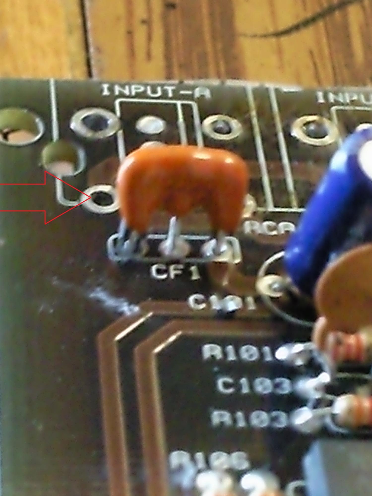

identify this part
    identify this part

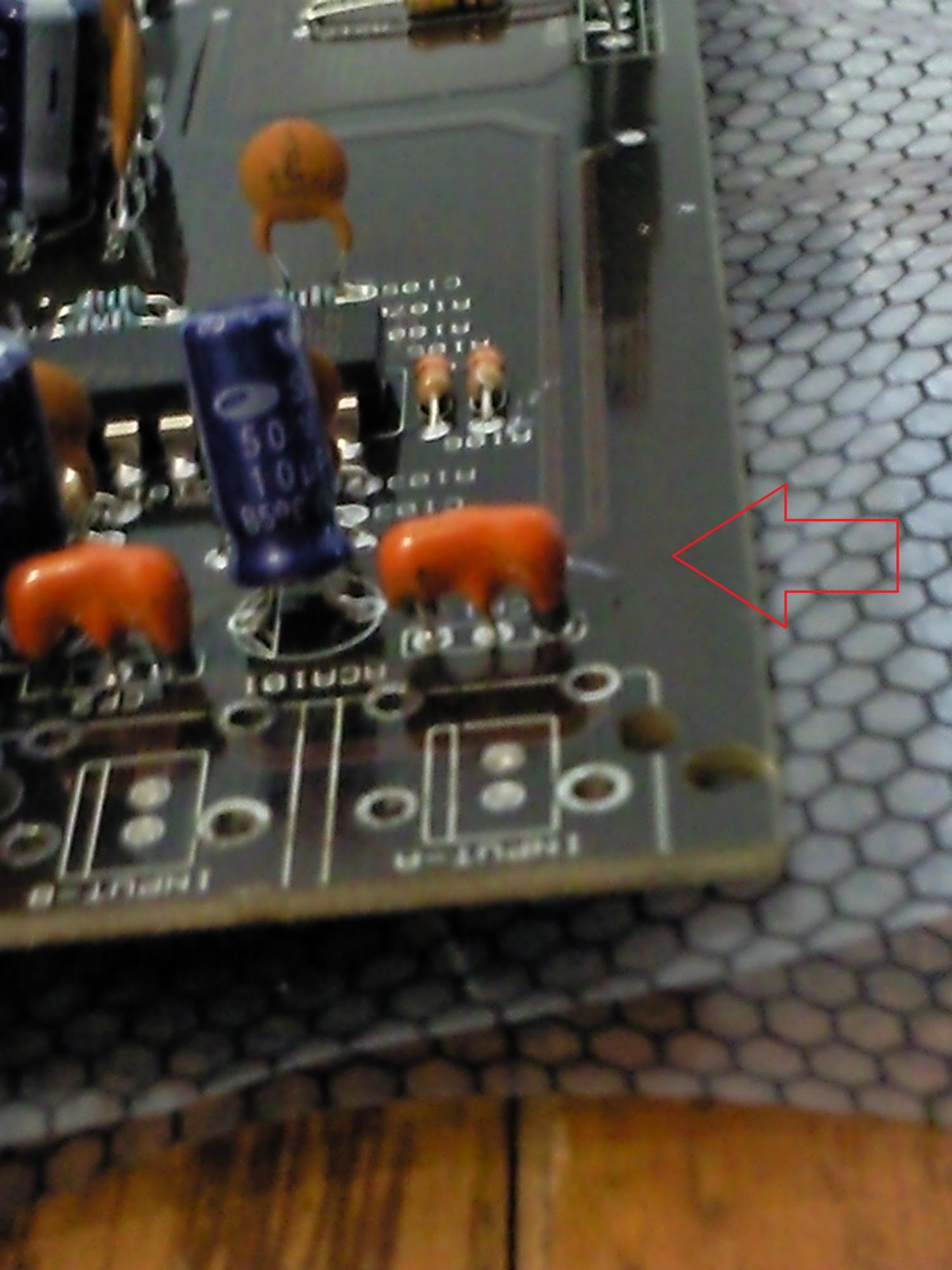

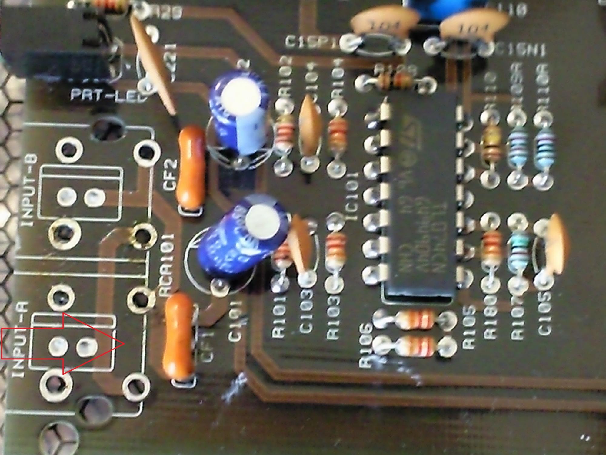

    part has red arrow pointing to it, came off of a car audio amplifier "american bass vfl 100.1"
    the only writing on the orange part is "2220 A 10" and it is located behind the RCA inputs (which i took out)

    i am led to believe it is a "capacitor array" or a "network capacitor" although i could be entirely wrong.
      Re: identify this part
      Either T-network varistor to protect semiconductors and filter signals (two ferrite beads) or capacitor network (again, two beads (in and out) with capacitor in between beads and grounded.

            i have determined when i switched multimeter to ohms 200 and read the outer legs it measured .4 ohm on 200 setting.
              as Jack Crow said in the other thread, they're most likely ceramic filters.
              you could bypass them (short the outer two pins together, leave the middle one out) but as long as they don't short to ground they should be okay.
              as for the RCA jacks, you could shoehorn in any kind of RCA jack.

                Maybe it's just a EMI filter component like
                http://cn.mouser.com/Murata/EMI-RFI-...Z194jjZ1yznaz0
                  Just like Duncanbest had indicated, just a low value EMIF CERAMIC CAP FILTER. You can remove it and the unit will still function, it is used o help reduce RF interfererance like fom AM transmittter that some time you can hear the radio station from the audio amplifier.
