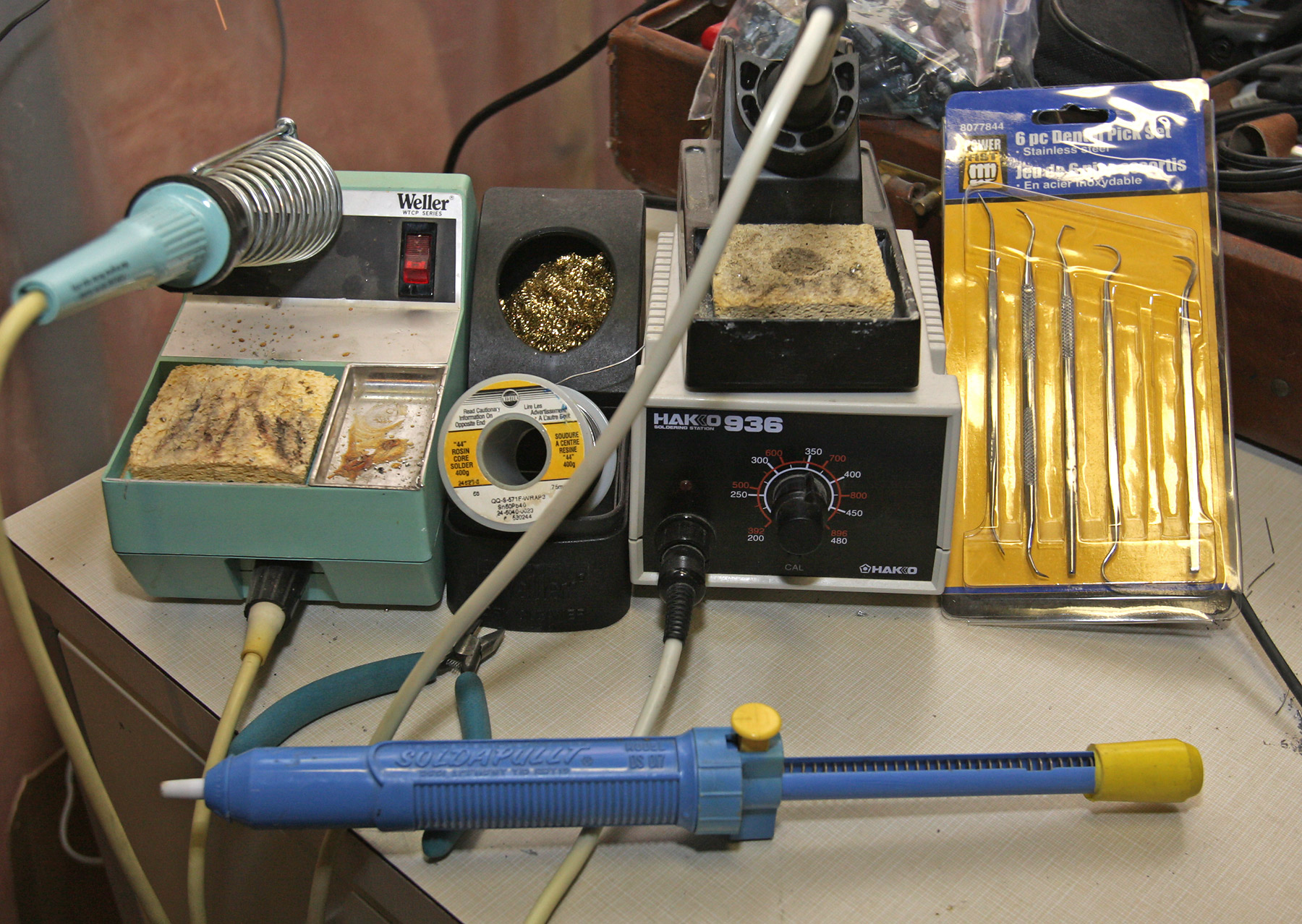

              I use a Hakko 936 and an old 1978ish Weller WTCP, both work really well.
              I don't think you can go wrong with either brand. That said there's a thread here in the test equp forum where several people recommend a cheap Chinese unit that seems to work for them.
              Desoldering: I use a standard blue Soldapullt pump tool I've had since the 80s. I think I've changed the tip 3 times. I clean it now and then, and some vaseline around the O-ring really keeps the suction strong (insert inappropriate joke here)
              It's been very reliable.
              I've never liked braid, but it does work well for SMT stuff.
              I JUST switched to a dry tip cleaner this weel (added the $18 Weller unit to a cap order from Digikey) man I wish I tried one sooner. Love it! Here in ALberta it's so dry you spend half your time wetting sponges...
              Flux - I only use it for tricky desoldering (multi layer boards) or SMT stuff.
              Solder. I have a big roll of Kester 60/40 I bought a long time ago and it'll probably still have some on it when I'm dead. On that note, they can take my leaded solder when they pry it from my cold dead fingers.
              All you really need to get started (in my opinion) a decent soldering station, a desoldering pump. Decent side cutters (small) A can of Flux cleaner, an old toothbrush, maybe some dental picks, half a brain, and some practice.

                Still working on the half a brain and practice part. I do appreciate the picture there of the work tools.
                And the commentary on the hakko 888 model has put me at ease a bit. The 936 while I've been watching over the last 2-3 months while I work out other stuff has ran out of stock at multiple locations, and is increasing it's price on the remaining places. So at least I know I can wait and get the Hakko 888 without worrying.
                I probably need to look into getting a digital multimeter as well in the future, but gotta try to keep it within reason on the rest of things right now. Probably wait till after tax season is over with and figure out where I stand then before I buy anything.
                But I really do appreciate all the comments, and if anyone has any recommendations on anything I am more than willing to hear them.
                At this point I figure I'll be buying:
                Hakko 888 unless I can find a killer deal on a 936, which is looking less than likely.
                Not sure what the standard tip on the 888 is, so I'll probably get a longish conical tip and a chisel since a lot of people keep mentioning the chisel for holding heat.
                A solder pump.
                Kester 60/40 solder since I've seen it mentioned twice. Once I get better I might consider getting the higher quality stuff to have options.
                Tip cleaner, the wire mesh stuff.
                Already got some side cutters I think will work out OK. If I find out otherwise not a huge ordeal to fix.
                Flux .......maybe to mess around with a bit and try to re-solder on caps I remove just to see how screwed up it gets on broken boards. Can't test it to see if it still works, but can see what happens when you do things wrong.
                Probably wait on the dental picks until I see how the solder sucker works out.
                Clamps and holders will probably have to wait until I see how everything goes.
                Heatguns and all the other stuff, I'll guess Ill have to wait and see if I think they would help me or not.
                That seem like a fair enough appraisal of the situation over all in terms of what I should get starting out and keep the rest at the back of my mind?

                    If I'm not mistaken, badcaps recommendation of a 60w iron was strenuously suggested.
                    My question, would a 40w iron be enough or should I take badcaps opinion?
                    • yyonline
                      • Jul 2009
                      • 692
                      Re: Starting out, inexperienced solderer.
                      As long as you have a temperature controlled iron, you can't have too many watts. My Hakko 937 (936 with a rather pointless LED display, but hey I got it cheap) is 50 watts, and it's plenty for most applications. However, for motherboard work, it's merely adequate. Some boards have lots of copper and take quite awhile to heat up to the point where you can melt solder through the holes.
                      You can get by with less, but having good tools makes the job much less frustrating, especially for a beginner.
                      • buz
                        quietguy
                        • 73
                        Thank you yyonline - I'm a total novice, gonna attempt a PSU and need to gather up the basic tools. I don't know if I'll ever do it again but who knows. So it sounds to me more wattage is better (to a point). Reason for asking is there's a 40w I can pick up locally (local building supply) but if a 50w or 60w would make the job easier for a noob then I better shop.
                        • Agent24
                          I see dead caps
                          • Oct 2007
                          • 5085
                          • New Zealand
                          You won't need anything special for a PSU unless it's one of the new high-powered ones with a double-layer board and a lot of stuff jammed in and a huge ground plane..
                          For any standard PSU with a single layer board any standard iron will work, as long as you use it properly - see: http://store.curiousinventor.com/guides/How_to_Solder/
                          For single layer boards I've used a basic 25 watt Scope iron for many years.
                          -David VanHorn
                          • bigbeark
                            • Jan 2010
                            • 661
                            My suggestions:
                            Get the Hakko 888. I have the 936 and it works fine. The new model has more power and that's good. When soldering motherboards, I generally have the 936 at or near the highest setting.
                            Older motherboards have heavy copper traces and really soak up the heat.
                            The solder on old boards flows nicely though.
                            Newish boards have horrible lead-free solder that is hard to melt. You have to add new solder (or flux) to the old on these things to get the old caps out. You need heat.
                            I have two $20 50-watt no-name irons, but they are crap - the lifespan is about 6 months before they burn out.
                            I use the chisel tip. Important - NEVER clean the tip with abrasive material
                            like sandpaper or steel wool. You will rub off the coating and the underlying copper tarnishes constantly.
                            I have the brass-wire Hakko cleaner, never use it. I have a small tin of HAKKO liquid tip cleaner which works really well. Mail-ordered both from a vendor is Los Vegas! Good proce and very good service.
                            Most important of all is PATIENCE in removing old caps! If the cap seems hard to budge, DO NOT YANK on it. Apply more solder/flux until the cap GLIDES out of the hole.
                            I used to use solder-suckers, now I exclusively use the "pin" method to install new caps. I place the tip of the iron against the hole and push the pin through from the other side. If I keep the pin moving it doesn't stick. I found a nice headed pin in the wife's sewing basket. I later bought an assortment off Ebay for $3 - lifetime supply.
                            I used my solder sucker continuously for a year, never gave any problems. If you buy one it should have a metal body. I bought one off Ebay, it came with some lead-free solder that wasn't bad at all. I went to the pin because it's a faster method and doesn't suck all the solder off the board.
                            MOST IMPORTANt IS TO HAVE A WAY OF HOLDING THE BOARD. You need two hands to remove ans intall caps. I built a simple wooden frame of 1x2 spruce strapping. I attach the motherboard to the frame with short woodscrews, and then clamp the frame to my work table with a woodworkers spring clamp.I do the removal and initial install of the new caps with the board held vertical so both sides are accessible. Then I remove the clamp, turn the board over so the soldetred joints are facing upward and go over each joint. I then trim the cap legs so they are 1/8 inch or less in length.
                            Use an old Pentium 2, Pentium 3 or Socket A board as your learning piece. You want a working board for which you have a CPU, heatsink, some ram, a video card and a little speaker that connects to the SPKR pins on your motherboard. Hook up a power supply and start the board by putting a screwdriver blade accross the PWR pins on the motherboard. The board should POST as indicated by the beeps from the little speaker.
                            Try removing and replacing the bigger caps and verify that the board still POSTs. Go over your joints if it doesn't. When you can remove and replace caps and the board still works, you are ready to move on to motre modern boards.
                            • buz
                              quietguy
                              • 73
                              Thank you Agent24. That was enough for me to decide on what to get. Found a second video there that regarded how different wattages fare working different materials/components:
                              http://store.curiousinventor.com/gui...er/select_iron
                              Edit: Thank you Bigbeark - lots of good info too.
                              • Agent24
                                I see dead caps
                                • Oct 2007
                                • 5085
                                • New Zealand
                                To start off with a standard iron would be OK, if you want to do advanced stuff get something better later on.
                                The basic iron will still be useful to you most likely for other things though.
                                I have two of the MH25 http://www.warrenandbrown.com.au/Pre...t&ProductId=37
                                They are cheap and basic but not junk. The ones I have are about 7-8 years old and still work perfectly.
                                -David VanHorn
