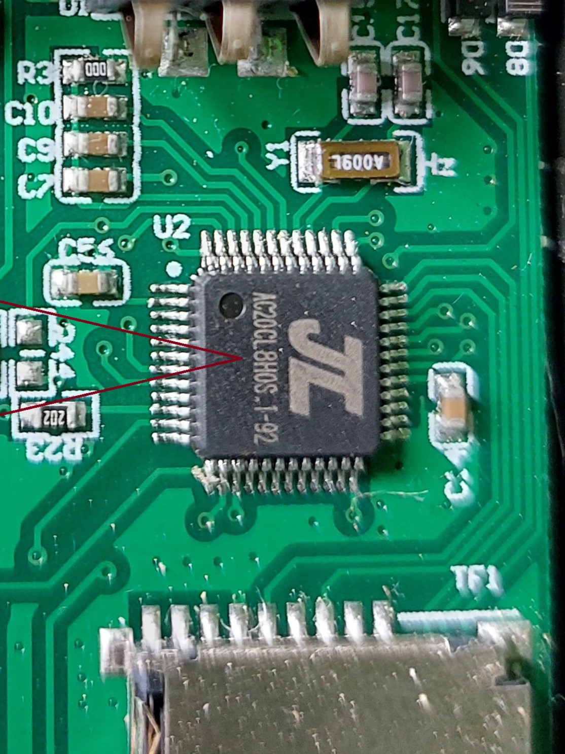

    Can some one help me for this smd chip U2
    It is Marked AC20CL8H0S 1-92
    But i cant find any data sheet for this chip
    I need to know what is the Part number and where can I find to buy ?
    Photo attached
  • R_J
    • Jun 2012
    • 9610
    Re: Identify SMD CHIP
    Search jl semiconductor, it seems to be a Bluetooth ic , likely custom programed
    Similar looking ic is the AC6921A LFQP48.
