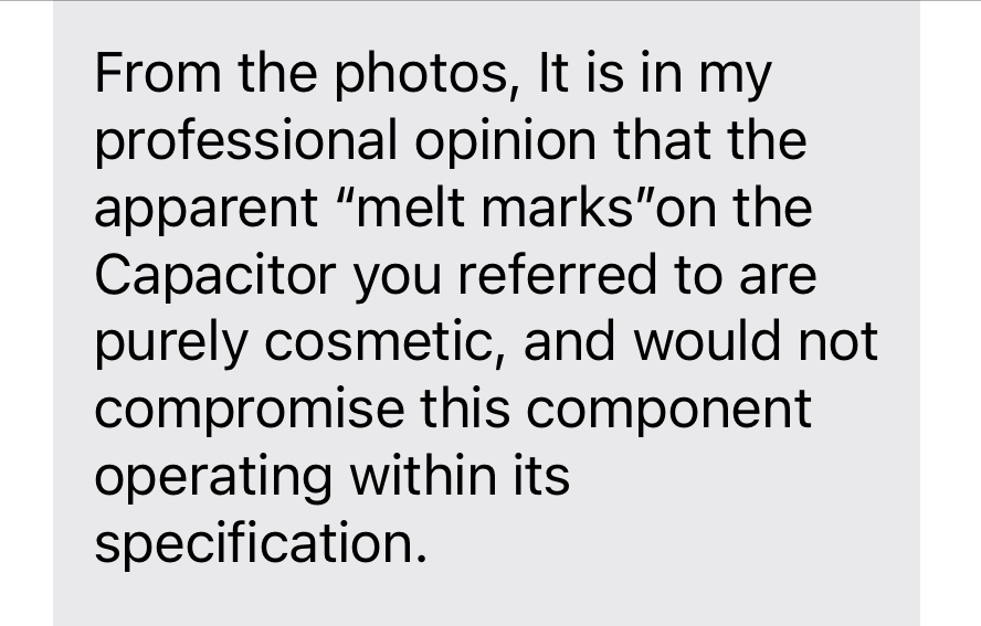

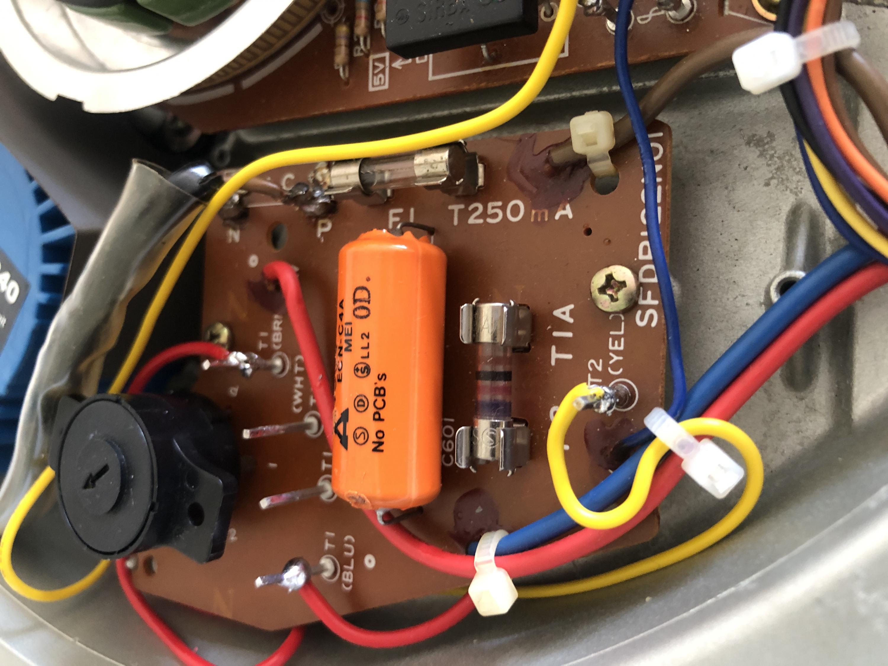

    A technician (with his soldering iron) hit the original Oil & Paper capacitor in the power supply of my Technics 1200 mk2 Turntable. It looks like a snubbing circuit capacitor/noise suppression? rated 0.047uF 450V, Orange Panasonic most likely from the 80's.
    His response was it is just cosmetic and there is nothing to worry about. However, I'm not filled with confidence as it is in the AC power section....
    Can anyone help me out and can confirm its safe? He hasn't tested it, so I'm not sure how he would 100% know. I am nervous it could fail at some stage.
    Please see images

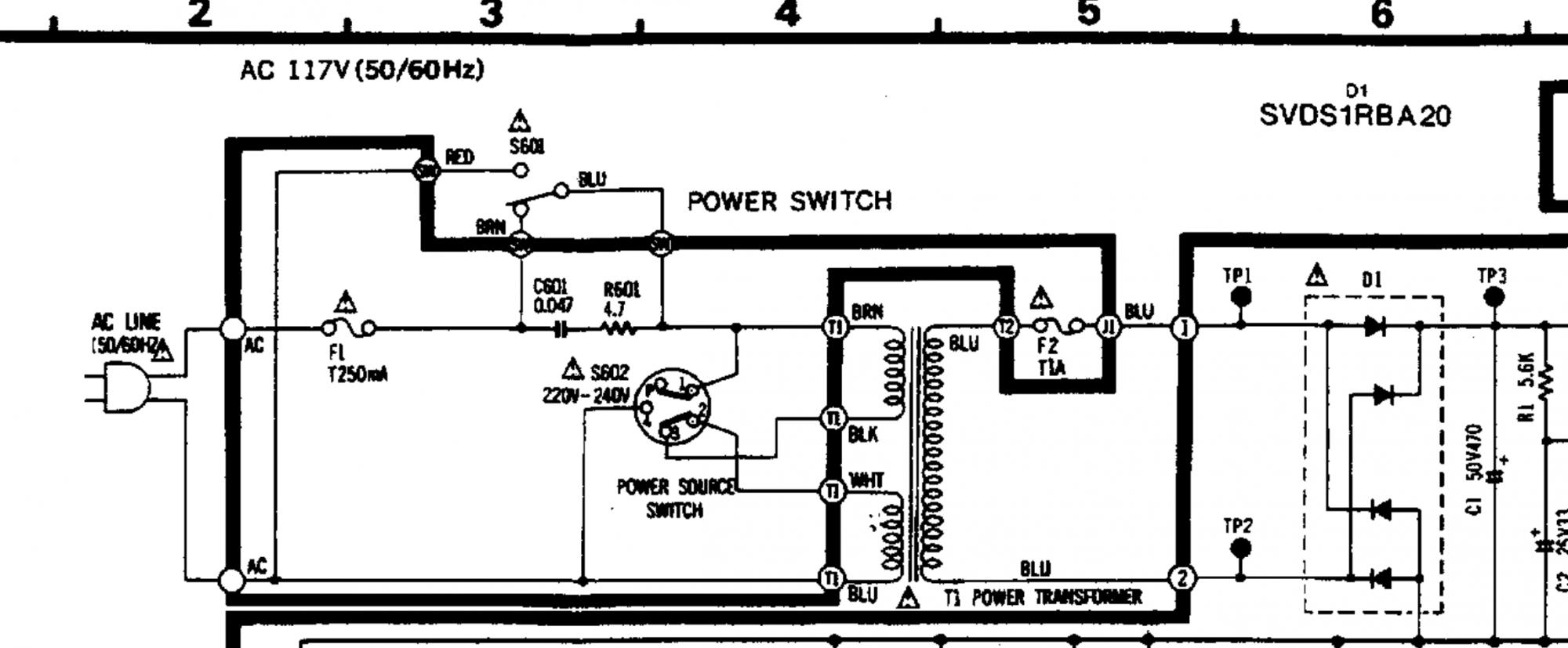

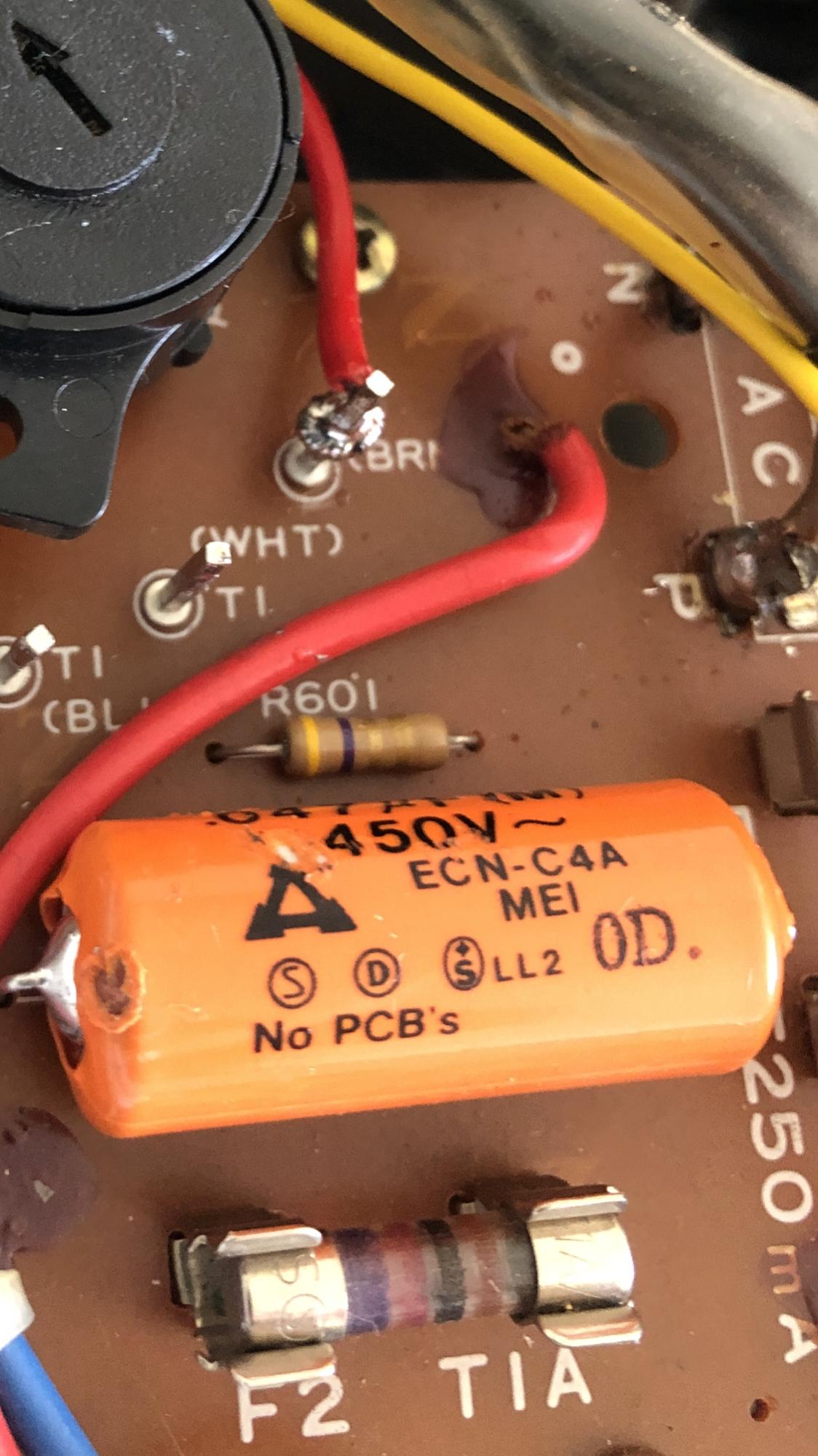

    That cap is across the power switch, to lessen arcing and loud pops in loudspeakers.
    So if it fails short-circuit, the TT just stays on. And there is a fuse too.
    It's not an electrolytic - so hydrogen generation and kaboomski not going to happen.
    It's not directly across mains like modern SMPS equipment, a Rifa kind of situation where there is lots of energy available and unsafe results.
    If it really bugs you, just put in a modern PP safety film cap. That's what I did on a few old TT's when I recap them.
    I know the old Marcon oil caps do go low value, and usually fail short in oscilloscope HV sections, but no mess or anything.

      i would ne more concerned over the poor wiring for example the soldered wire wrap pin etc.

        Thanks for your knowledge. So, ok great so it's like a suppression safety capacitor, that is very helpful. I did see this category of capacitors when looking for a replacement on elements14.
        I would just like to add that the Technics 1200 mk2 is quite unusual for a vintage turntable as the signal path is completely isolated from the main board or any other electronics. The tonearm from the stylus tip to the RCA outs are completely decoupled. So I assume it is more of a safety suppression cap and voltage transients, as you mentioned for a replacement. Please see a small section of the schematic in question.
        I ended up getting a snubbing capacitor yesterday, maybe the wrong choice.... but I think it would work, no? Possibly a little overkill hehe.
        Here in Australia mains are 240V 50Hz
        CORNELL DUBILIER 940C20S47K-F
        940C Series
        Double Metallized PP
        47000pF
        Snubber
        630VAC / 2kV VDC
        dv/dt Rating 1.712kV/µs
        RMS current 5.2A

          Petehall, Now that I look again, you might be right. The original had far more wraps around the terminal..... Solder breaks loose and yeah, I am Djing with my hair on fire! Literally :-/

                        caps that take on moisture are paper ones.
                        either ancient wax coated ones from valve equipment, or the infamous epoxy cased RIFA caps.
                        i'm pretty sure the one in your deck is not paper - probably polypropylene.
                          • 31086
                          Re: Potentially Dangerous Vintage Capacitor?
                          just looked it up.
                          not saying it's true, but some audiophile dick says that series is "paper in oil in ceramic tube"
                          so if it's got a ceramic case under the sleeve your o.k.
                          it's a +/- 20% rated cap so nothing special - although the audiophools think they are worth silly money!
