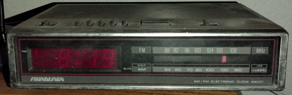

        I think this clock has the most power on hours of the ones I have now and still being used, not sure how old this thing is but it still works fine, don't think it even has battery backup. It uses line frequency as timebase.
        I am thinking about retiring it however, or at least moving it elsewhere...
        Its radio is awful btw. I'm a PLL snob these days

          I also have a sears branded cassette clock stereo radio whose radio is a bit better than the shitty soundesign radio, which also likewise is still working. Has about the same size LED clock display, but I didn't own or use this clock/radio for quite as long as the soundesign. However it has a 1983 date code on it, so this thing is demonstrably almost 40 years old now. I figure the soundesign is probably around the same age, they have similar user interfaces but designs are somewhat different.

            Soundesign came in as well.
            90% of the problems were bad soldering or mechanical with cassette transports, ghetto blasters with blown speakers etc.
            I don't need hi-fi waking me up, as long as the radio isn't distorted audio which was a big problem - the power amp Class AB was either biased too low (crossover distortion) or biased too high (heat and humming) so we had to change a resistor and fart around.
            These old alarm clocks, get AM/PM right, ALM ON and you can tap snooze bar to turn on the radio and see if it's on station and volume OK. Not that hard.
