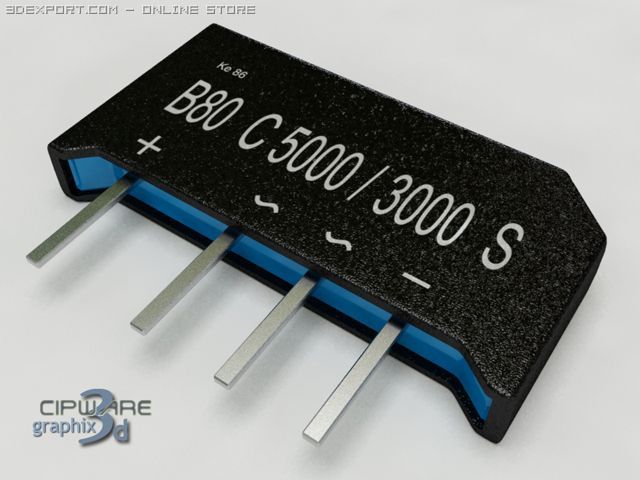

    Hi all can you test a bridge rectifier without putting mains voltage through it ?
    I have a dell 177 that had blown a fuse put in new one and it has blown again but also has blown a chunk out of the thermistor.
    I did an audible cont test on the bridge pins and found i think a short as i have tested others same way but found no short on known good ones (when i say short i mean am getting continuity between 2 of the pins)
    Am i right in what i am thinking or does anyone know a better way ,
    thanks in advance

    Use the diode test function found on most multimeters. The two inner legs should be for AC. The outer leg that is below the corner with the notch missing is usually positive. Should only conduct from the AC legs to the outer legs.

        This component attatched here is also a bridge rectifier. It's internal circuitry is in my the previous post. Observe the markings on the side of it. the (+) will be the positive DC voltage output. The (-) will be the DC ground. The two pins in the middle both have the same symbol (~). This is the sine wave symbol and it's used for the AC input.
        If I thought this part was failing, I'd desolder it and test it out of circuit. Obviously, be aware of it's in circuit orientation - very important.

          Measured as pin + 1 ~2 ~3 -4
          Red probe on + 2=1 3=1 4=1
          Red probe on 2 3=667 4=001 +1=594
          Red probe on 3 4=1 +1=597 2=1
          Red probe on 4 +1=597 2=001 3=665
          But am getting continuity bleep between pins 2 and 4
          If this makes sense

              Well the 001 you get between 2 and 4 and between 4 and 2 indicates the same thing as the continuity beep - the bridge is shorted.
              Diodes only conduct in one direction. If after getting a reading on a diode you swap the leads around and find your meter reading anything else than "over", the diode is bad, or there is another component in the circuit that influences the reading. That's why you always test diodes with one lead lifted from the circuit.

                Treat it like 4 diodes. Use the supplied diagram for which pin is which (Anode - Cathode). One way of one diode should conduct and the other way should not. Test all 4 diodes and see what you got. If any should conduct in both directions, failed test.

                  Thanks guys for all the info and help i have solved it ,
                  took out the bridge and still had same results dug around in my spare boards box and found one the same and it had same thermistor .
                  Took these off tested ok so thought nothing to lose so soldered them in and hey presto all working and yes before you say it i know i am going to order new parts.
