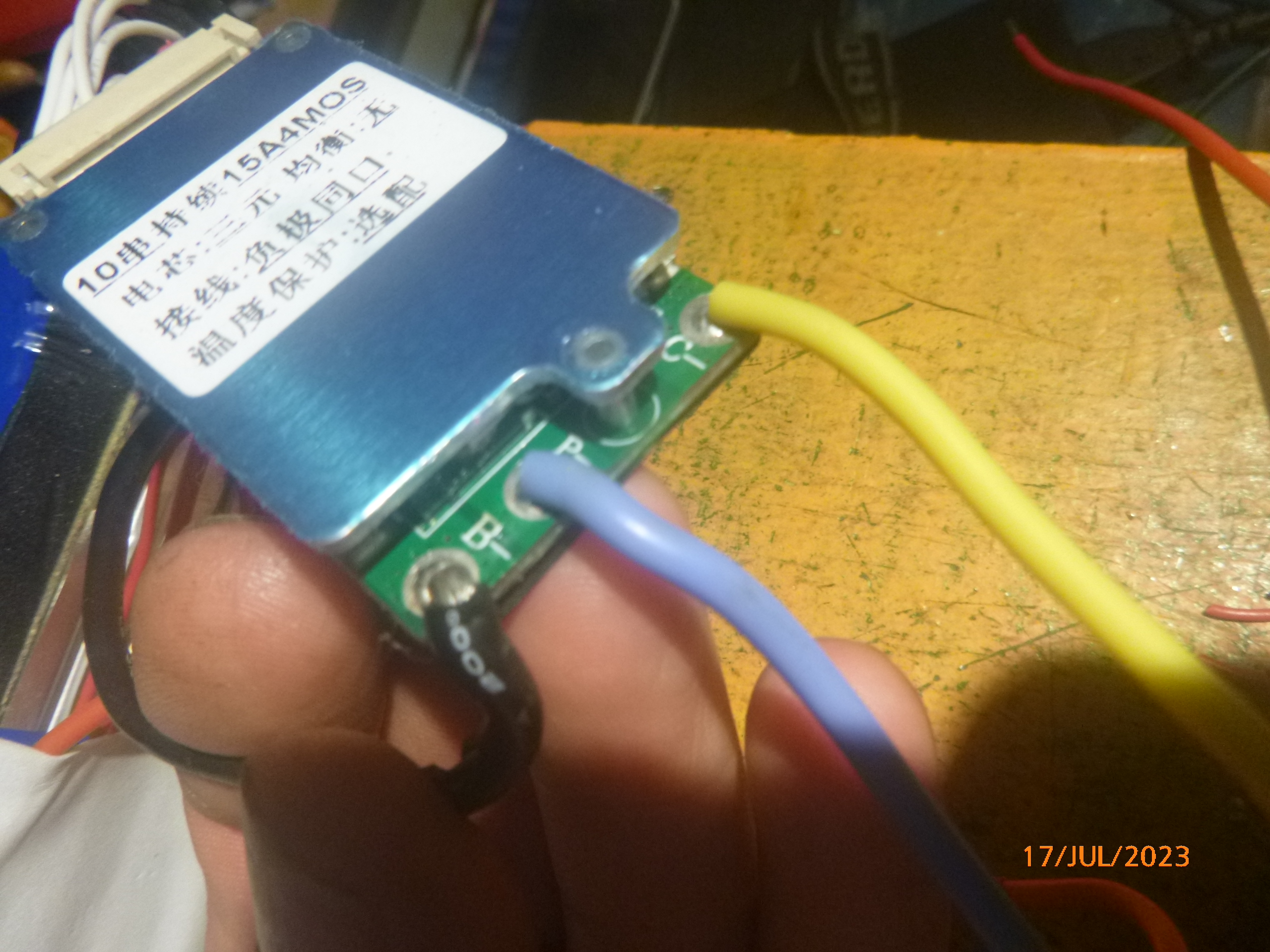

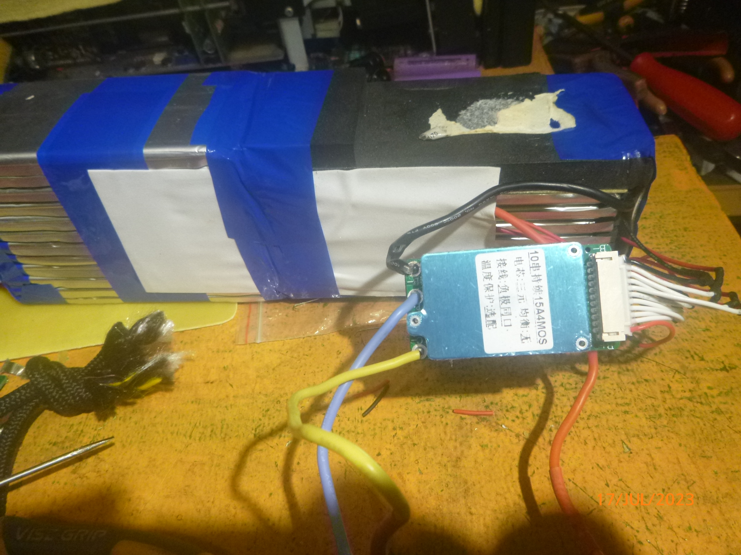

    Seeking a break from dodgy Chinese welders, I thought I'd get on with something else more straightforward... Boy was I wrong!
    A friend gave me his e-bike battery and charger to have a look at.
    It's a 36v 15a 10 cell system which has a 42v charger.
    The charger is the type which shows a red LED whilst charging and a green when charged. The charger was displaying only green.
    Measuring the battery voltage on the output read 36v. Only when any kind of load was connected, the voltage dropped to zero.
    Opening the unit up, bypassing the BMS and connecting a 120v lamp to the batteries revealed that the batteries held a charge nicely, so I ordered a 'compatible' replacement BMS. Only problem being is that the Chinese replacement appears to be not working!
    The BMS is the type which has three fat negative wires, B- (battery), C- (charging) and P- (power out / discharge) as well as 11 thinner wires connecting across each cell of the battery.
    Partial schematic is below along with the new BMS board
    Anyways, after installing the new board, the charger now displays the red LED as it charges the system. So far so good...
    What it doesn't do, is have any electrical connection between the 'P-' output and the positive side of the battery bank.
    That said, the B- terminal obviously does and gives a steady >36v across the batteries.
    I know that the P- discharge pin is there to avoid overheating of the battery, but seeing as it isn' working, does anyone have any experience as to whether or not I am risking a lithium fire if I connect the P- power out wire directly to the B- on the BMS?
    Another option could be to connect a current limiting resistor on the output -ve cable. 36v, 15 amps... Just need to confirm that the 15A is the load current and not the charge current, I suppose?
    Or shall I just fuck it and see?

    So, if anyone is ever interested, or with a similar situation in the future...
    I did connect the P- and B- wires, and now the battery charges nicely whilst discharging steadily using a lamp as a dummy load.
    No current limiting resistor was added, as I think it is much more important to control the charging rate than the discharge rate, and not knowing the wattage of the motor, nor the Ah rating of the battery pack left me in doubt as to the best value and power rating of any resistor.
    Gonna discharge and recharge the battery all day, before reassmbly and testing it on the ebike.
    If it explodes or burns the house down, I'll let you know...

        Thanks for that input. Don't really see myself buying one of those gadgets in the near future, but with all the ebike flying around, who knows?
        As for the battery pack which I had here, the story was that this bike had been unused in a garage for some time due to the BMS having failed. I did try to find the exact same make and model, but seeing as it is quite old (2010?), then the best I could find were generic boards with the same ratings 36v 15A 10S.
        The question arose, when there was no output from the battery when the -ve out wire was connected to the P- on the new board. Not sure if it was designed that way, or if the board was faulty?
        I know that some of these boards can have the C- and P-combined, however this board also had no output circuit through the C- terminal, hence my connecting the P- wire to the B- terminal.
        Yesterday, I gave the battery back and the bike happily whizzed around, up and down the local streets, putting on a couple of kilometers without seeming to lose any noticeable amount of charge (according to the LED charge gauge). As I said, I'd charged the battery pack several times and at no point did it heat up above even just slightly noticeable, so I'm not too concerned aout the 'charge' aspect of the bms. Any concern would be in the motor drawing the current too quickly, but as mentioned, I was unsure of exactly how best to resolve that?
        Anyway, the owner knows that the new BMS isn't a straight replacement and to keep an eye on the discharging and charging over the next few cycles. I'll be seeing him on Friday so we should have a better idea by then...
