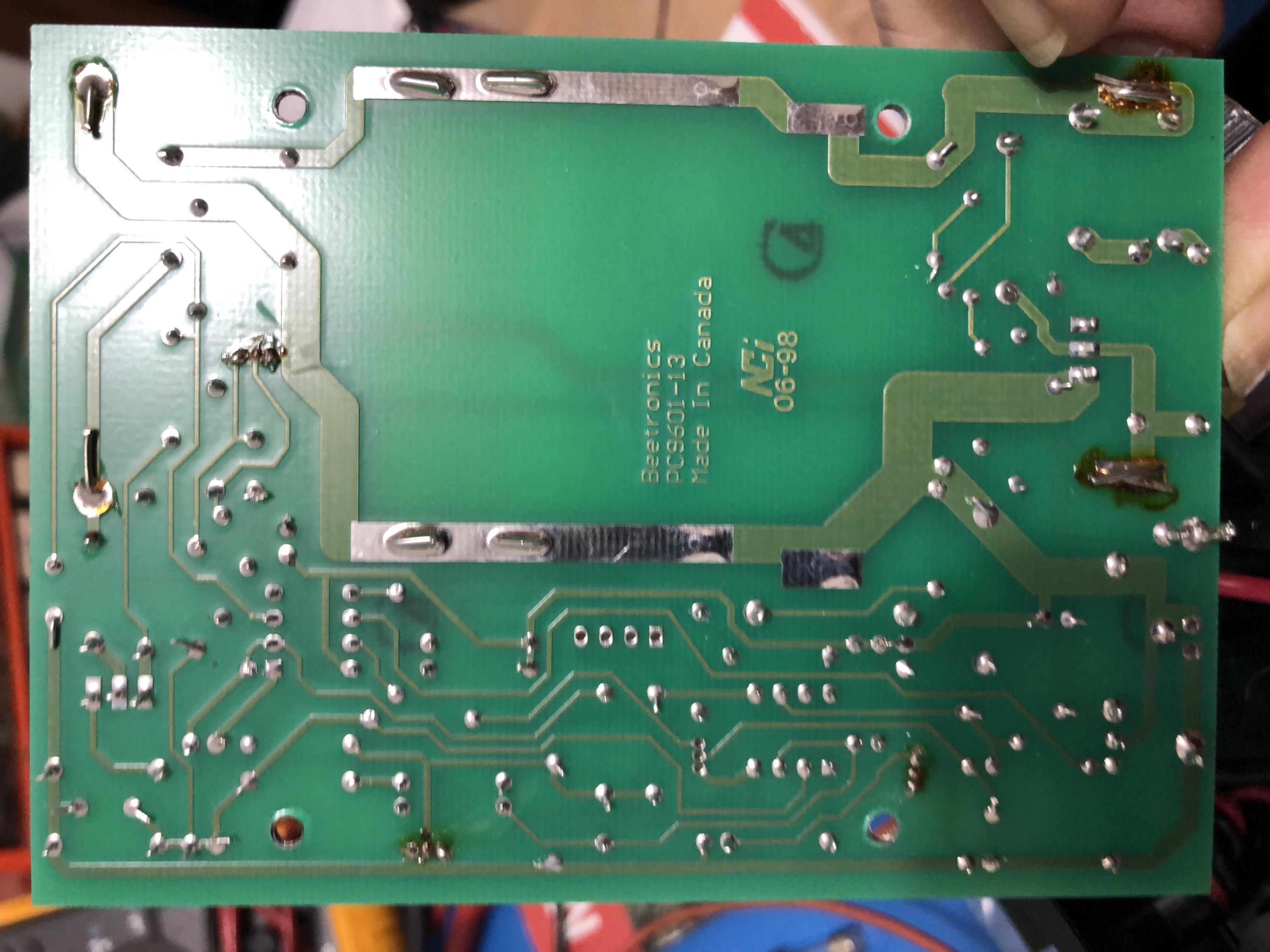

              Re: Beetronics electric fencer schematic
              I have attached some pictures of the PCB.
              Of note I have repaired the unit and returned it to the owner.
                so what was it?
                first thing i noticed are the 6A diodes too close to the board - obviously well over-rated as no signs of heat,
                and the associated dark brown resistors - an obsolete type known for drifting and absorbing moisture
                  well, there were three to-92s that seem to have been reworked...
                  hmm... interesting design.
                  anyway good job, didn't need a schematic after all!
                    It was a high resistance connection on the 12 volt battery terminal connection. Mechanically it was sound! An easy fix but I am disappointed in one way. I would have been interested to find out exactly how this particular system delivers 8,000 volts as it was different from the last electric fencer I worked on.
                    Cheers everyone for weighing in.
