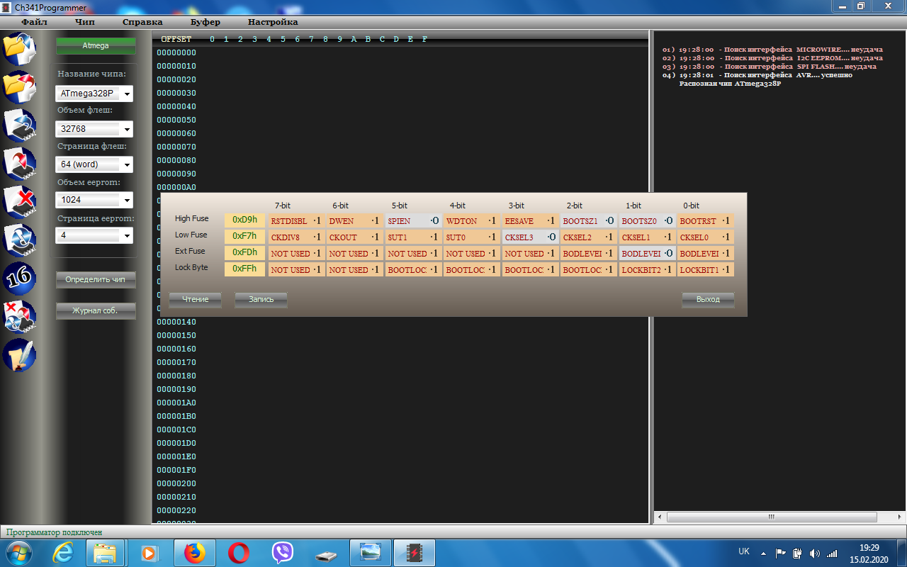

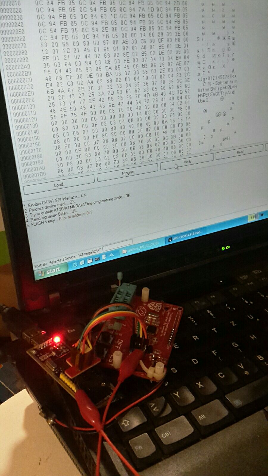

    Your fuse map should be this according to the Fish-8840.zip file attached by stj if you are trying to load the "original" firmware:
    Extended: 0xFF (Or 0x07 it depends on the program version how it reads the map, everything should be disabled)
    High: 0xD9
    Low: 0xE2
    If you look in your picture the "high" fuse map is already 0xD9 and extended map is 0x07
    So you only need to change the "low" map by deselecting "CKDIV8"
    Verify that this changes the low fuse map value at the top from 0x62 to 0xE2
    If it does you can program the fuse map.

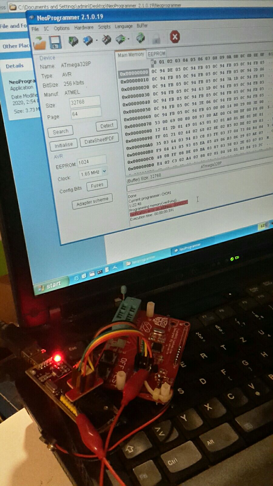

      I set that low fuse to E2, and connect display and test.
      With avrch341a I can not verify flash, say some error... next I get Neo, but he even not try to program, only noted verification problem on 0x2, some time later 0x6, 0x14, 0x5... random.
      With neo even when blank erase the chip it want to program it... verification error... say... wtf?
      With avrch341a I can program it, without error and without verification passed, but LCR is not work properly, print splash logo with some offset and stuck with some big character who is separate with space...
      I try to many time, but not go anywhere...
      My first avr... oh...
      BTW, on avrch341a read fuse 0x07 0xD9 0xE2
      but with neo read 0xFF 0xD9 0xE2... unreliable or what?

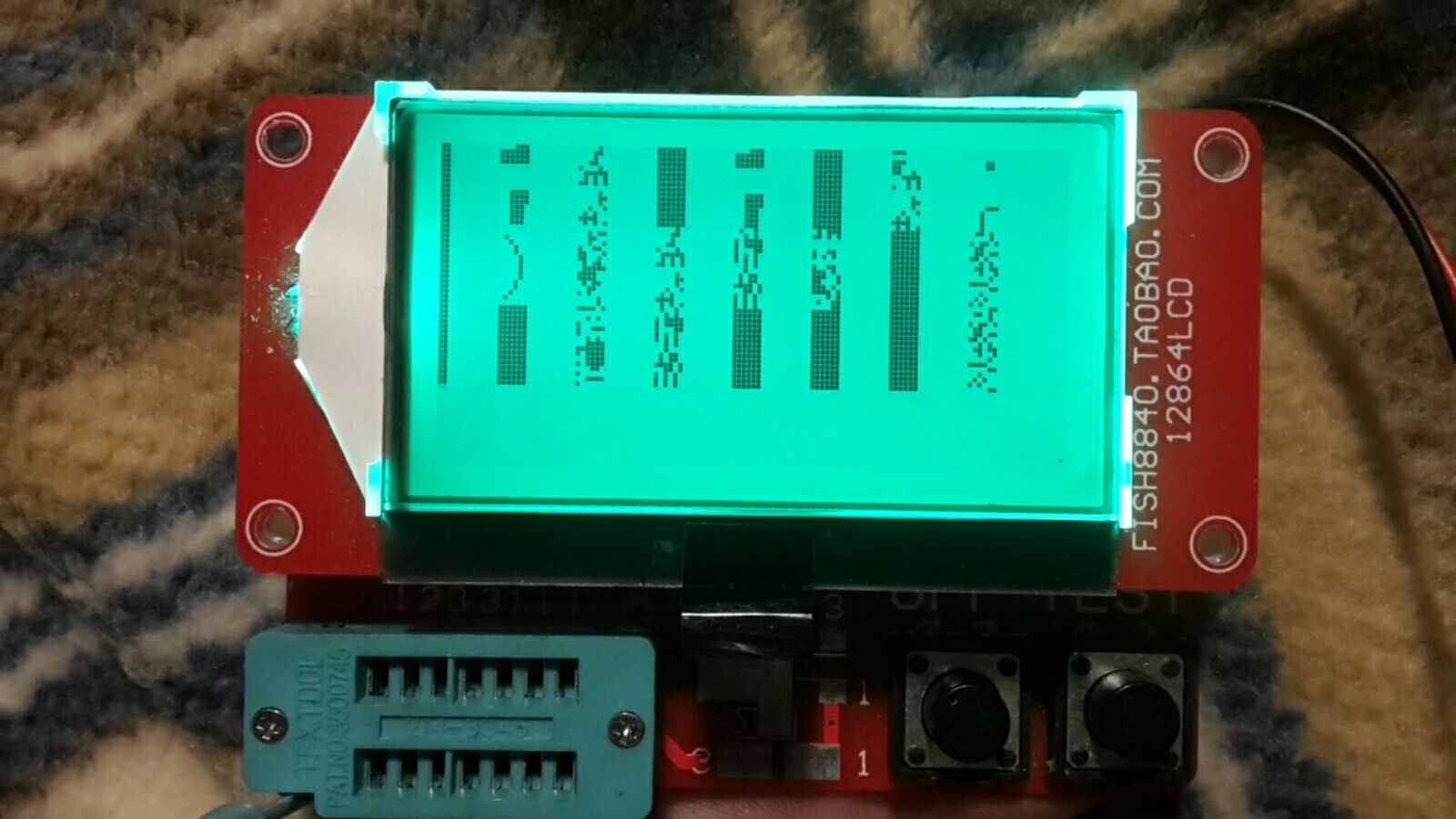

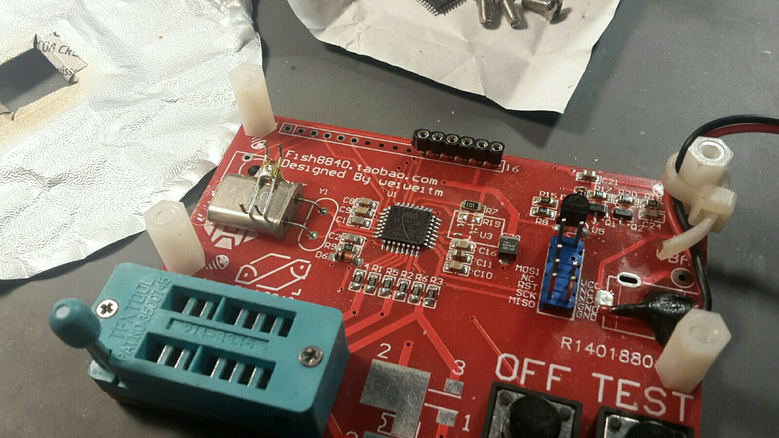

        Every time I had to program avr with original firmware, the returned readed hex is simmilar but not the same. The crc32 are completly different, every time randomly, with random verify error.
        Last time, I got dots on screen... before it was some big letters...
        I was measure voltage when reading, programming, but it not fluctate so much, 3.292 - 3.294... the ams1117-3.3 is capable of about 1A.
        I double check every wire, connection, soldering, everything is nice and ok. On pin #5 is some dust, not connection no worry, no shorts or low resistance between pins.
        What can cause that behaveous, its partialy work, I mean he programs something simmilar, and that is readable again... is this seen before!?
        I am greatly conserned about Neo, he even not try to program... must be a some major mistake?

          If you are powering the device via the programming header try to disconnect the VCC cable (but leave ground connected!)
          Then power the device via the normal battery.
          I do it like this when I program mine: I do have to hold the "test" button pressed to keep it powered and in reset this way, it is worth a try.
          Because 3.3v is the wrong voltage, the Atmega is a 5v device...

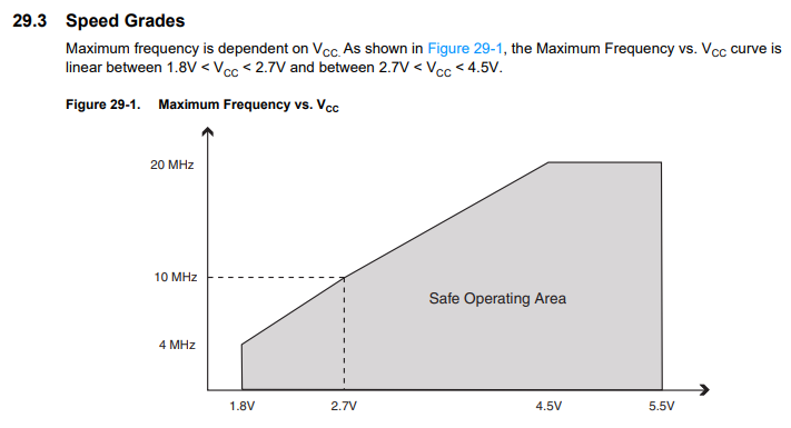

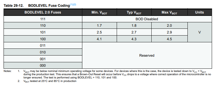

              Sorry I remembered wrong, the Atmega328 requires VCC to be 5v if you run it at 16Mhz. (I run mine at 16Mhz and 20Mhz).
              At 8Mhz VCC can be down to 2.7v:
              I'll try to explain the difference in extended fuse map value 0xFF vs 0x07.
              Valid fuse maps are 3 bits long as shown in the picture below.
              The value FF in hexadecimal is 11111111 in binary.
              The value 07 in hexadecimal is 111 in binary.
              So they will be interpreted by the chip the same way, it just depends on the program you use...
              But the reason the programming fails could still be the BODLEVEL being enabled if you program at 3.3v.
              So try it at 5v and see if it will work...

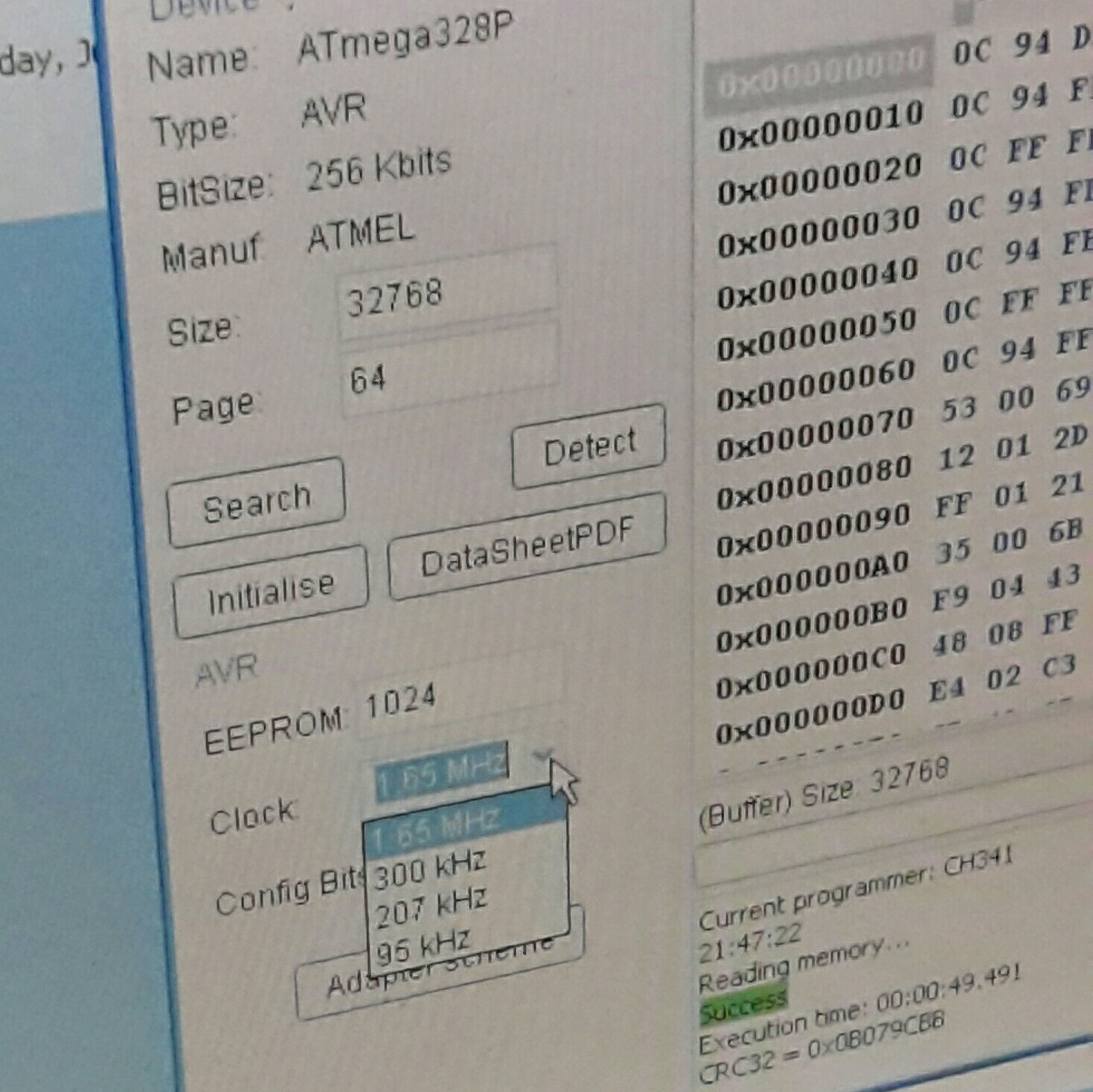

                    What does the "Clock" thing do in NeoProgrammer? Your chip runs at 8MHz.

                      Clock thing?
                      I dont know... I only have to choose from 4 listed frequency, I cant add 8MHz... what is that clock means, why is in kHz etc, I dont know...
                          Does he? How I can measure that to be shure?
                          Thank you lotas, but I think that the problem is not in software.
                          I download it and I try later. It is usefull to have different software for same hardware!
                          I have multimeter with "Hz mode" but cant got any reading on crystal legs. How supose this oscilator works, all the time is on or must bi initialized by program? I have measure between gnd and xtal pin #1 or gnd and pin #2... nothing there...? 50Hz humm...
                          But how it is possible to program anything to it, if its not running?
                          If clock signal from proggramer is enough to store data why is saved program always different... oh...
                          Please, confirm me how to proper measure frequency, till now I think that this xtal is undestroyedable in any way

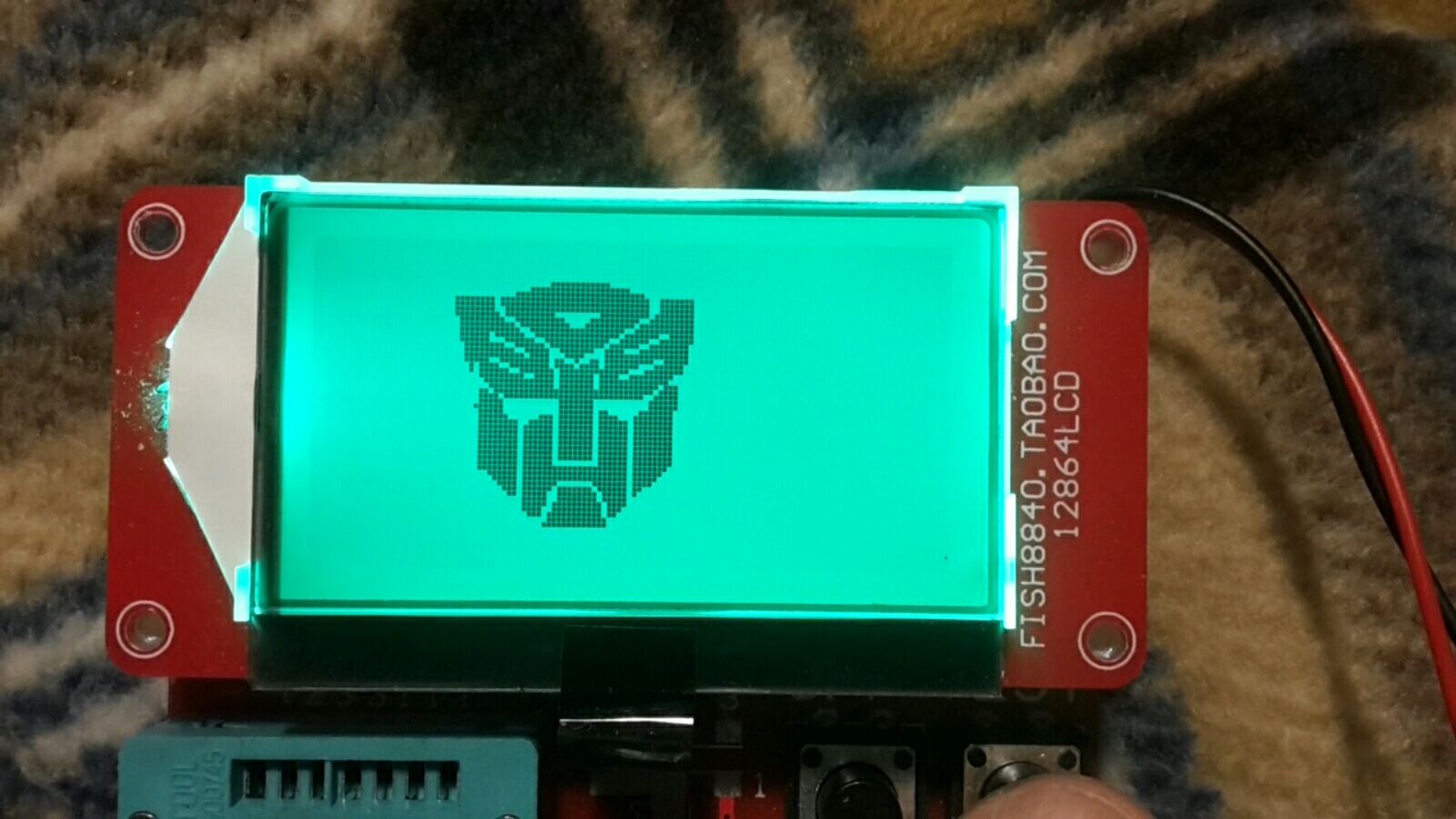

                            LOL, it work
                            After 3 weak of torture little chip, hopeing and 100000 plug'n'pray... it friking work on russian way! Awesome
                            Thank you again lotas for suggestion, and author of siberiaprog... it work!
                            I am replacing the crystal, but didnt help - after "erase" the chip with neo, readed data have almost 5% FE content over FF...
                            It was silence, 3am, my laptop is on, and I with smileish on face thinking... what about just try that russian thing... they are fameous in world like they think and made crude, robust, rigid, reliable (with some punch of hammer) things... and supprise... LOL
                            I finaly can write and verify passed with no error!
                            I rewrite eeprom and check the fuse...
                            Also, the install of siberiaprog is proper fancy... with music, idilical picture, a bunch of nothing understanding (russian) text... just cliking right arrow... simple as that
                            The avrdudess I cant tested yet, it missing some big component, like .net framework... but maybe it will work too... I am be glad if future experience of other ch341a user will be documented here, if it work, also if it not work, or howto overcome device to work.
                            Ok, I hope that from my point of view, total beginer in avr, this content will provide some help, hint or guideline to other with no experiance, thank you all for help!
