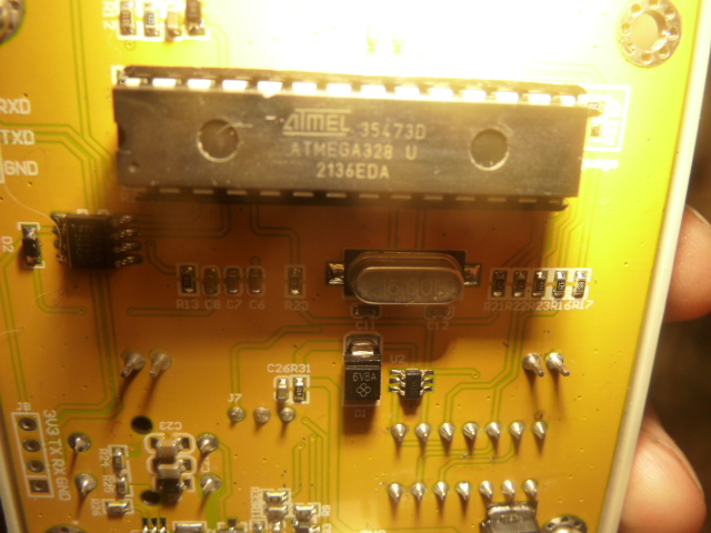

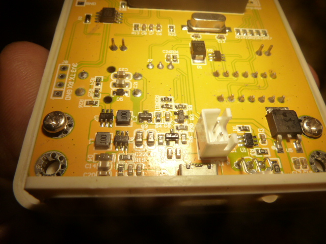

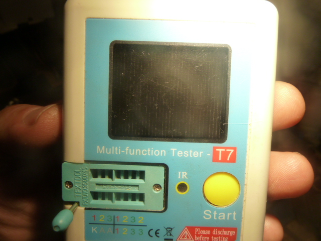

    Hi all.
    Several months ago, whilst testing a box of old used caps which I had 'assumed' were discharged, the T7 LCR tester I was using was damaged.
    When the button was pressed, the display would briefly light up and then go dead.
    So, I stuck the T7 in the freezer for ten minutes and 'Bingo!' it came back to life.
    Only thing was that after it 'defrosted' at room temperature, the problem returned.
    After freeze spraying components one at a time, I managed to pin the problem down to a SOT-8 chip. An STC 15L104W. Which until now, I had just been spraying each time I used the device.
    Anyway, I decided to buy a new chip, to fix the problem, however this only makes the problem worse. The device screen merely flashes briefly and that is that!
    Replacing the original, bad chip, just takes me back to square one.
    My question is, "do these STC 15L104W's need to be programmed or flashed?"
    Adding some photos to help see what is inside the tester.
    Any suggestions will be greatly appreciated

      • 31086
      Re: LCR T7 tester problem

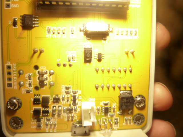

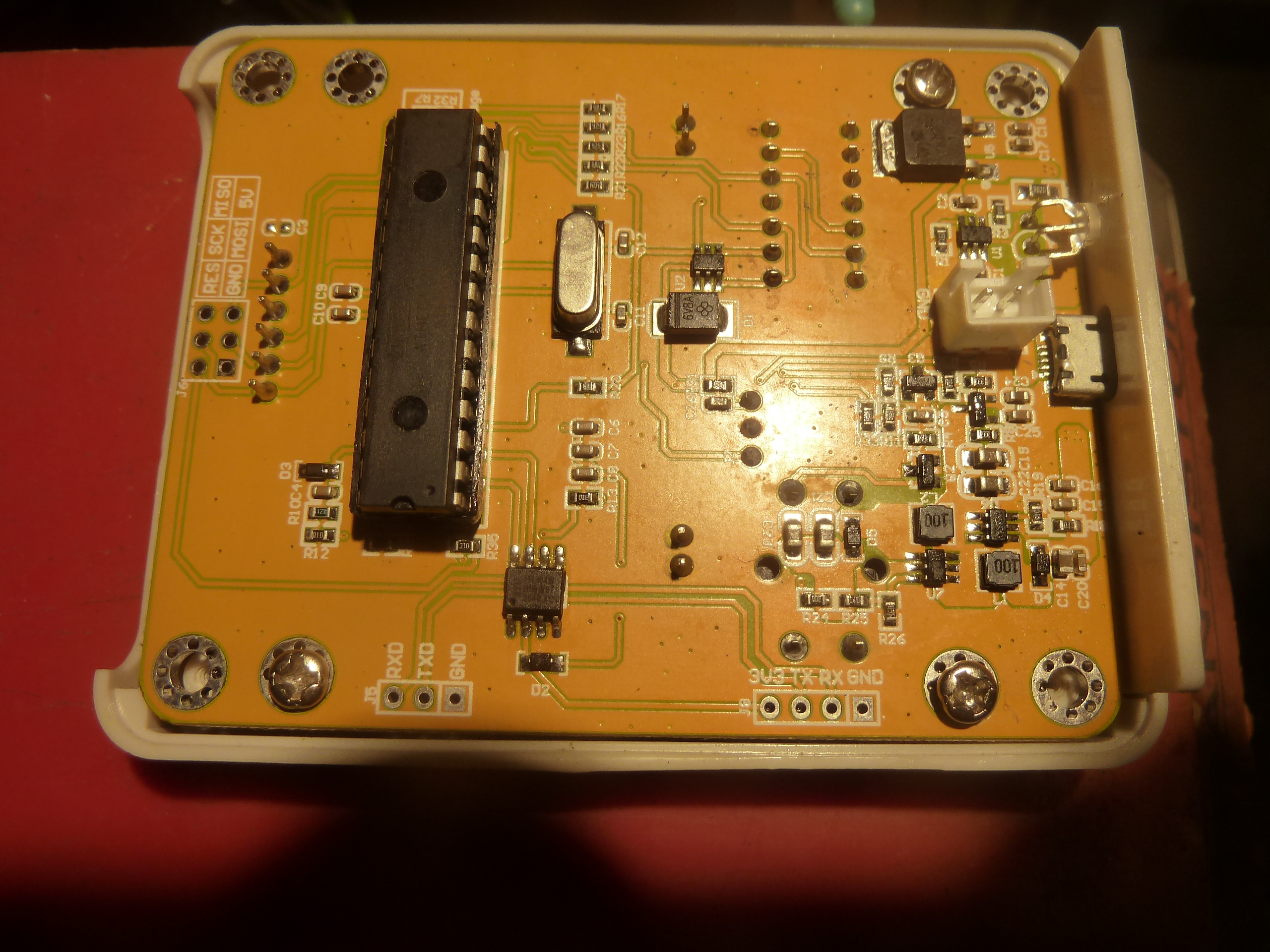

      hmm - looking at your pictures they changed the board.
      you cant upgrade to a 644 or 1284
      you can still do the crystal upgrade though.
      is it still a colour display or did they fuck that too?

                • Crystaleyes
                  • Sep 2021
                  • 493
                  • Brazil

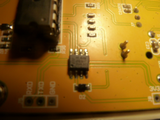

                  Hang on...
                  I might have been talking shit...
                  ..Right next to the STC 15L is a small diode, D2. With 'S4' written on it. TBH I hadn't paid that any attention seeing as when I freeze sprayed the chip the device worked.
                  That said, I just did a few runs spraying 'only' the diode...
                  ... And that made it work!
                  (where is the Face-Palm smiley?)
                  Let me rewind and focus on the diode before I think about flashing firmware and inserting circuitry

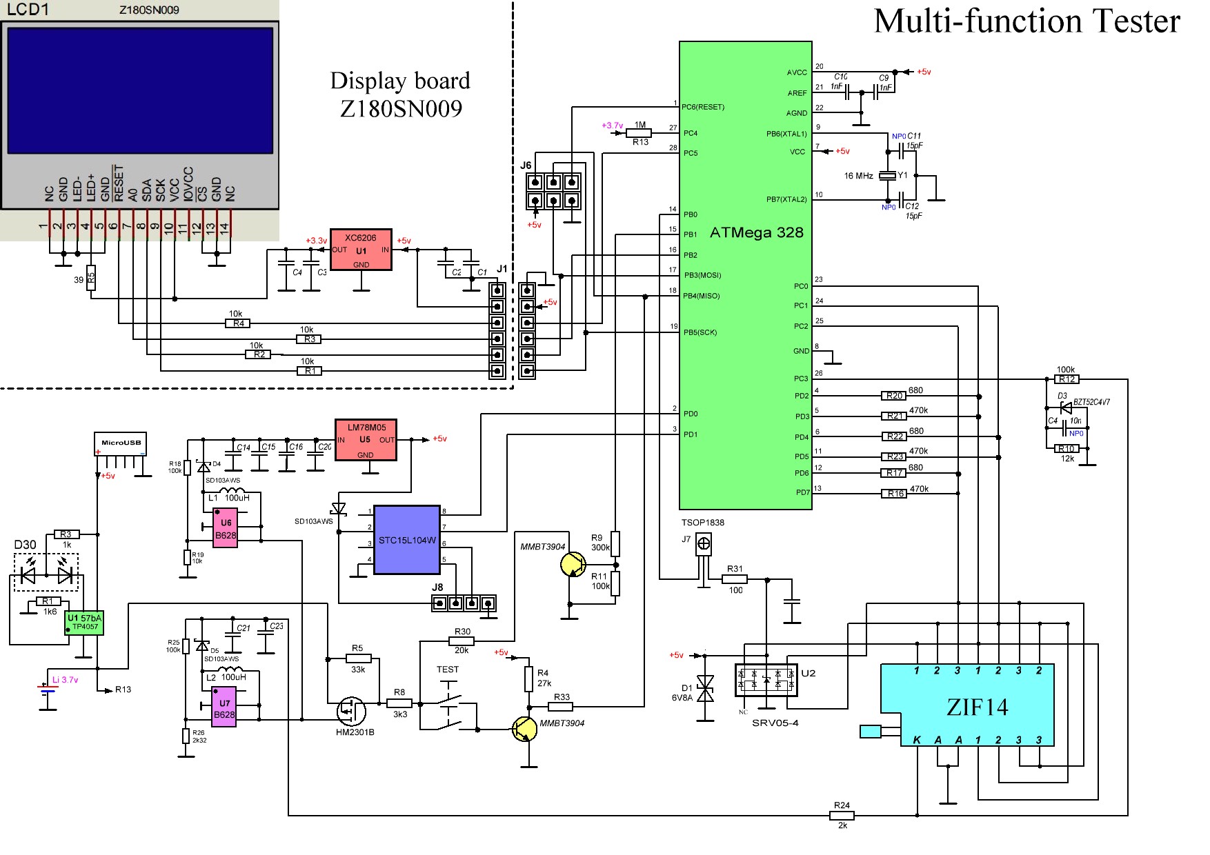

                    • 31086
                    that link should have the T1 schematics - it's very similar
                      • 31086
                      here
                        Schematic diagram
                          Excellent.
                          Very similar indeed.
                          My concern is that the schematic is for the design which has the transformer whereas my tester is the cheapo version with no trafo.
                          In the schematic, D2 is an SS18 whereas my suspect D2 is an S4 (which I believe equates to an SD103 amongst others, inc. the SS54? and 1N5819 in through hole form).
                          I'll grab a diode tomorrow from the shops and confirm one way or the other
                            • 31086
                            the diodes are just 1amp schottky,
                            the circuits are similar but yours uses inductors to boost the voltages instead of the transformer - a better way of doing it i think.

                              Right..
                              Even though the D2 diode tested fine after pulling it, I installed a 1N5819 1A Schottky to see if that made any difference, but it didn't.
                              I also pulled the Atmega238 and froze that separately, but that too made no difference.
                              Then I carefully froze the STC15L, being sure to avoid all other components, and the tester worked again.
                              So, the issue 100% lies with the STC15L104W.
                              Any suggestions as to how to resolve this?
                              Or just keep it for spares?

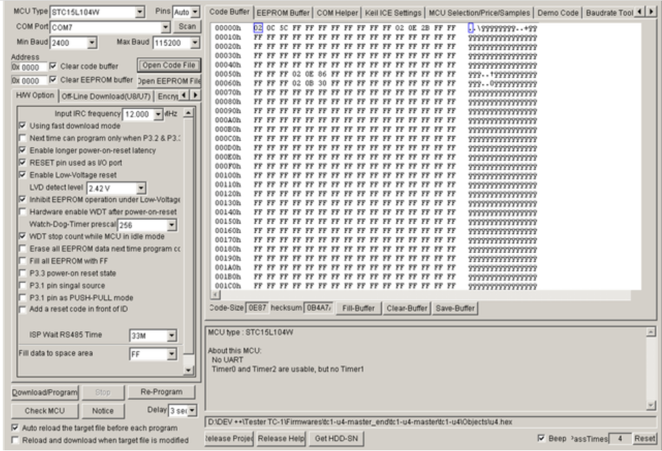

                                  1. Getting ready to flash the U4 power controller. We solder the USB-UART converter with a stabilizer to the board.
                                  (3.3V to 3.3V, Gnd to Gnd, Tx to P1, Rx to P2).
                                  2. We connect the converter, wait for it to be detected by the system, launch the software, select the com-port, select the firmware from the archive (p. 1), set the frequency to 12 MHz, apply power, the processor starts, does not go into boot mode, is not detected by the programmer .
                                  3. Experimenting with the sequence of power supply to the processor and pressing the "Check MCU" & "Download/Program" buttons.
                                  4. We study the datasheet on U4, we find that the Test button of the tester is connected to the Reset output. Click "Check MCU", click the Test button, the microcontroller resets and is detected. In the same way, we launch the firmware, and finally, we flash U4.
                                    • 31086
                                    yes, but we are flashing firmware for the new atmel code,
                                    i dont think it works with the original chinese code - not on T1 anyway.
